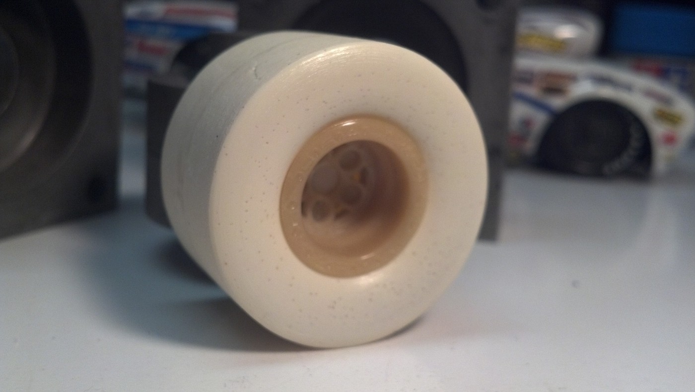

Here is what I am currently doing. A two part polyurethane mold that was machined to achieve the right look for a racing slick with proper sidewall appearrance. It has a center buck to create a hollow tire. It is designed to be used with any of the flexible rubber resins so that when the cast is cured and you pull the mold apart you can stretch the tire away from the center part of the mold. Haven't quite got that part of the process to work out consistently yet. Still trying different compounds so that if/when I get a good casting the hollow tire won't collapse under the weight of the model.
Until then I can still use the mold to pour traditional resins. The only catch is that when the casting is cured I have to cut the cast down the middle to get the center part of the mold out of the casting. Then glue the two halves back together and sand/smooth and paint. I am still playing with this process and trying to get a better handle on it. And this is merely a rather simple racing slick, with minimal detail. I can only imagine what a treaded tire would require for work.
