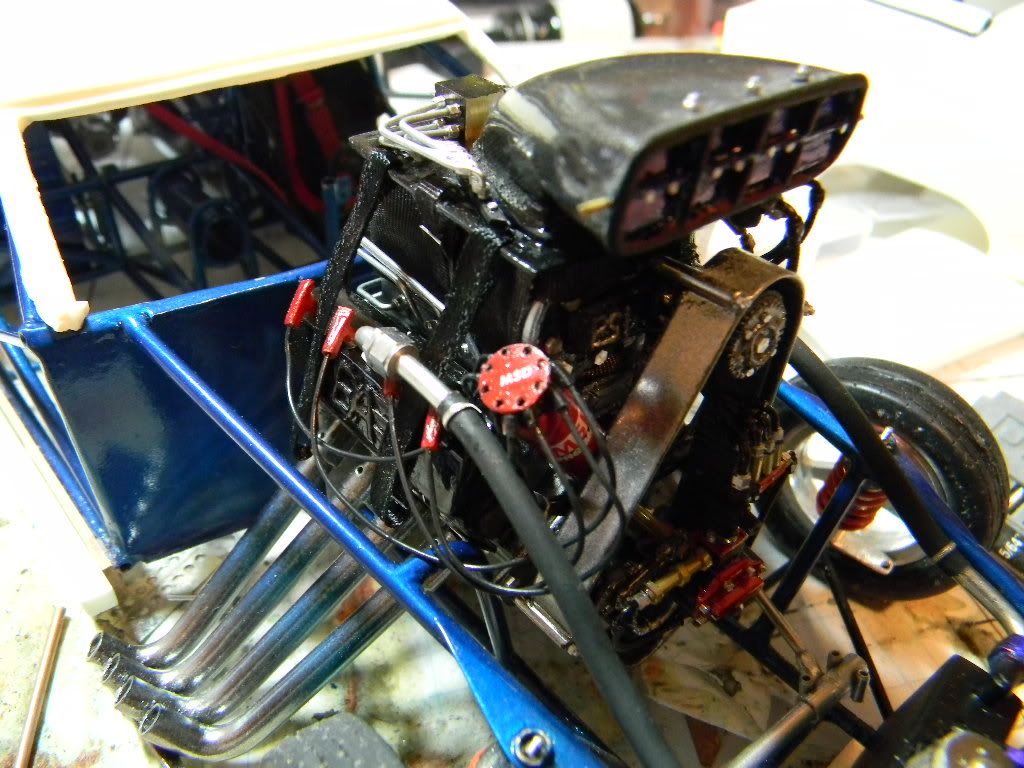

I did Metalizer Burnt Exaust over aluminum.. though i don't remember if it was Alclad or Metallizer Aluminum.
I just used something sharp to 'scratch' the weld joints, for an acceptable look without too much difficulty.
My pipes are a 'bit different then most make them though. I use soldered brass rod rather then plastic or lead solder as the basis. I anneal the brass with a propane torch beforehand to make it easier to bend.
I don't do the cool blue petina on the pipes.. because dirt car headers are usually caked with mud and dust, and look old and rusty, rather then the nice bluish pipes on the pavement cars.

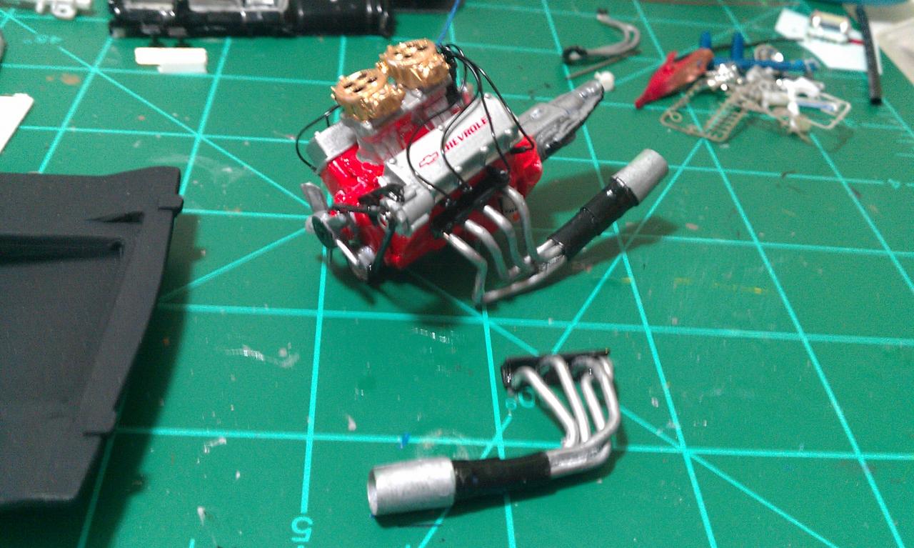

here is a set that I make out of Solder,heat shrink and a Straw End!! I also put a strip of plastic  with holes drilled for the pipes to fit in, this makes it easier to secure too side of block,

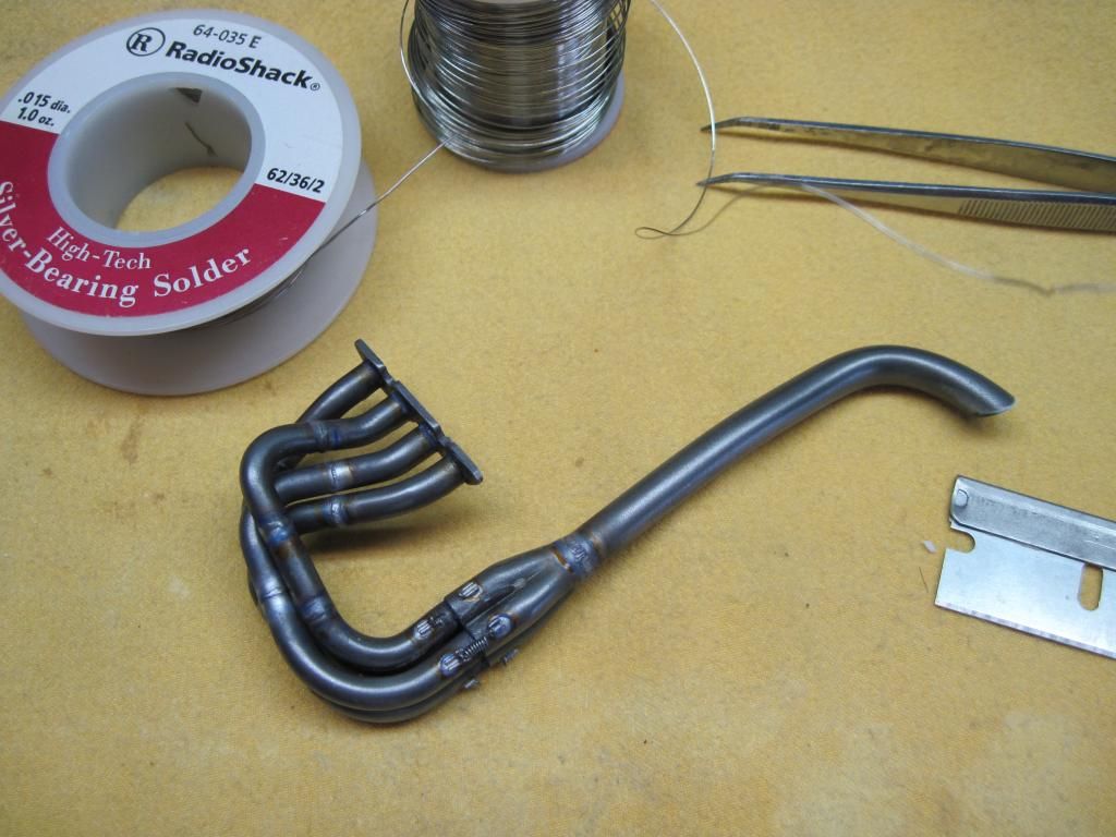

Various shades of Metalizer paints airbrushed on and a wash of artists' acrylic burnt sienna, ultramarine blue and Tamiya acrylic clear orange to replicate the heat discoloration around the welds.
This is in a slightly larger scale (1/10th) but you can still use the same technique.
