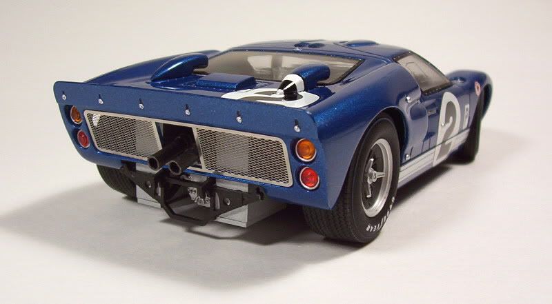

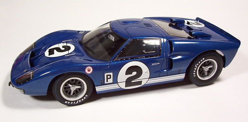

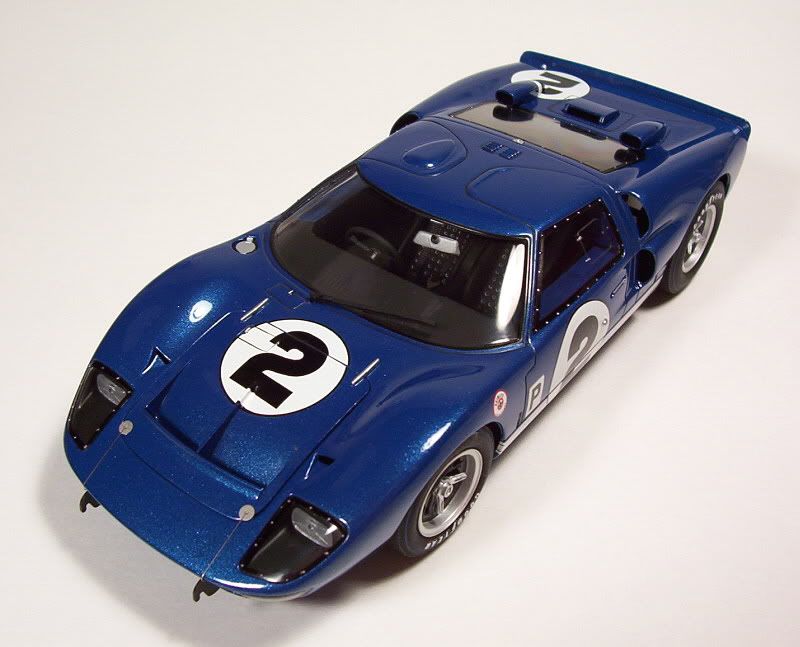

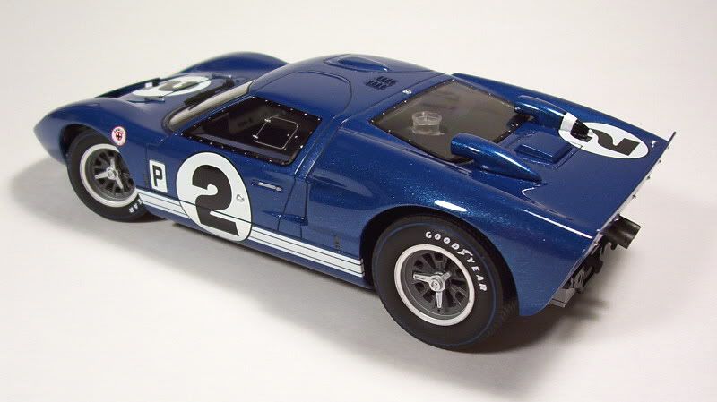

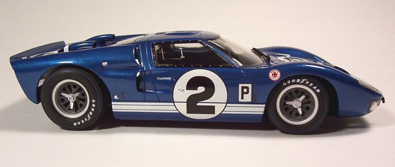

Just finished this up tonight. It's the Revell/Fujimi GT40 from Sebring 1966. Built OOB. Painted with 4 light coats of Tamiya TS-15 Blue then 1 light coat of Tamiya TS-19 Metallic blue topped off with 2 coats of tamiya Clear then rubbed out with Tamiya compound and wax. I like the effect of the metallic blue over blue. It keeps the color nice and dark and give just enough metallic with going over-board. I'm sure it's not the exact color of blue as it should be but it's close enough for the shelf. The wheels were painted with Testors Magnesium metallizer and cleared with testors dullcoat. The blue stripe on the tires was hand painted with Tamiya flat blue acrylic.

Very cool build! Believe it or not, my favorite part is the screen area in the back. Did that come in the kit, or was that something you made yourself?
Either way, awesome!

Billy, the PE grill came with the kit, it also include the hood pins and seatbelt buckles. I made the seatbelts themselves out of medical tape colored with a sharpie.

I thought about covering my headlights to make it just like the picture and may still do it someday. There are also a few other things that really need to be done to make the car accurate, like the second light at the top of the side number on the door should be added, etc... My Autolite sparkplugs decals are in the wrong place... :oops: LOL.

i do have a question: that number roundel on the back that goes over the scoop on the right side of the body...is that a separate decal to go over the scoop or did you somehow stretch the decal to fit? looks very cool like that. i have a couple of this model but dont remember examining the decal sheet too closely

the kit comes with a separate decal that lays over the rear intake but I chose not to use it. I painted that part on. I figured it would be easier to do it that way than it would be to convince that decal to lay down flat.

John, I used the kit decals except for the small one that covers that rear intake. I had very little problem with the decals. A little micro-sol and they laid down pretty well. I had to cut them to lay down over the lights in the door and then touched them up with Tamiya white acrylic paint.

Thanks for the quick response. Nice to know that the decals are opaque enough to cover well. How do you black out the the panel lines? They look very realistic.
