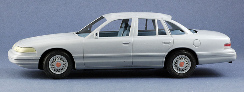

This one is from a Motherly request to build my Dad's car for her to display to all her friends at the Assisted Living shop. This was the first year of the venerable Cop Car you've all learned to instantly recognize in your rear view mirrors! This design was quickly adjusted the following year after all the complaints that the front grill area looked like a Taurus. I'm using one of the Lindberg 97 Crown Victoria kits for this build and will be backdating it to a 92. The front and read clips need most of the work and this should be a good build showing how I backdate these areas. First a couple photos of the real car...

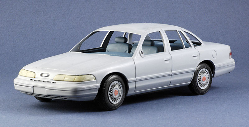

Here are some pics of the 97 model body after only some minor seam sanding for visual comparison.

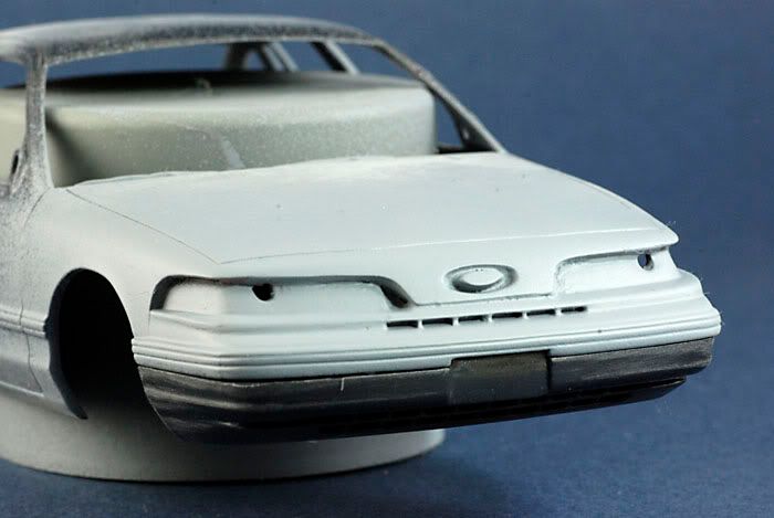

The changes made to the 97 model year are still very simple and the only body mods I need to make are in the front grill and rear tail light areas. I'll explain these changes as I go.
The 92 Crown Vic's Taurus-like sheet metal between the headlights look was changed to a real grill. The kit's 97 grill-headlight still had the headlight shape and this line was scored with the back of a #11 blade until they detached. I was planning to just fill and molt the grill to the body, but the the slight recess for the Ford logo in the center gave me thought. I figured I would have to create the shape around the logo with possibly a deformed round plastic tube or some sheet plastic. In another post where I was searching for a source for the "wire" looking wheels on my Dad's car, torinobradley gave me the lead on the AMT Taurus kit. The wheels look perfect and I'm now figuring cutting out the front logo from that and patching into the Crown Vic will easily solve the problem. Still waiting for the Taurus kit to arrive so time will tell.

The Taurus arrived this afternoon. The wheels look really good ... very close. They need to be stripped for some natural aluminum, so gonna fill the SHO logo on them and make some blue oval decals. The Taurus front oval looks good too. Probably cut it off the Taurus tonight and weld to the Vic front. I'm a happy camper! :lol:

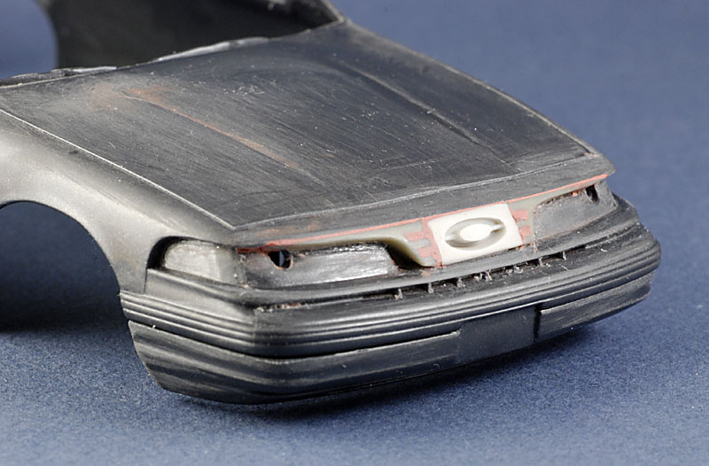

The ford Taurus donated not only it's wheels but the front logo was torched off the front and welded into the Vic's front grill. This is just after the first coat of putty and sanding.

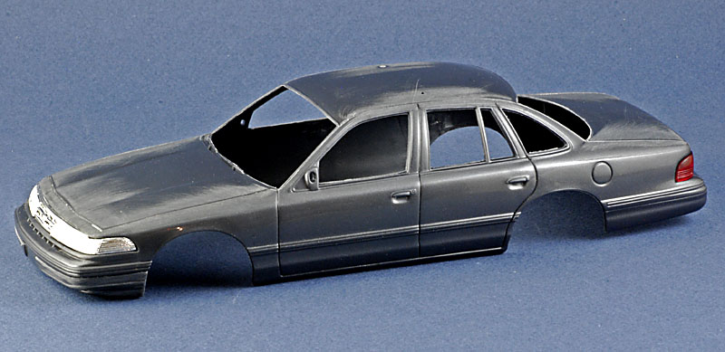

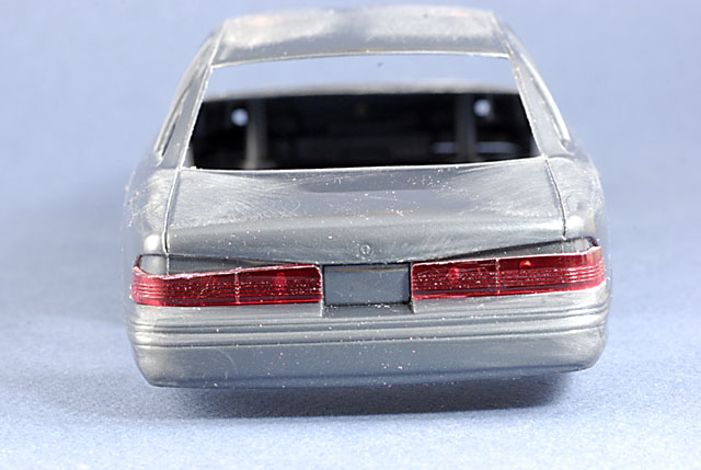

First, the bad news. I had to trim the top of the tail lights to make them uniform in height for this conversion. The right one came out great and the left one had a "slip of the measurement" and is unusable. So I needed another kit to redo it.
Posted Image
Picked up another Crown Vic at the NotSoLocalHobbyShop today. I got a different State Police version just for some different light bar .. they had 3 versions on hand. That was good! When I opened it, I found the rear tail lights were molded in clear with the top covered in a transparent red. When did Ford start making tail lights different colors in the same year!!!!??? Must be differences in client demands. So now, I have a red molded and partially clear molded ones. Looks like I have to cut TWO more tail lights now as the ones from different kits will not match. :(

That taillight is weird. All Aero CVs (92-97) had solid red taillights. Maybe you can strip the red off of the new one, and repaint them with stoplight red.
Yeah, I figure that's the plan as you say. Time to drop a clear sprue in the purple pond to see how it reacts. :D

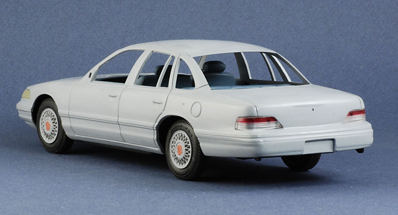

After all the pauses, this weekend is seeing some production! Tried a few methods to frame the tail lights in the rear and in the end just used some .01 strip to crudely form the openings. Was touch and go using micro dabs of CA and kicker as I worked it around the compound curves. I'm happy with the results and now for some putty!! Just need to cut the license plate opening in the rear bumper. :D
Posted Image
Tail lights in place ... still tape cover for protection
Posted Image

The boring NINETY-TWO Crown Vic is in primer! ;) Did first mock up to check stance. Still some putty on the SHO wheel scripts.
The clear red on the tail lights is proving to be reluctant to come off. They've been in the purple pond for 4 days and not a hint of removal. May have to sand and refinish before making them all red. I'd just do the clear in red but doubt the reds will match.
Overall I'm happy with this conversion. There's still some icky masking on the body to do after the main coat of paint, but it looks right in my eyes. :blink:
