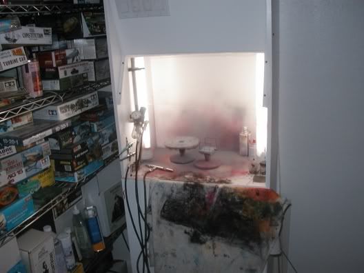

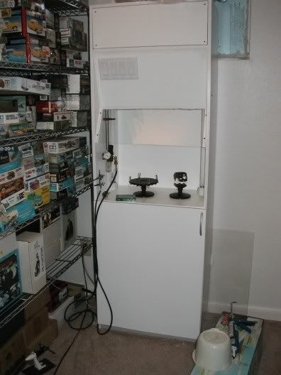

Posted 04 June 2009 - 01:21 PM
FIRST OF ALL...let me apologize for the corny shakespearean topic....now onto my question. I have been looking at the spray booths that are available on the market. Besides the electrical things, it seems like it'd be easy to build? Are they worth the money?
I built mine, and people have said it was a real professional looking rig. Works well, looks good, pretty much everything I wanted from a booth.
Was it worth it, yes for a great number of reasons.
