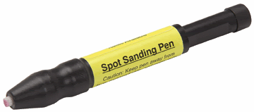

doing clean up of the glue spots with the Nic Sander, (a similar & apparently easier to find product is the Prep Pen sanding pen).
Here's a link to Harbor Freight's page for the Prep Pen:
http://www.harborfre...temnumber=97292
Here's a pic of the Prep Pen. I'm still looking for a pic of the Nic Sander. It looks a bit different, but they both work identically.
Posted Image
I don't know if the Prep Pen has replacable tips like the Nic Sander does, but either one works wonders.
This was very interesting to me. I can think of countless times I wanted a small round "sandpaper on a stick"! ehhe
So the common name is GLASS FIBRE PEN and these are a few links I came on .. used in many industries it seems.
Glass Fiber Pen 1
Glass Fiber Pen 2
Glass Fiber Pen 3
Seems that are all in the UK though. I get the feeling they are probably not sold in the US because of the tiny fibers they leave and our slap-happy lawyers.
