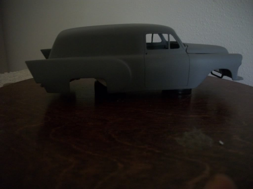

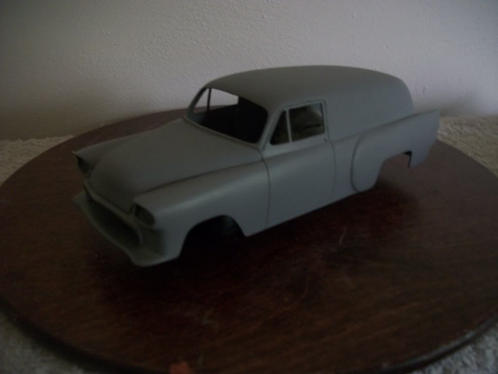

Snowball 2 has landed made it safely to Missouri! I have decided to tackle the engine for our project, i 'm thinking a 69 corvette 427 or maybe a 454. Would anyone object to using blue as the engine accent color?
Heres Snowball as I received it.
Posted Image
Posted Image
(sorry for the dark pics my camera was having trouble adjusting to the light for some reason)

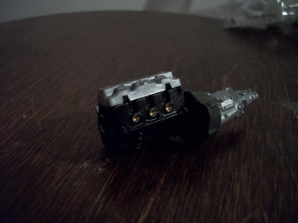

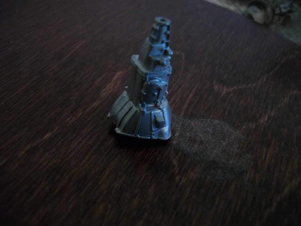

Posted 13 June 2012 - 05:48 PM
It took a little longer than I expected but heres an update,
  • Block is painted dupli color black
  • Freeze plugs painted with Testors Gold
  • Transmission painted with rustoleum silver and titanium metalizer with Testors dullcote
  • intake painted with Spaz Stix chrome over flat black to resemble polished aluminum
  • heads drilled for plug wires and painted with color place silver
  • blower mocked up
Posted Image
Posted Image
Posted Image
Posted Image
Next up is getting the blower painted and mounted and then lots of wiring!

Is that a blower manifold? Looks like you are gonna plop that blower right down on the stock manifold.

It's not a blower manifold yet, But after some modifying it will be. :D I'm going to scratchbuild a new center section on the stock manifold to accept the blower and leave the ports alone so they match up correctly with the heads. (It's actually a lot farther along now than it was when the pics were taken)

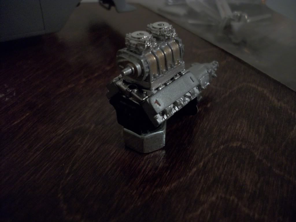

Posted 15 June 2012 - 05:32 PM
I modified the intake to mount the blower by filing off the carburetor mount section of the intake and adding a sheet of .040 sheet styrene that I cut to the shape of the bottom of the blower to the middle of the intake and then I added about 2mm of height by adding some square rod to the border of the blower mount plate o nhte intake.
Blower was painted with testors "chrome trim" silver and a custom mix of pale gold testors paints.
Posted Image
Posted Image

I just don't see that fitting under the hood (LOL)
