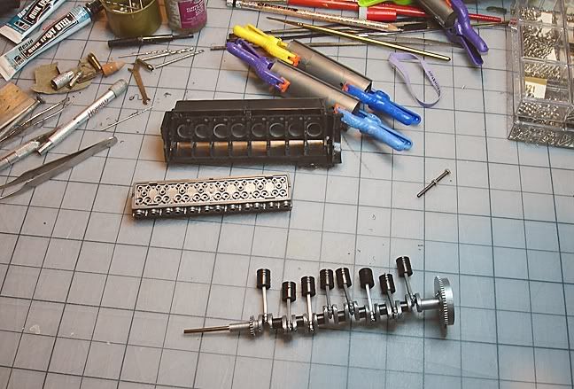

I always like to start with the engine. Here's a shot of a few engine components. Curiously, Pocher molded some of the crankshaft parts in silver, and some in black... and the pistons are also black. You'd think they would all have been molded in silver. But it doesn't matter, as none of these pieces will ever be seen again once the engine is finished. That being the case, I didn't bother painting any of these internal pieces.
Here's a shot of the basic block, the cylinder head and the assembled crankshaft/piston assembly.
As you can see, for some reason some of the parts are black, some silver... blink.gif

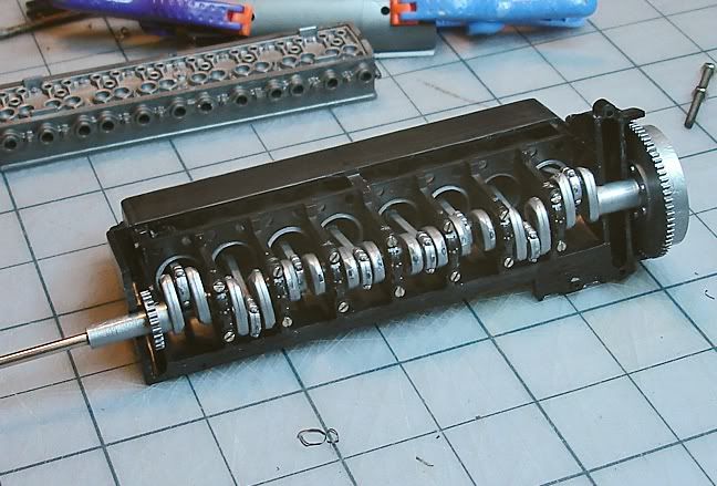

And here is the crank installed in the block:
BTW... just for reference, the lines on the cutting mat are spaced 1" apart.

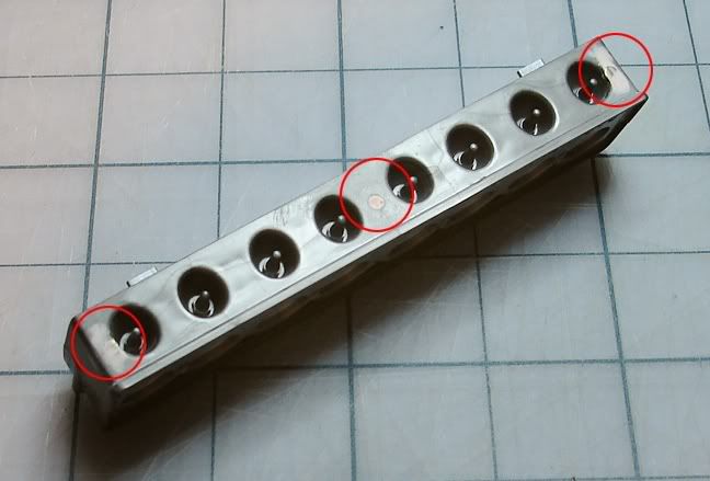

Speaking of hidden detail... the camshaft is made up of the drive gear, the shaft, and 16 separate cam lobes!
Posted Image
And here it is installed in the block:
Posted Image
There are holes in the block and cylinder head to accommodate the pushrods and valves, but there are no separate pushrods or valves in the kit. The pushrods and valve stems (no valve heads!) are molded to the rocker arms, and only extend down a little ways... the pushrods don't actually touch the cam lobes. That would be a little too much as far as moving parts at this scale! Rocker arms and valve springs... coming next time!

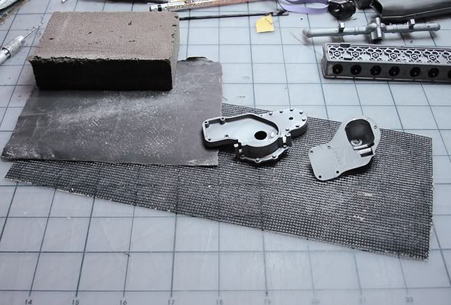

Parts fit of Pocher kits is iffy. In fact, a big chunk of building time is taken up by prepping each part. You have to make sure everything fits, which it sometimes doesn't. Minor sanding, trimming, and general finessing of most parts is required before they'll fit the way they're supposed to fit. For example, all mating surfaces have to be leveled and smoothed to make sure there will be a tight seam, like on these two timing case halves. A poor fit between two mating parts could throw off the fit of subsequent parts down the line. I like to use an open-mesh sanding sheet, laid flat on the work surface (these sheets are actually meant for sanding drywall joint compound)... I run the mating surfaces of the parts back and forth across the sheet until smooth, then finish up with 400 grit sandpaper. The sanding sponge, with different grits on each surface, is perfect for sanding rounded parts because it has just the right "give" to it when sanding those types of parts. Great for removing mold seams from exhaust pipes and things like that.

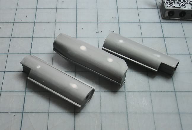

Minor blemishes like the sink marks on these mufflers are easily taken care of with Bondo two-part catalyzed glazing putty.

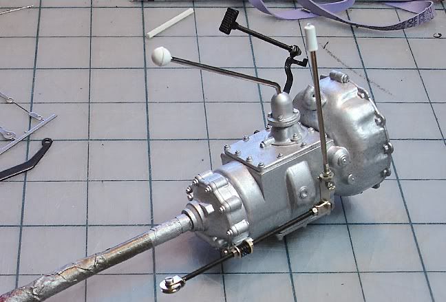

To speed things up a little and make my life easier, I like to first build subassemblies that will all be the same color, then paint them as a unit. Much faster and easier than trying to paint each separate part and then assemble them. Here the supercharger, carb and related tubes and pipes were built as a unit... same with the transmission... then they'll both be painted silver before the final detail parts like linkages and such are attached.
Posted Image
One of the pins on the transmission had broken off, so I drilled out a hole and replaced the missing pin with a short length of heavy copper wire (household electrical wiring).

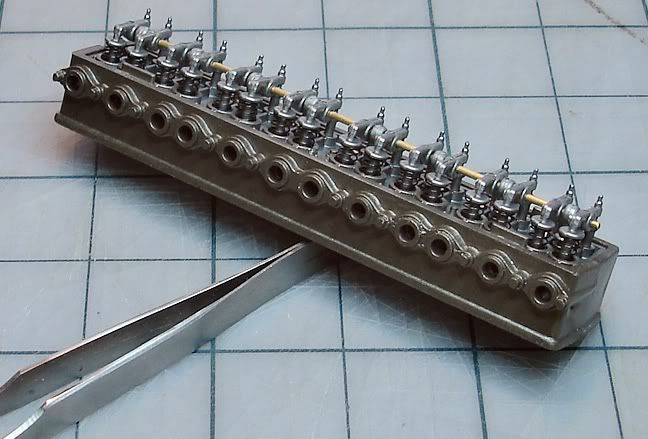

Here are the parts for the valvetrain... before...
Posted Image
...and after:
Posted Image
