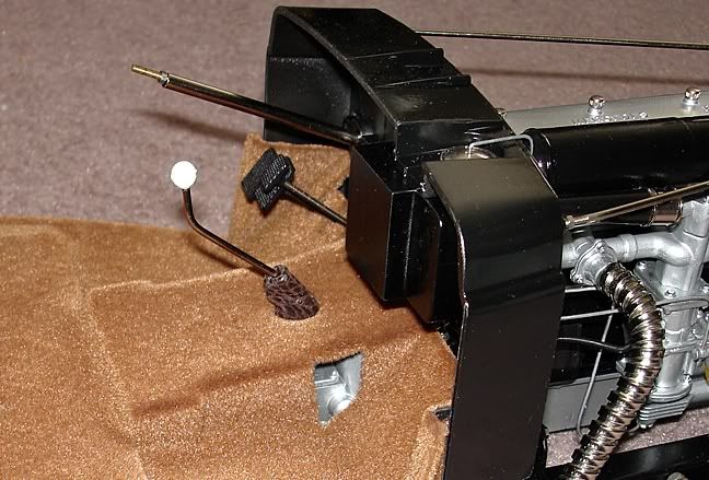

Scratchbuilt shifter boot... in matching leather, of course! :blink:
Posted Image

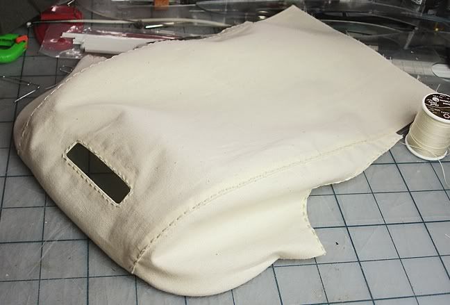

Ok... here's something I've never done before: build a cloth convertible top!
The kit supplies pre-cut cloth pieces for the top–a center section, two side pieces and a lining. The kit cloth is tan, I wanted a white top... so off to Hobby Lobby to get some off-white muslin. I used the kit cloth pieces as templates to cut my new top pieces. The borders of each piece were "hemmed" by folding them back 5mm and gluing the flaps down on the inside of the pieces. Then the three main top pieces were sewn together by hand! :lol:
And here I thought building a Pocher wheel was tedious! It took me a couple of hours to fold and glue all the "hems" and another several hours to do the sewing (since I don't know how to sew!!!).
I didn't use the kit rear window, it's way too thick... so I cut a piece of clear acetate for the window and sewed it in place into the opening I cut.
The reason I'm already working on the top this early in the game is because it attaches to the body from underneath, with screws, along the rear flange. You have to attach the top to the body before you mount the body to the chassis... and since I'm pretty much at the point where the body is going on the chassis, I had to build (and install) the top first.
Posted Image
One of the biggest problems with the top is that the center section has parallel sides, but in order for the top to look good and not have a bunch of slack and wrinkles in it, the center section has to taper in width as it goes towards the back. The width of the center section has to be about 40mm narrower at the rear than at the front. A lot of trial and error goes into fitting the top sections, and even now I'm not sure how tight the top will stretch over the three hoops that make up the framework of the top. I might have to make my own hoops out of brass strip, depending on how well (or how poorly) the top fits. We'll see...

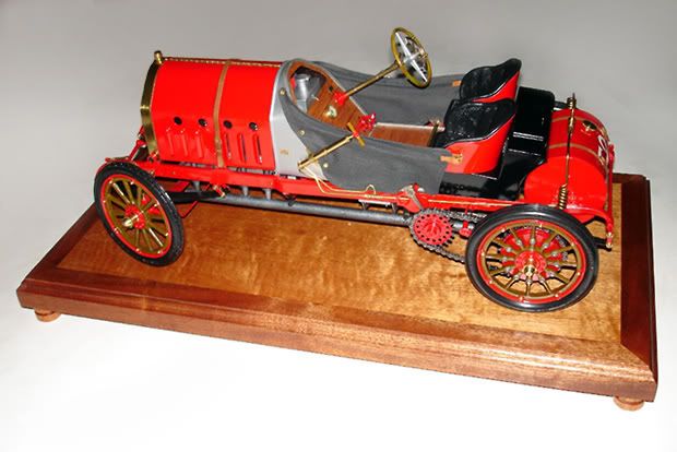

Also... if you seriously want to try building a Pocher, keep in mind that some kits are way harder to build than others. The easiest one (and usually the cheapest one on ebay) is the 1907 Fiat race car. No doors, no windows, no fenders, etc. Of course, you'd have to have an interest in that sort of car, but if you do, and you want to try a Pocher, that one is definitely the one to start with. I guarantee you, you'll love the experience... and when you're done you'll have a real showpiece.
