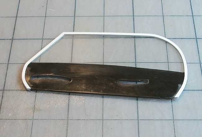

The window frames can't be fixed, because I need a mirror-image set (one left and one right), but all I have are two lefts. I can't just flip one over... then the window opening would be backwards! It's like a left-handed and a right-handed baseball mitt. You can't take a left-handed mitt and flip it over to make a right-handed mitt.
What I did was glue some Plastruct U-channel around the window edges to simulate the metal molding. I'll use BMF to "chrome" the moldings (God willing on the BMF part!) And hopefully the BMF won't get scraped off against the edges of the window opening as the window goes up and down in the door. If so I'll probably wind up just painting the moldings silver.

No problem though... the Plastruct U-channel I found fits the kit glass perfectly, like it was made for it.

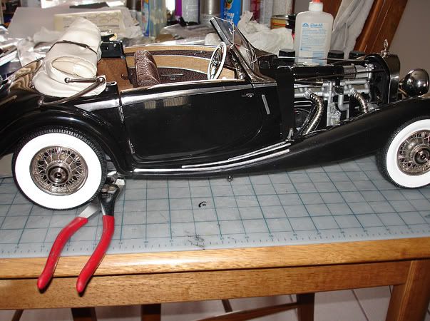

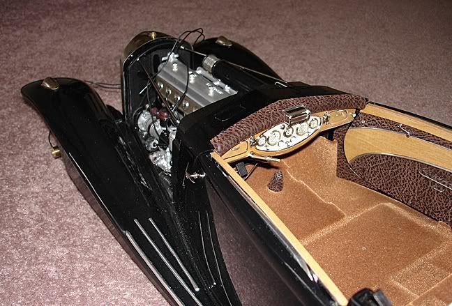

Sort of a "good news, bad news" day...
The good news is that the doors actually do fit fairly well... once I glued the hinges, the latches seem to pull everything into line when the doors are closed. Not perfect... not even close to perfect... but better than I initially thought it would be.
More good news... despite the tiny pieces and sloppy tolerances, the door latches do work–at least for now. I have no idea what their "life cycle" is, but I'm not about to try and find out. I will be using the door handles as little as possible.
The bad news is that there's a huge gap between the top of the door windows and the sides of the top. You can see the gap here, between the window glass and the convertible top arm. The glass in this photo is rolled up all the way... it doesn't go any higher. The problem is that the glass is just too small... it should have been taller and bigger front to back. Of course, now that I know this it's way too late to go back and do anything about it. The door hinges are epoxied into place, the inner door panels are epoxied to the door skins, and the window glass mechanism is permanently installed. There's no going back. Guess I won't be displaying this with the top up and the windows rolled up! B)

About this particular Pocher model, I should tell you that is better to make some brass rod supports from the chassis to the body for the back area of the car, as they are build out of the box is a "floating part", when you add the spare tires to this area it will put some weight on it and eventually warp even more the body. About the roof, don't worry, actualy the windows are the right size, is the top structure and part desing that is at fault, in fact it has the wrong profile when is "up", look at the pictures of the real car and you will see, also by moving the front windscreen

It's a Pocher miracle!!! ;)
I have nothing but good news this time (sorry... been too busy with my pesky clients to take new photos, but I will as soon as I get the chance. Also, I shouldn't call them pesky... as their work pays the bills!).
First of all... the doors fit really well. Who'd a thunk it from how things looked a few days ago, but once everything is screwed together and the body parts are in their "final" configuration, everything fits surprisingly well. In fact, the door fit is so good that you might not ever notice any problem if I hadn't told you anything. And the tiny little latches actually do latch the doors closed! And the windows really crank up and down! Hallelujah!!! :D
Also installed the fenders, and lo and behold, all the mounting screws lined up to the holes in the body and chassis! That tells me that I installed the body correctly in relation to the chassis. The fenders wrap around the lower edges of the grille shell tight as a drum... it looks really good. I also test fit the hood panels, and it looks like they will need some very minor shortening... which is a whole lot easier to do than lengthening them! All in all, things are looking up and the frustration level is greatly reduced these days... :P

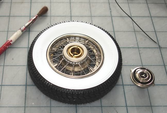

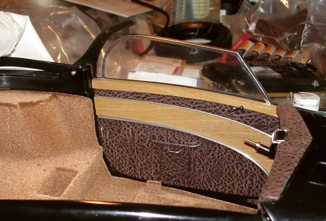

The doors wound up fitting pretty well. Not perfect, but better than I thought they would.
Posted Image
Posted Image
The whitewalls are painted on with acrylic paint, the black ring on the knockoff is painted on, too. The Mercedes emblem is kit-supplied.

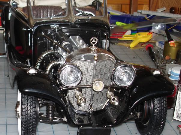

Posted 24 February 2010 - 07:32 AM

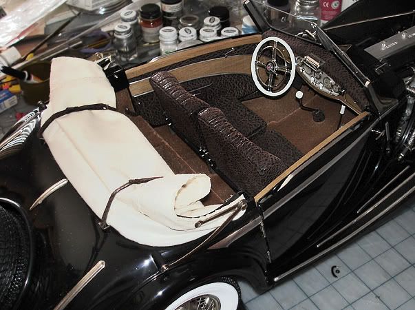

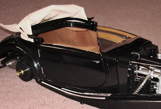

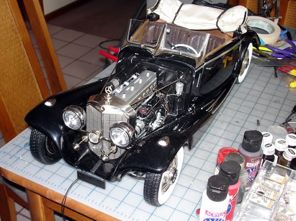

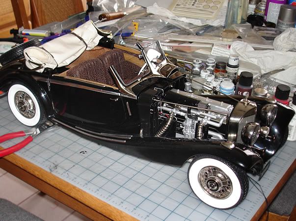

It's beginning to come together. Excuse the mess and the dust... the old girl is still in the shop awaiting a few finishing touches... but it's getting close!
Posted Image
Posted Image
Posted Image
Posted Image
Posted Image
How do you like that high-tech parking brake in the photo above? ;)
