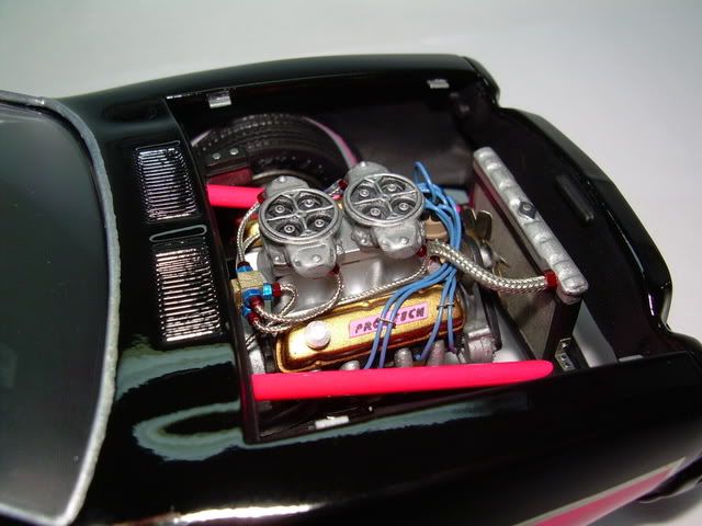

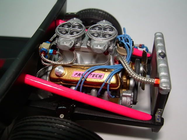

Hi Rick, I have enclosed a few pics of a Mustang II Super Pro (Firefighter kit with alot of rework) car I built using my products for all of the detail work (braided line, hex fittings, fuel block, demon carbs. dist. kit, plug wire/plug boots, plug wire looms, detailing screen (radiator), flex fan, oil breathers, etc.) Hope this give you a first hand look at how the products looks on a finished piece. If you have any questions on anything PM me or give me a call and I will help you out futher on working with the products or how to runs lines etc. My website also has a number of tips under "Modeling Tips" (with more coming) on working with my products.

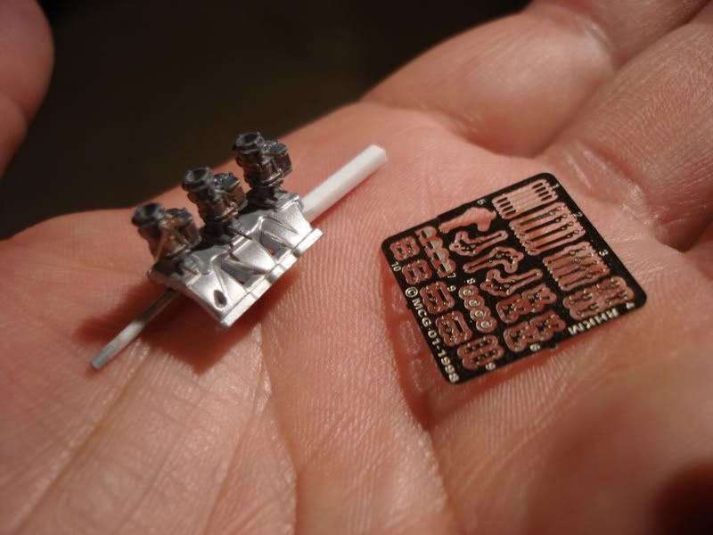

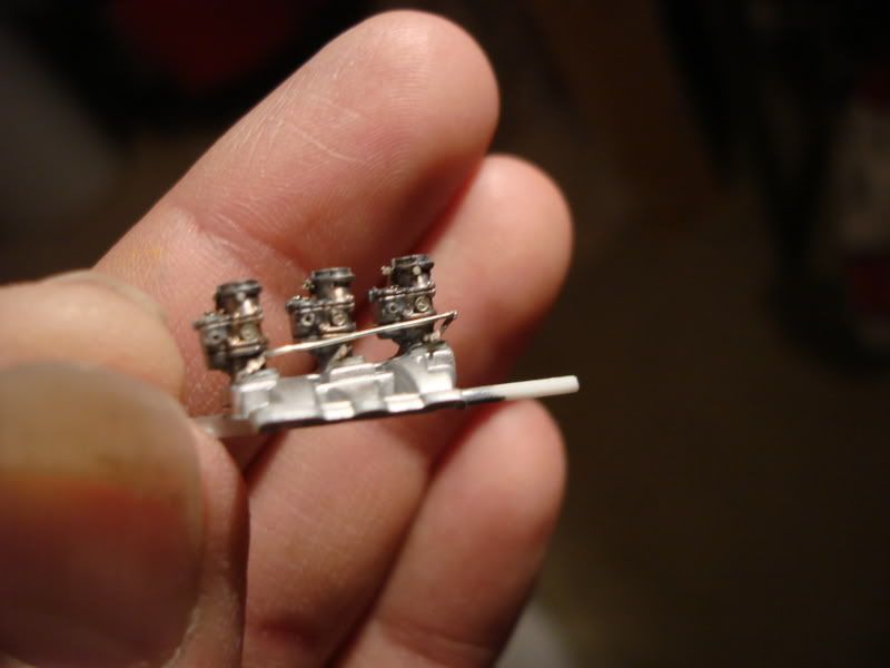

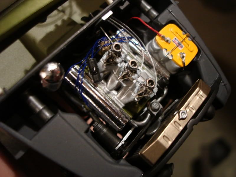

The model car garage has a nice Stromberg Carburetor resin and PE set, a little tedious to work around but with a little bit of patience it turns out great!!
