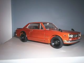

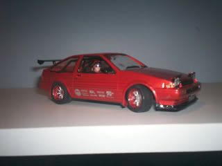

It's sold under the "Pearl-Ex" brand name. I get mine from Hobby Lobby. Comes in lots of colors. I've even mixed it into candies and cut down metallics. Just be carefull of the larger flake sizes (listed as Sparkle) as they can plug up the airbrush if too much is used.
Here's a few I did using Pearl-Ex.

'72 GT-R, Boyd Orange Pearl/Alumacoupe Yellow (appx. 60/40 mix) cut 50% w/Boyd clear, mixed with Sparkle Gold/Sunset Gold/Brilliant Gold, shot over BPS Buff primer

'83 Sprinter Trueno GT-Apex. Testors Kiln Red w/Super Copper/Sparkle Copper and cut 50% w/Boyd clear, shot over BPS Allis-Chalmers Orange.
