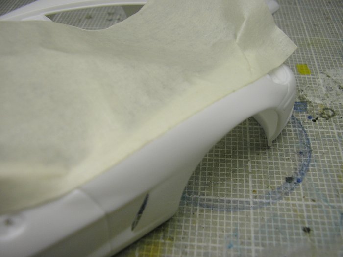

One of the things I noticed in this model is how “soft” the body appears. I don’t know if it’s because of the new plastic or what. I wanted to sharpen up the fender creases somewhat so here’s what I did…………..I laid a piece of tape across the peak of the fender and then with a balsa sanding block and 400 grit sandpaper, sanded away lengthwise along the tape.
Posted Image
Posted Image
This was repeated for the other fenders as well………….it’s something that’s not noticeable to most but something that I wanted to do for myself. :)

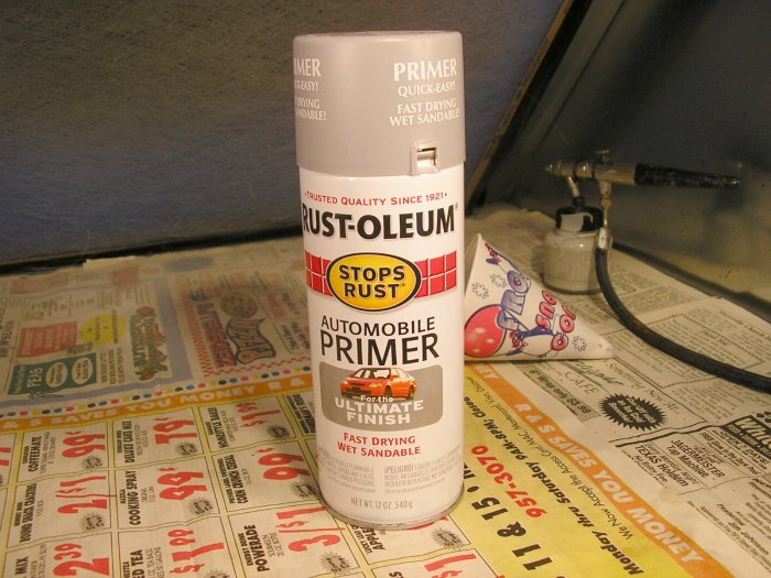

If you’re wondering what type of primer I use it is this………
Posted Image
I like this shade of primer for brighter colors…….also since the Krylon I used previously for primer is all but impossible to find in this shade of gray. I used this under the color coats in the Mustang, so it’s been very consistent as far as being trouble free.
I’ll let the primer sit for a few days and hopefully by mid week I can put on the color coats. Meanwhile, I can start building up the engine and chassis details.
