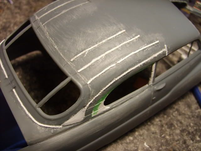

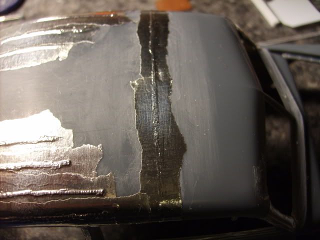

Here are some WIP pictures where I created weld seams under the foil.

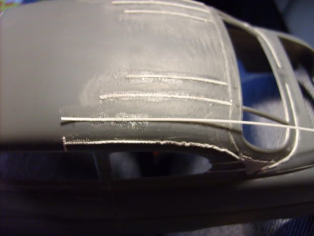

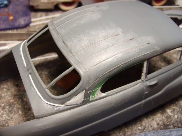

In this picture are two different features. First the triangular patch on the C pillar is .005 inch sheet that was glued down, than the edges were feathered with a file. This is a patch that has been welded in then dressed with a grinder by the bodyman. Second are the slits cut into the roof in the following manner. 1st cut with a #11,2nd cut deeper with a razor saw, 3rd opened with a small triangle shaped file. These will be undressed weld seams.
Posted Image
After the cuts are opened, .015x.020 strip styrene was glued in. This was the smallest I had on hand. When the strips were softened by the liquid cement, I used a sharp tool to push the strip into the groove to simulate the weld beads. Note the lower strip has bunched up and needs to be trimmed away because the strip stretches out as it is worked along the groove.
Posted Image
Here the welds are near complete. You can see around the welded areas the file work I mentioned in Part 1
Posted Image

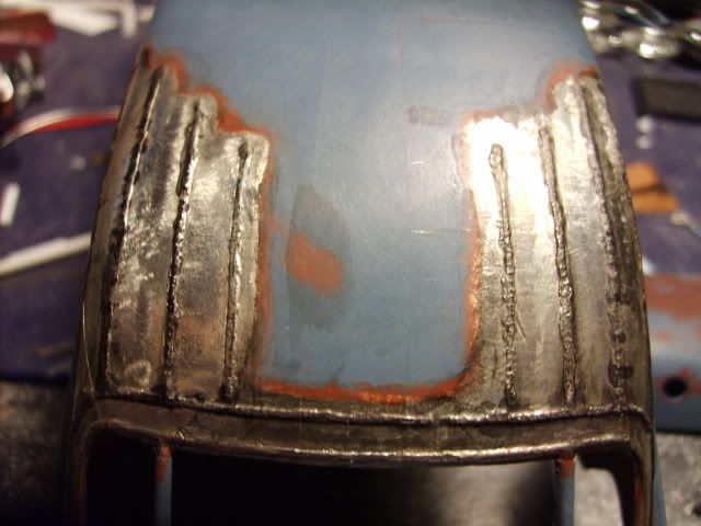

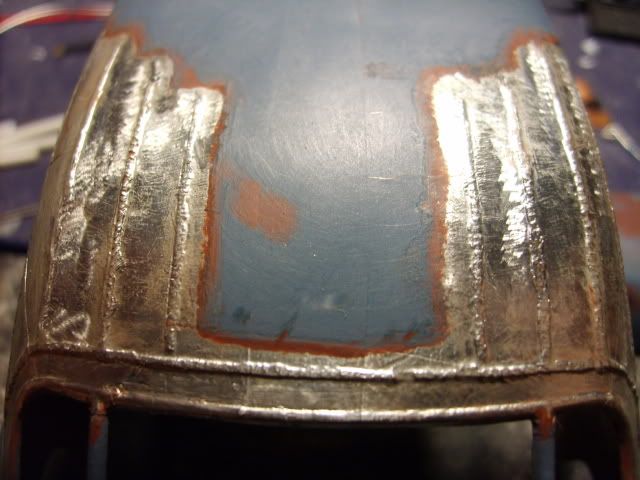

After the foil was applied, I painted over it with Red Oxide primer followed by medium blue paint. The paint was then stripped with lacquer thinner and brake fluid on Q-tips and brushes to carefully reveal the welds. Some powered sanding also shows.
Posted Image
Black ink was washed on and a little added to the seams to give the illusion of heat discoloration.
Posted Image
The finished model after I added some painted on rust to the bare metal areas, and also some black primer.
Posted Image
My first attempt to foil this model showed more unpainted areas. One thing I tried to do was to disguise the edges of the foil by not leaving straight lines at the edges. But you can even see the layers of foil on top of itself.(between the welds) Sanding can be done to fill the edge of the foil under the paint. The bare foil areas can also be discolored with ink and paint to make the seams in the foil look natural to the sheetmetal. With more time on another project I think I can make this method work better.
Posted Image

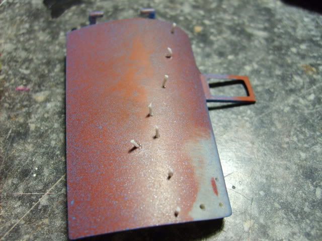

Another idea in the works, trim holes were first drilled then refilled. When the foil goes on there will be small imperfections that can be discolored with ink. I like to use ink for this because is washes up with alcohol and leaves behind a variety of shades. Paint could work as well. I often paint a car with oils then weather it with water based colors so that the original finsh is not altered.
Posted Image
Thanks for looking. Please feel free to ask if you don't follow my ramblings.

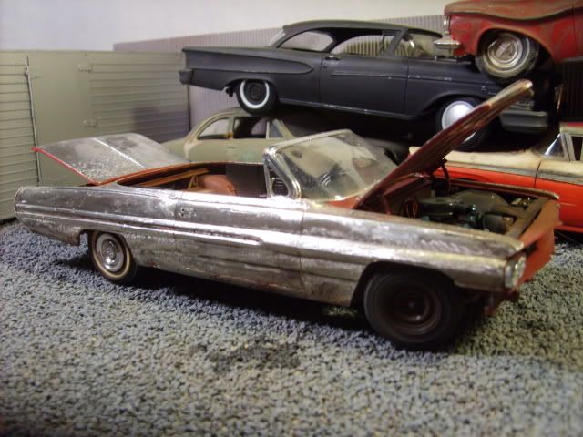

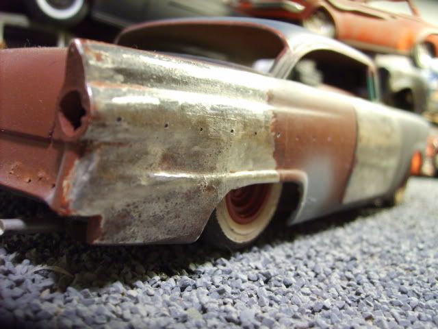

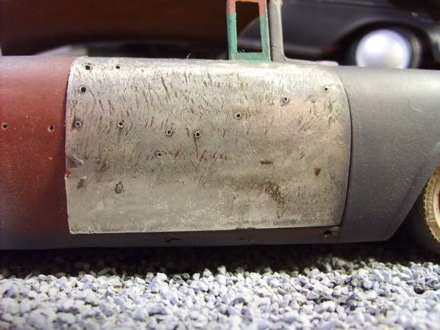

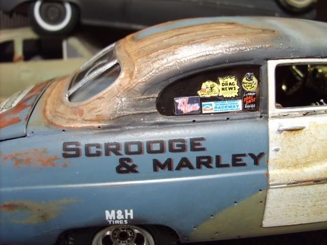

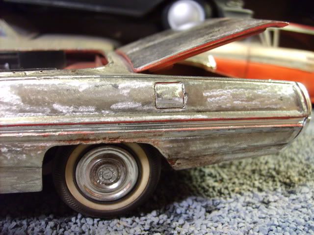

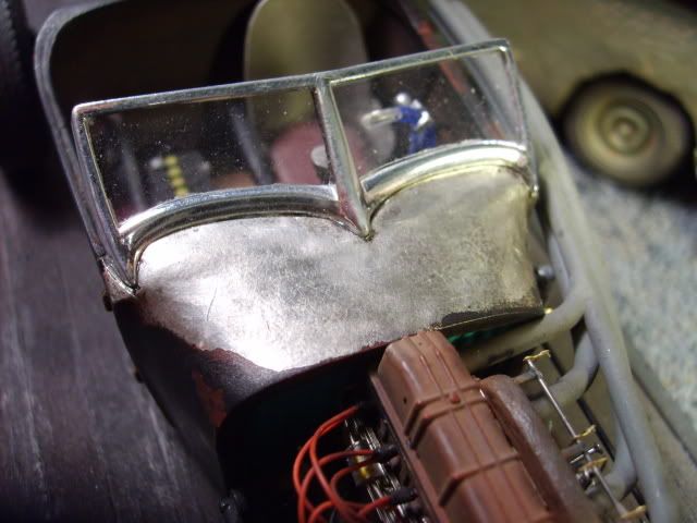

A few More Examples.
Posted Image
Posted Image
Posted Image
Posted Image
Posted Image
