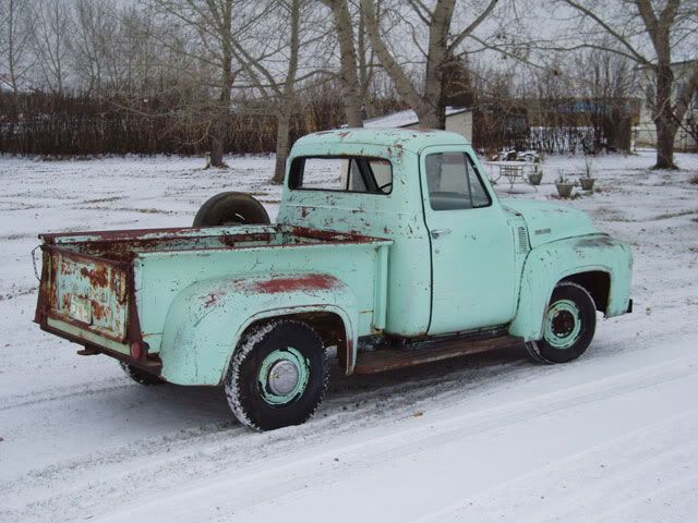

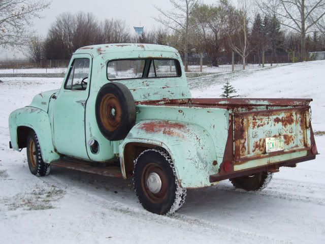

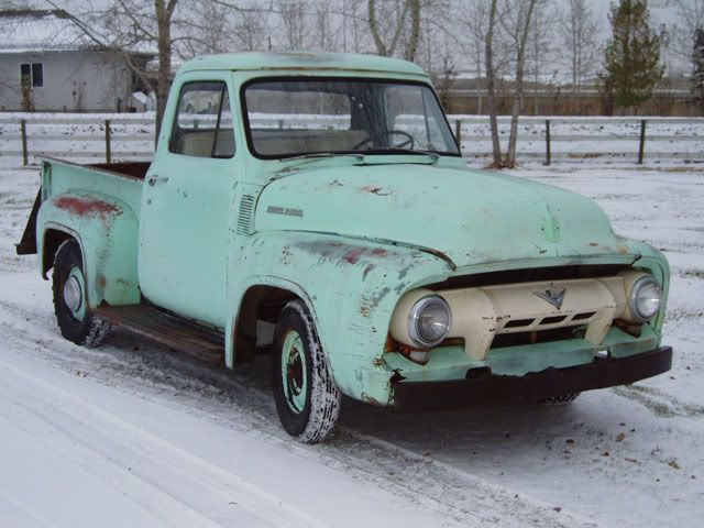

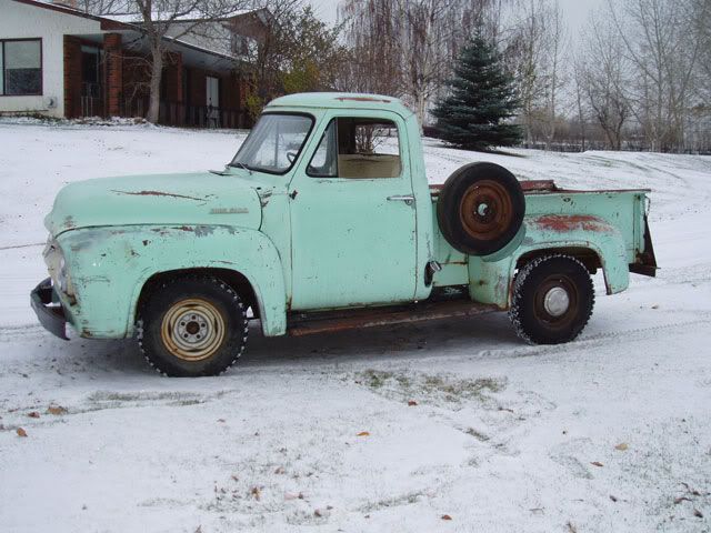

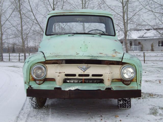

Dave between you and Davezinn I've got my question answered and then some, thank you guys, here's the real truck
Posted Image
Posted Image
Posted Image
Posted Image
