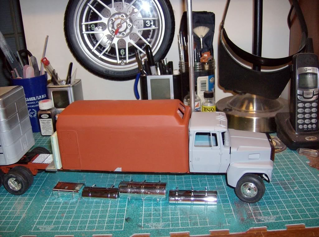

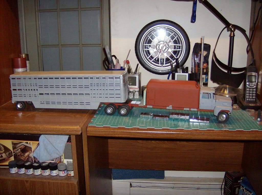

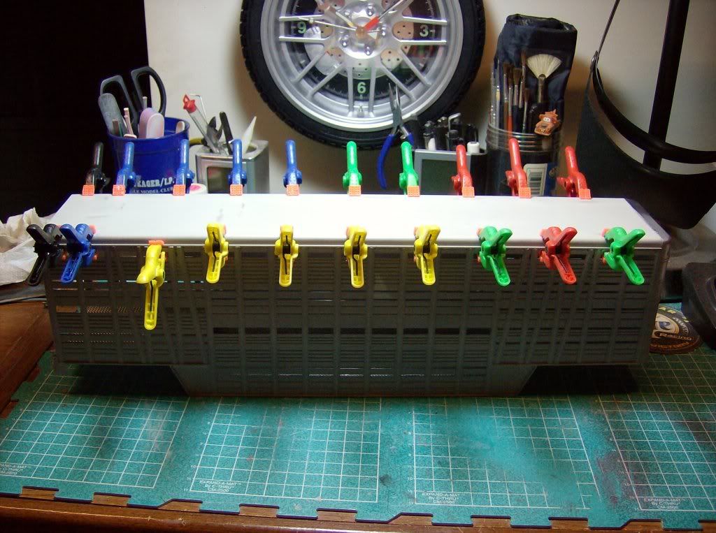

I got more done today on the truck and trailer, I spray painted the inside of the trailer and got the roof of it glued in place. The roof have a slight warp, thank gooodness for super glue and clamps!!
Posted Image

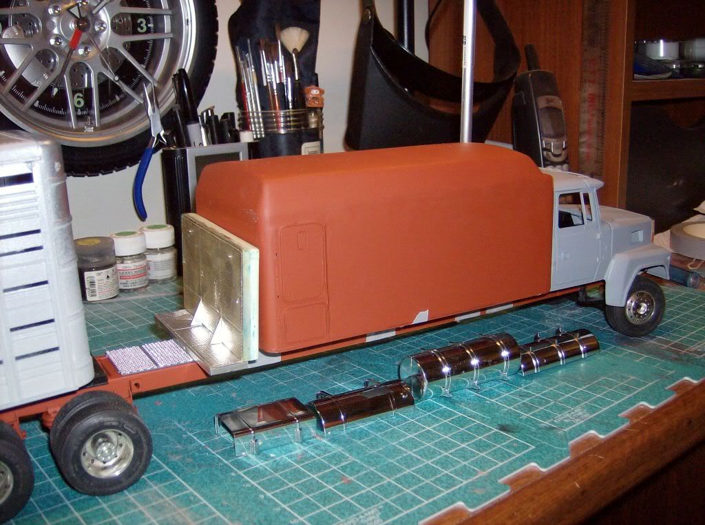

I also tackled the priming of the cab and sleeper, along with the frame, and mocked the truck up again with a few pieces of rectangular tubing between the frame and sleeper that will later be glued in place for extra strength.
Posted Image
The extra tubing to strengthen the frame will go past the sleeper, so I decided to see how a headache rack I modified from Revell AG's Pete 359 would look on the back.
Posted Image
This will hide the extra tubing where it extends past the sleeper and the tubing will tie the original frame back together. I also laid the fuel tanks beside the truck to get an idea of what the side will look like, as well as the 5/16 diameter aluminum tubing I'm going to use as the stacks.
Posted Image
Of course, the stacks will not be that tall, I just haven't cut them yet! :lol: The tanks laid out may not be the final design, but close to it. The front two per side will be fuel, the next water, and the last (the square one) will be tool boxes, one of the tool boxes (probably the passenger side) will be representing the APU generator.
P.S. The nose of the trailer gives you a hint of the trailer color, some Krylon "Original Chrome" I had sitting around.

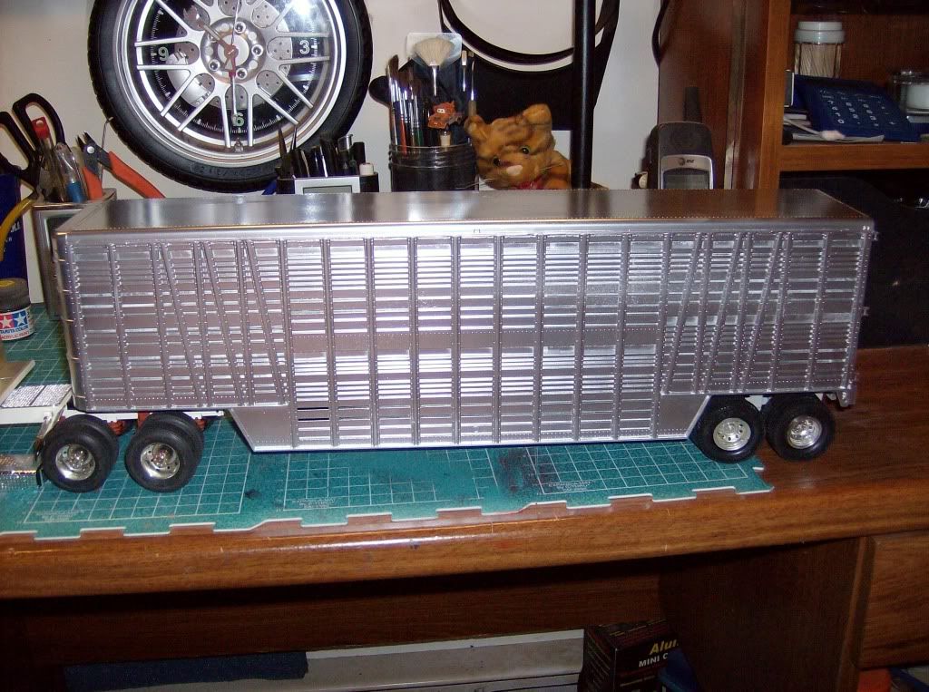

Hi, wagoneer, thought I'd find you here! :lol: I think the prototypes don't sag because I think the frames are a little thicker than normal and LOTS of crosssmembers. I'm working on some extra strength right now (waiting for the glue to dry B) ) by adding some retangular tubing to the top of the frame where my extention is. I'm going to hide it under the sleeper and headache rack. The trailer goes together very nicely execpt for the roof, mine had a slight warp and that's why it looks more like clamp storage in this picture:
Posted Image
There is also not much to glue to, the roof sits on top of the side panels and the thin lip there and the side ribs are all that hold it in place. The way I glued mine in place was first I applied some Model Master Liquid Cement to each rib, laid the roof in place, and started clamping front to back. After I had the roof in it's final position, I used some Zap CA (the really thin stuff in the pink labeled bottle) and found a small depression where the roof meets the side panel in the back, put three or four drops in the hole, then slowly rotated the trailer so the Zap would run along the seam to the front of the trailer. That worked fine and the roof stayed where I wanted it! Also, the headache rack, even though it's from the Revell AG's Pete 359 (and it's also in the "Can Do" wrecker), I modified it with some square tubing and closed the back to make it a true box. I originally made it as a master for a mold I made experimenting with casting my own parts. A friend of mine has an old Western Star I had bought for him to give him something to do while he was laid up after knee surgery, which he never finished, and he finally gave it back to me to finish for him. Since he used to haul steel, he wanted the AMT flatbed on the Star, and he wanted a headache rack on his, so I made that one to cast. Finally, color and graphics are undecided as of now, paint may be DupliColor "Mirage" purple to red flip-flop and possibly a complementing or contrasting "Mirage" set of ghost flames on the hood. The only color I know for sure is the trailer, and it's Krylon "Original Chrome", since it gives it a nice new aluminum look. Well, back to the model desk!

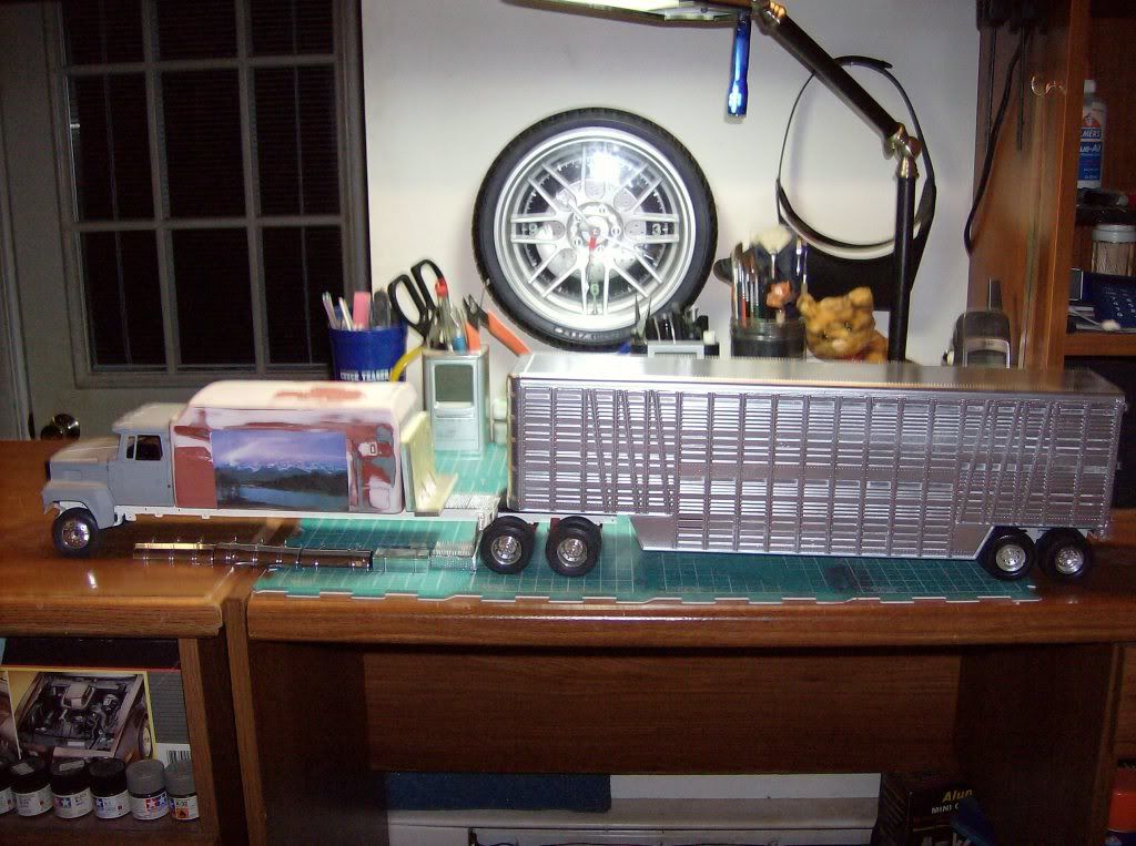

I've been doing more work on the truck and trailer lately, the trailer is in primer as of today. I also went on line to get some pictures to use as a mural on the sleeper, but I need your help! This is what the mural will look like:
Posted Image
but I need help with the size! Do you think the mural looks good the size it is, or should I make it a little bigger? Please help and give me your opinion!!

That truc is long. I would hate to try and navigate that through Walmart

Yeah, it would be fun! :lol: The truck has a scale wheelbase of about 350 inches and with the 40 foot livestock trailer it measures a scale 70 feet long.

WOW!!
What a Sleeper. :lol:
I think I saw something like that on Truckers Dream Homes. :lol:
I think the Mural should take up the whole side of the sleeper.
nice looking one too.
Nice work

Thanks, Zuk. It's definitely a "Trucker's Dream Home" being a scale 180 inches, compared to 70 for a stock sleeper. Thanks for the opinion on the size, too. That's why I asked for everyones opinions on it, because I'm thinking a little bigger, but the better half said it looks fine. :blink: It's amazing what you can find online, I "Bing"ed "lightning and mountains" in images, and that's one of them that came up!

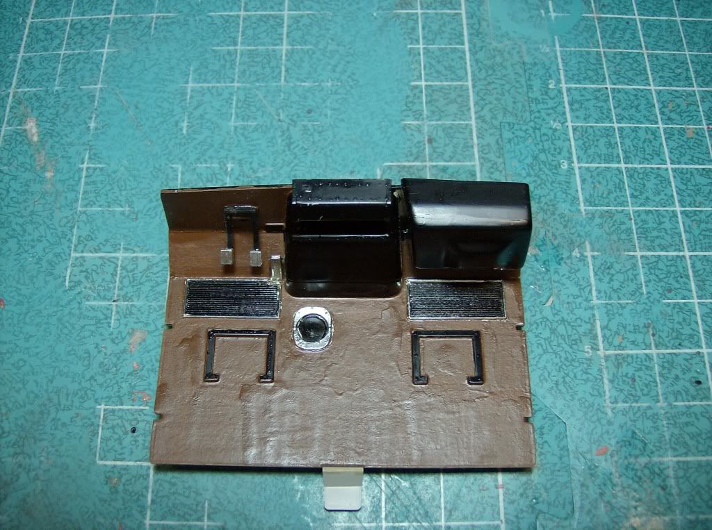

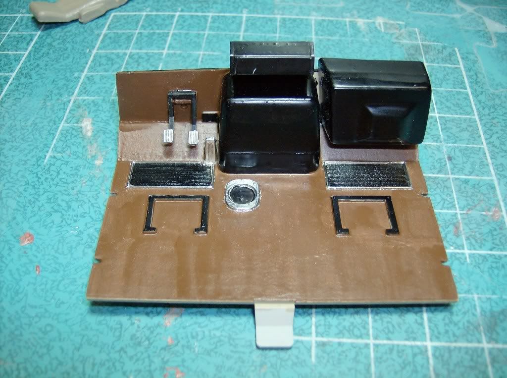

I did some work on the interior of the cab and got the interior pan painted and added some Bare Metal Foil to some things to dress it up. Any good trucker loves shiny objects!!
Posted Image
I even made the pedals chromed.
Posted Image

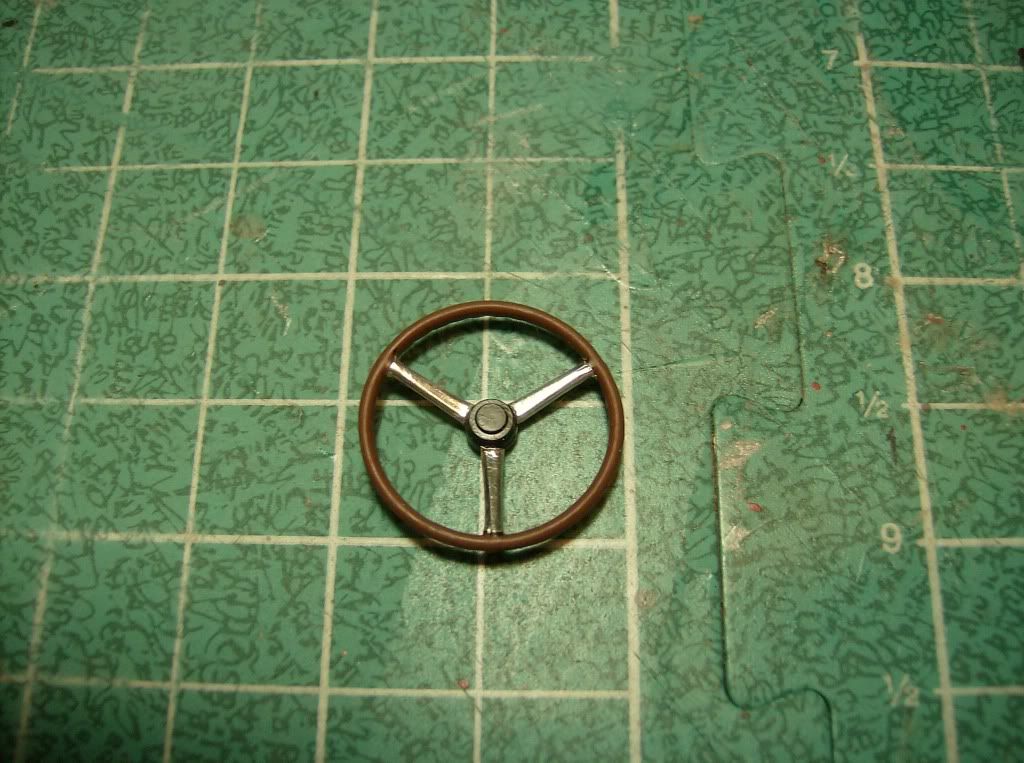

And a little to the steering wheel.
Posted Image

Excellent, Matthew, but if you want your Ford looks like Show Truck, you better use an air brush and masks for interior too.

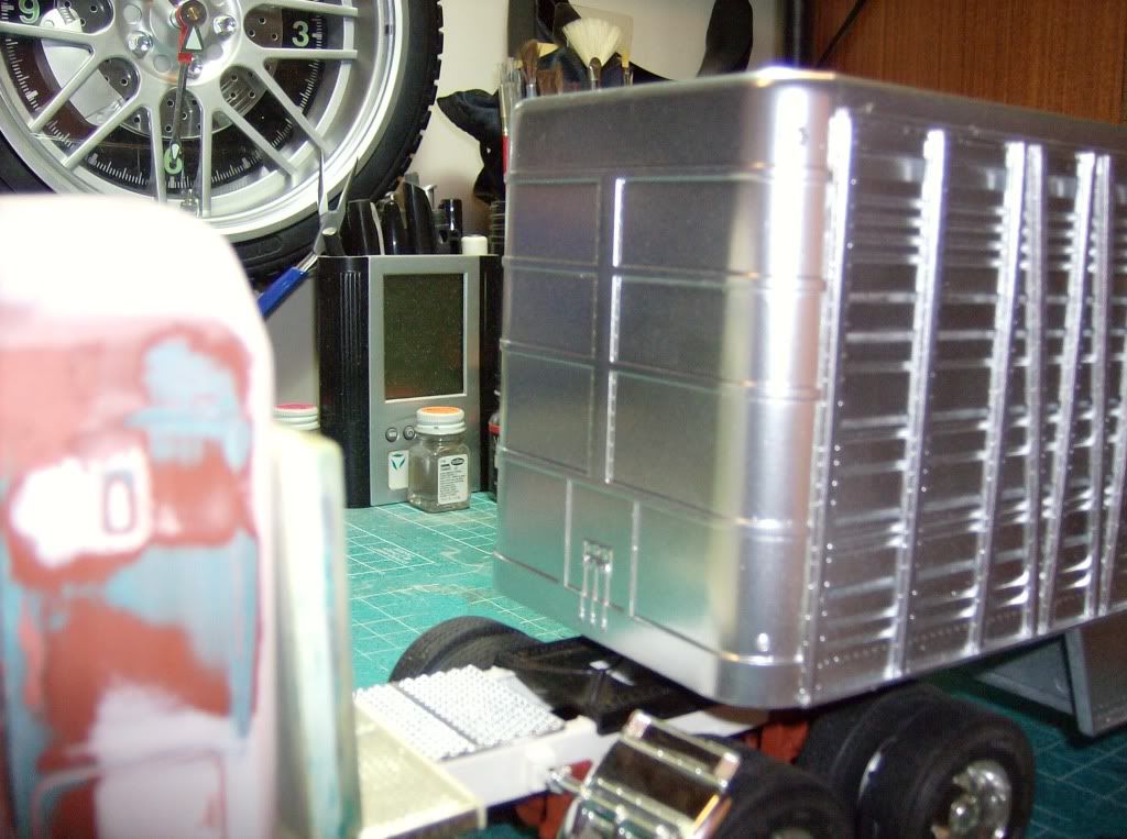

I finally got the trailer in it's first coat of paint, here's what it will look like after I get a few rough spots taken care of:
Posted Image
Posted Image
I found a set of Alcoa wheels to replace the trailer's five spoke wheels, and was also surprised and pleased with the look of the Krylon "Original Chrome" paint. Most of the chrome spray paints I have used in the past have not had this much shine, but still has an aluminum look to it.

You asked for our opinions on the sleeper graphic length/size. Being it is printed off the computer versus being painted on, I would stop short of any surface irregularities that would cause issues with the graphic laying down smooth.
There used to be a trucking company called 'Circle C', and their trucks were completely muraled; some of the best-looking paintjobs I had ever seen.

Thanks, Brad, I was not planning on going past the storage door on the side I have the picture mocked up on because I don't want to mess with the irregularities. There is also an access door on the other side, and that extends to the first curve in the sides. I will be printing the picture on decal paper, but since this will be my first time making my own decals, I wanted to do it on a smooth surface.
