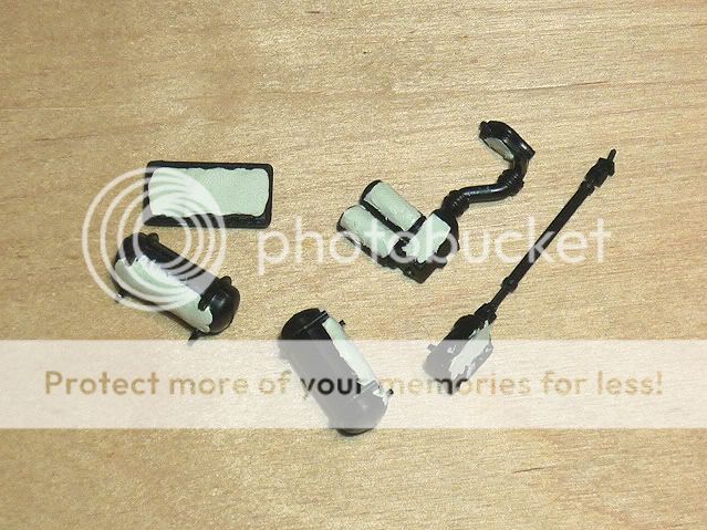

Here I decided to reinforce middle axle, as Italeri's one (see above one) are hollow. I'd rather used some steel rod or tube, but couldn't find suitable one. So AMT's sprue was used for solid axle.

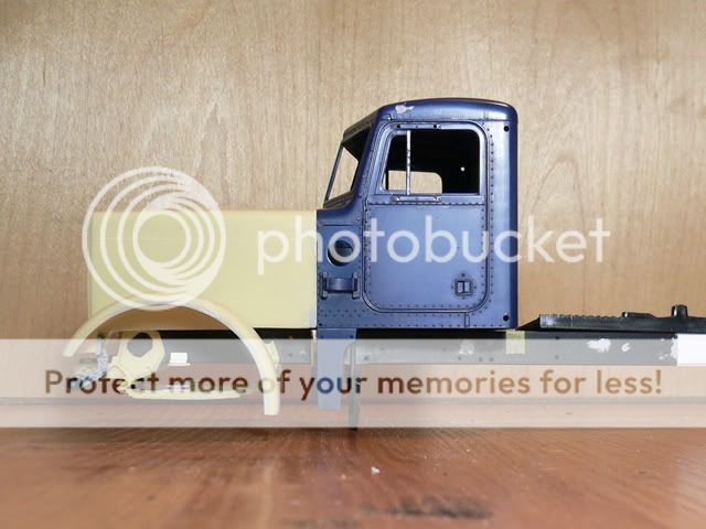

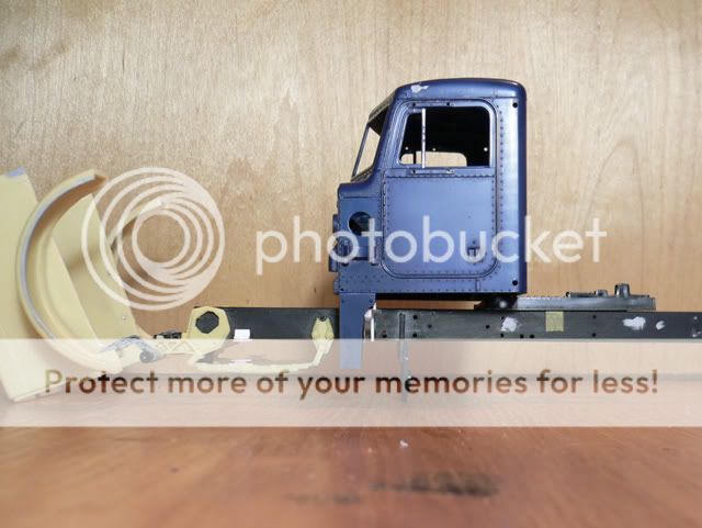

Hi, friends. It's me again. Much time passed since my last update and I have nothing to boast of …

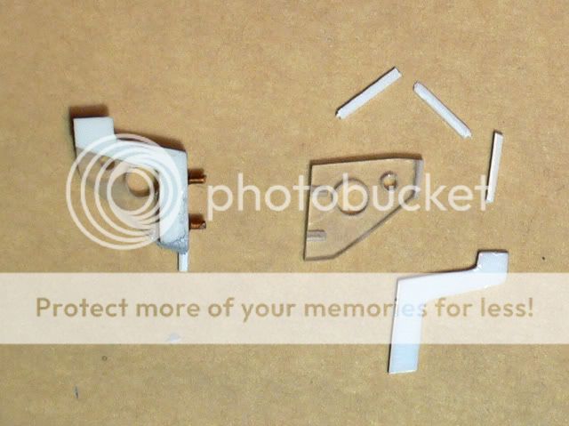

New cab mount brackets were made: Posted Image
For new hood I was have to lower the cab about 3-4mm. It was easier to scratch build one, then adopt existing brackets. Here the cab on original mount: Posted Image
Here - on new one: Posted Image
Extended frame: Posted Image
The front half: Posted Image
Cab to hood adjustment: Posted Image
I was have to tear away right front fender and glue it to the hood again 4 times (!), until everything was truth and level. So resin parts without markings are evil things.
Filled up hollow chassis parts: Posted Image
There is a fail, I guess. When the hood is lowered, fenders look bigger then on picture of original (the last photo of this thread): Posted Image
Can anyone explain: the front fenders for custom, lowered Peterbilts have smaller radius then originals? I tried to put super singles on front discs, but they look wrong here, though the gap between wheel and fender became smaller: Posted Image
Looks like I should tear fenders off again to bend them slightly and reduce radius. I see the beginning of depression... :)
Can anyone help me to find more photos of this rig?: Posted Image
I know there was a galery somewhere, but I've forgot to save it. :(
Edited by Sergey, 07 December 2010 - 02:38 AM.

hey sergey i found the article that truck was in, but it has the one picture. if youll notice 95% of the trucks you see lowered have the same issue you have. the only way i can think to fix this is go to a smaller rim and tire, look at the pic of this truck it has the same problem you do and it has either a 19 or 22.5 inch rim, i believe you have a 24.5 rim with tall rubber ( 11r24.5 ). maybe you can try a set of fenders off of a 1/25 scale, that will give you a smaller diameter. your truck is looking good so far, i like what your doing. good luck finding the other pics. it was in 10-4 magazine from a show in famoso california. heres the link : http://www.tenfourma...c/2005/12c.html
dennis

Looks like too me you may need a filler plate on the hood between the fender and cab(I see a BIG gap there). But for custom hoods no idea.
Thank you, Clayton. I have filler plates, but didn't glue them down jet. They coul be torn away while fiting all the sub assembly.
