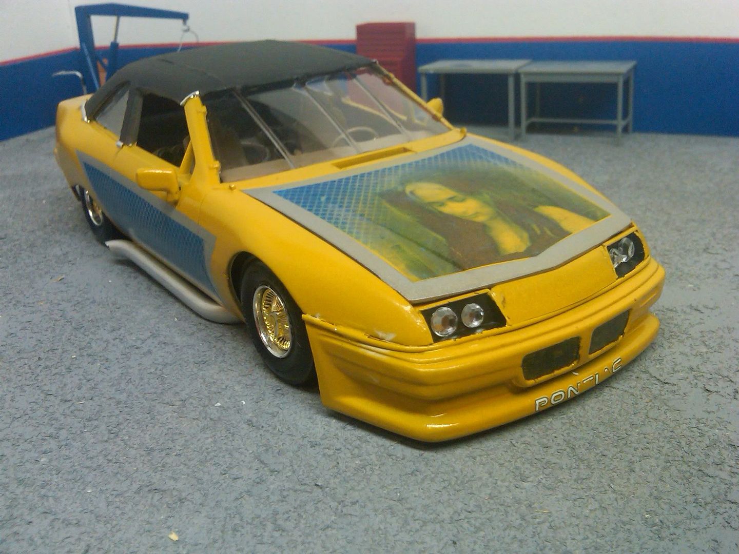

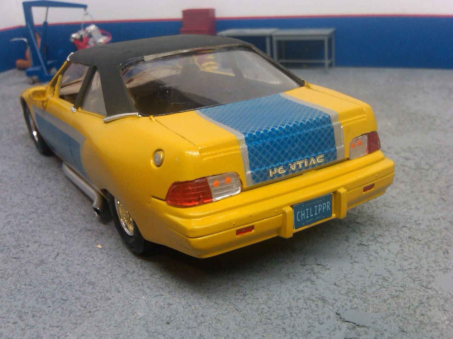

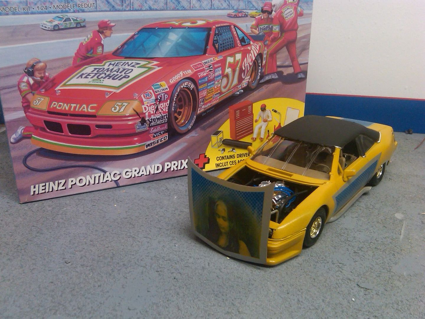

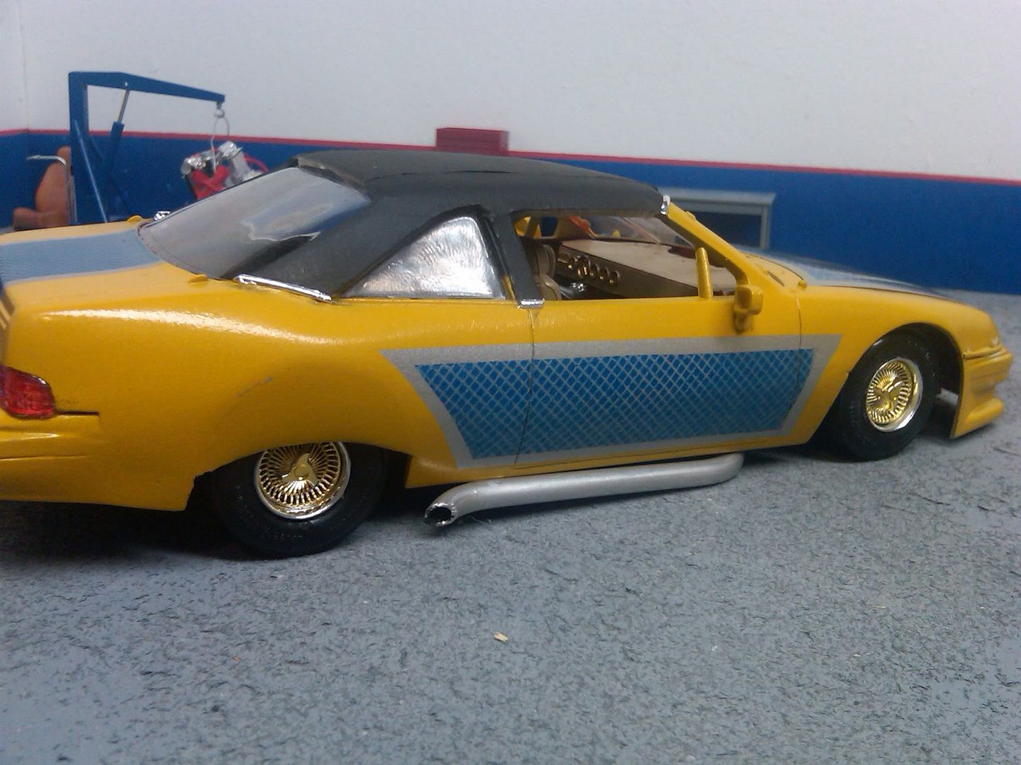

as usual, my model doesnt look anything like the boxart :(
Posted Image

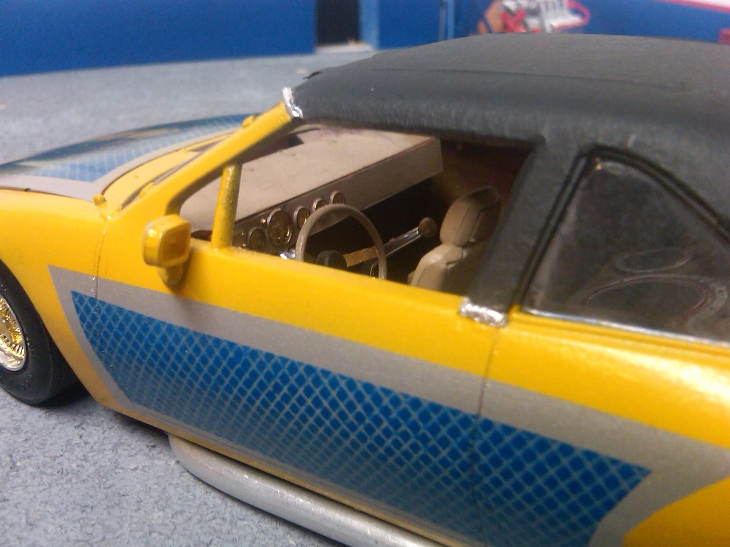

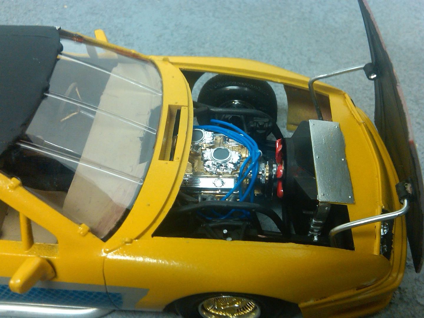

i started this build off with a heinz 57 pontiac grand prix stock car
to the body i made the following changes
scratchbuild the headlights
scratchbuild the flip flop hood hinges
filled in the hood pins
scribed panel lines for the doors
added partsbox side view mirrors
scratchbuild the rear skirts
custom build the tail lights
filled in trunk pins

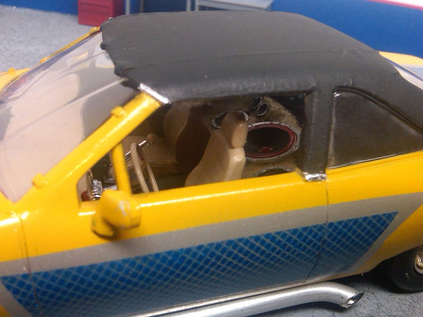

converted to steel roof to a vinyl top
the interior
partsbox seats
shortened steering column
partsbox subs
scratchbuild shelf

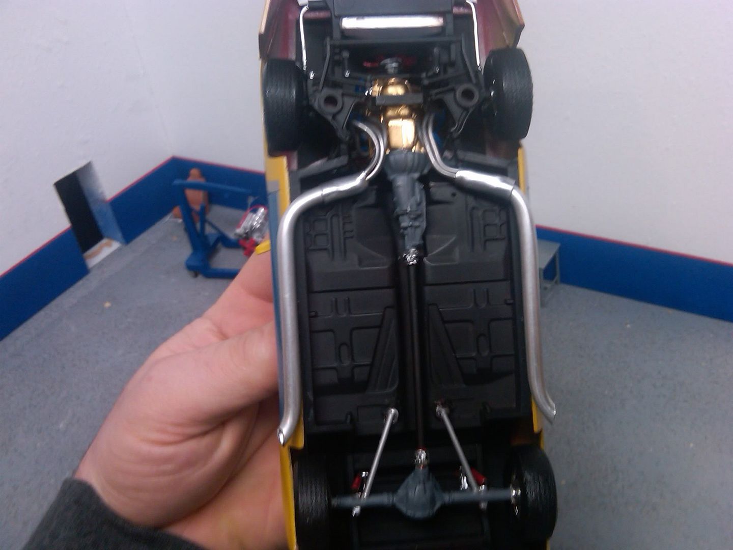

the drivetrain
replaced the engine with a cross barrel 302
moved the dizzy to the front of the block (for firewall clearance)
scratchbuild the entire exhaust using solder for the headers
heatshrink tubing for the collectors and aluminum tube for the lakespipes
custom build the rear end
scratchbuild the rear suspension
the body received first a coat of german silver
then a coat of RAF training yellow
then decals and finally a coat of true blue
here are some picture and dont hesitate to comment :(

I was going to use the "cup of tea line" also .It is different that's for sure.I like the mural on the hood and I liked the tutorial on the hinges you did.you finished it yay!

Hey that came out really neat! I like that you ventured out of the box on this one. I like that paint and graphics and mural. It's builds like these that got me turning a tank into a 6x6 lol. I know your labor was a lot on this and be proud of it.

I never really thought about turning a NASCAR into something else, but you sure did :blink:
A lot of work went into that one. I like the idea, the work you put into it, and that you dared... Great job :)
Where are the mural decals coming from??? They look great...Homemade?

thanks :blink:
the only decals on it are the license plate and the hood
the way i did the sides was by first painting a coat of silver
then i taped that of and shot the yellow
then i taped that of and uncovered most of the silver
i taped some left over screen door over the silver and then shot the blue over/through that
for the hood i basically did the same but before i shot the blue i applied the decal
the decal is indeed homemade
i took a picture of Mrs. diymirage and scanned it
then i changed the colours to black and white and printed it on decal paper
it didnt come out perfect but for my first try on making my own decals im pretty pleased with it
once the decal was on i taped over the center of it (just to be safe) and shot the fading blue through the screen again
