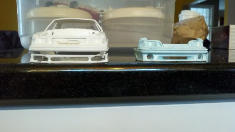

I made some progress on the Saleen.
I originally was trying to just modify the 93 Cobra ground effects, but I decided to take it a step further.
The only thing I was really satisfied with was the front grill.
Posted Image
I spent some time in the garage with #583. I took some measurements using the bottom of the belt line molding as a reference, and quickly realized the front airdam on the cobra body doesnt come down far enough. The airdam on the Saleen is as low as the side skirts are. One of the reasons the car looks so aggressive.
Posted Image
So I removed the airdam with a razor saw. You can see how much space is between the parts.
Posted Image

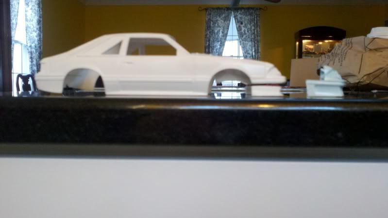

Here is a side view.
Posted Image

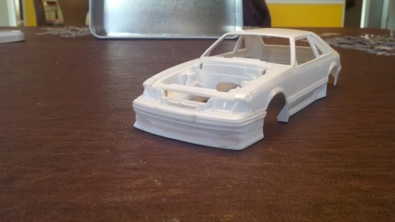

So I added some evergreen strip styrene and built up the area....
Posted Image
Then glued the airdam back in place. I also added some body filler to it to cover the earlier holes I made. Once I get the shape right, I will drill and shape new ones. I scribed a couple of lines in the front moulding to replicate the bumper filler.

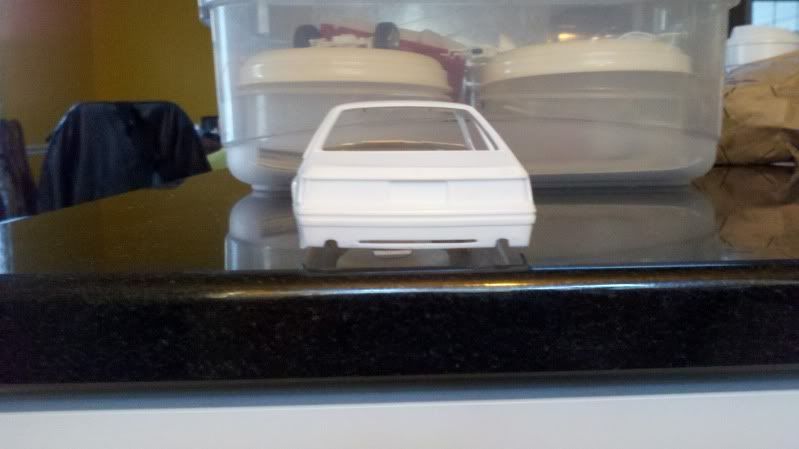

Originally I just smoothed out the cobra bumper and enlarged the tailpipe openings. To make it more accurate, I drilled three holes in a straight line across the valence, even with the tailpipe slots. I then used the backside of a hobbyknife to scribe through and open up a thin slot.
Posted Image
I used a small piece of sandpaper and slowly enlarged the slot till it looked right, then I added three pieces of styrene Rod on the back side.
Posted Image
Not perfect, It doesn't quite wrap under the way the real one does, and the tailipe openings are a bit to far toward the center and the slot is not wide enough, but I think it looks convincing.
