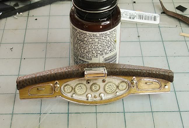

I used real veneers on my Mercedes (it's actually birch, stained with oak stain). It "works" because the birch has a very small, tight grain pattern that will pass for "real" in 1/8 scale.
Posted Image
