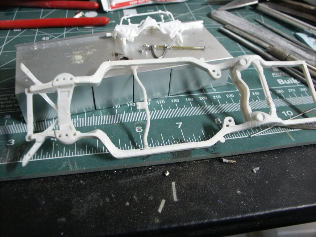

I started with the revelle monogram 1967 Chevelle my plans are to build this project with full working suspension so i need a complete frame. The kit frame just wouldnt do so i went diggin thru my junk yard and came up with a AMT Ertel 67 impala frame its a tad too wide and a bit too long so its gonna have to be channeled and chopped.

If you look closly at the frame you can see that I have already filled the right side of the frame rail with squadrans white putty. this frame is ideal because its a seperate piece and not a part of the floor pan.

here the new frame has had about 5 scale inches removed to make it narrow enough to fit the chevelle body

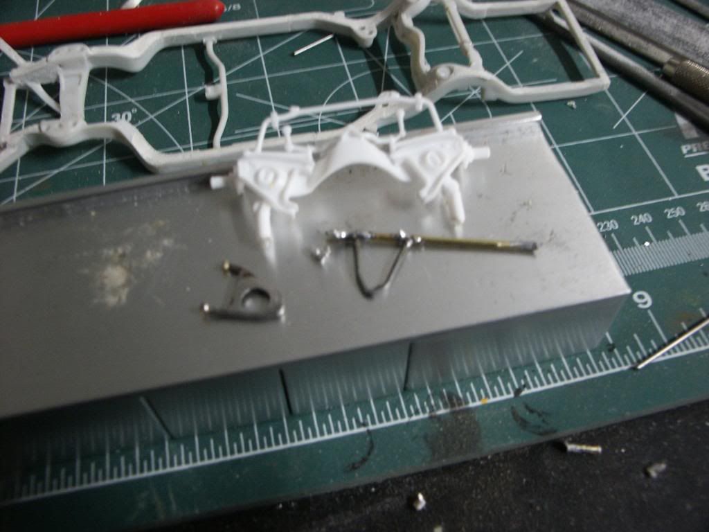

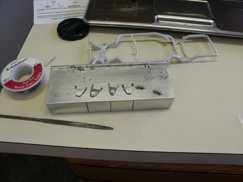

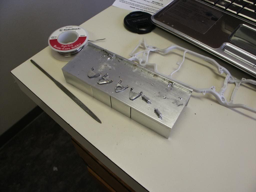

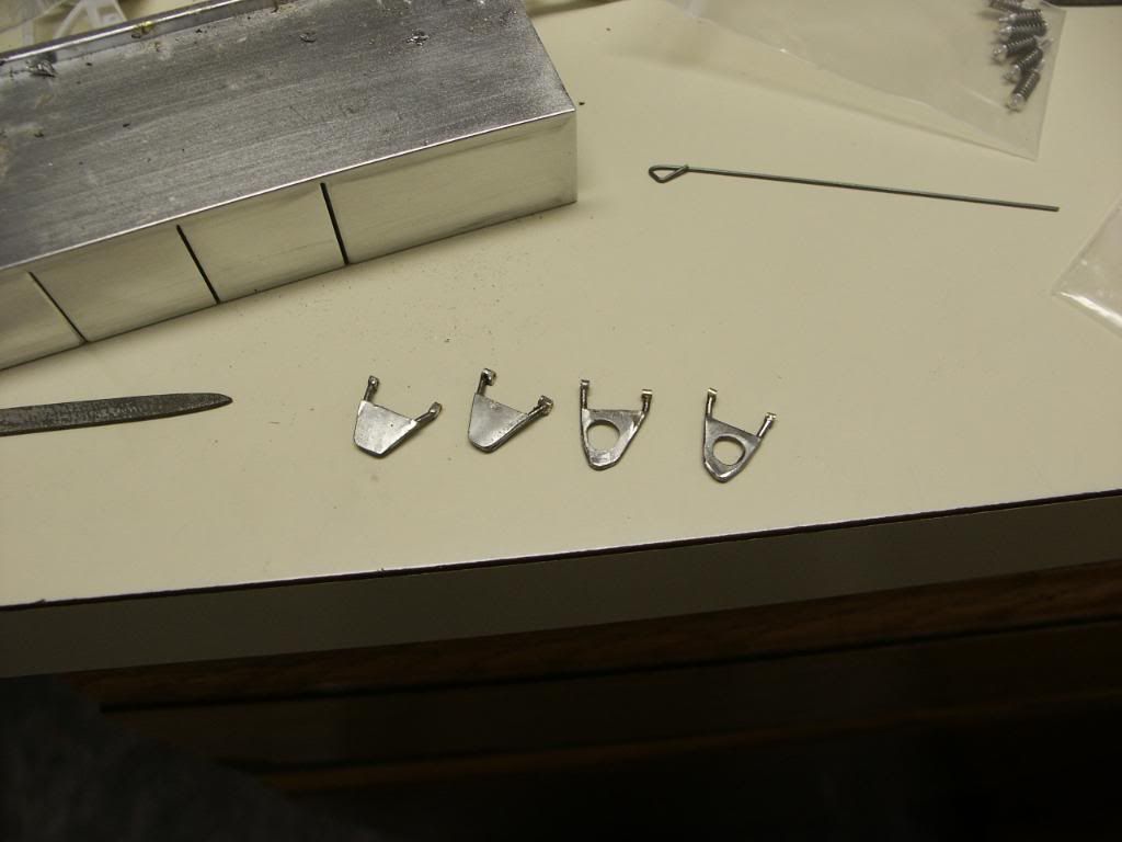

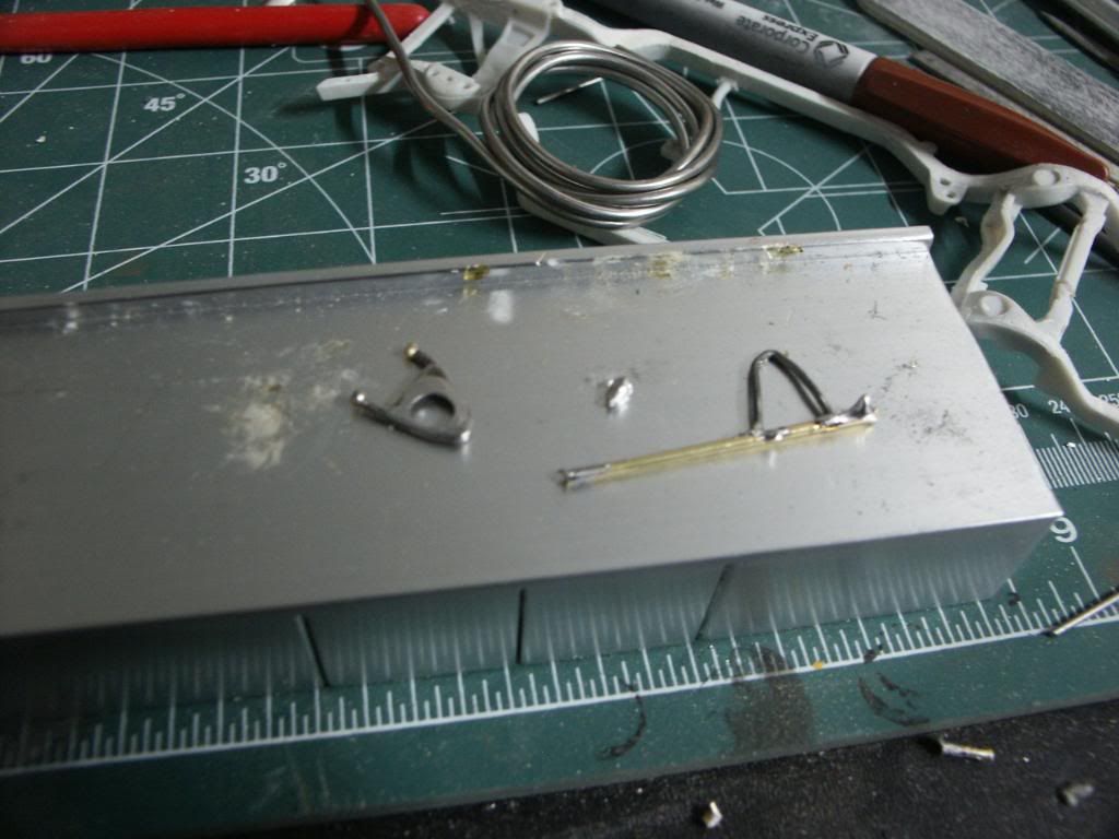

Heres the frame all filled in and sanded smooth, I also made some lower tubular A-Arms which are pictured below. I made them from brass tube and piano wire wielded together with rosin core soder
Posted Image
Posted Image
Posted Image
Posted Image
come back tomarrow for more updates...

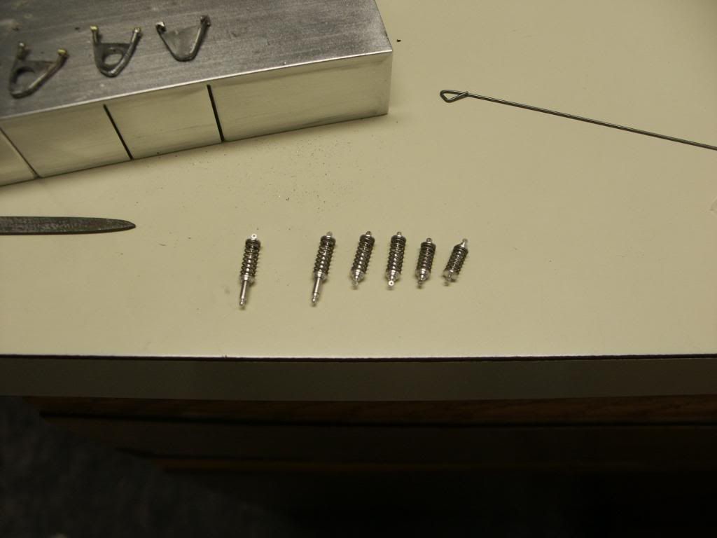

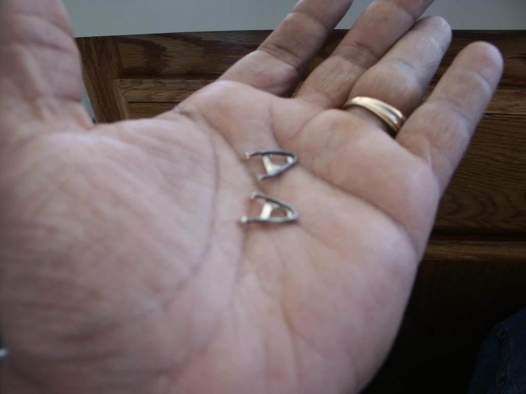

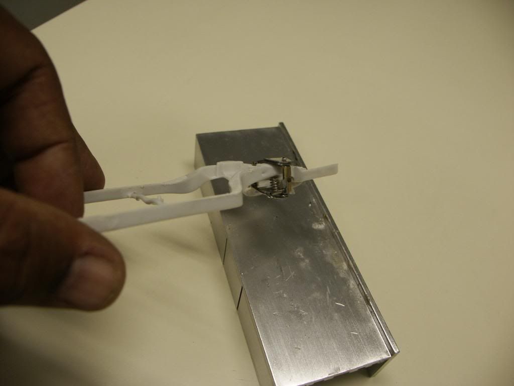

welcome back .... to those of you who come back LOL! And welcome to those of you who are here for thr first time. Anyway i finished fabricating the upper and lower tubular A arms and i was able to put the shocks together I have three pairs done because Im not sure of how I want the stance of the car and all three pair are a slightly differant size. I'll be making the 2" drop spindles tonight so i'll have more pics for ya tomarrow. I hope you enjoy these.....
Posted Image
Posted Image
Yes the springs do work ...!!!
Posted Image
Posted Image
Posted Image

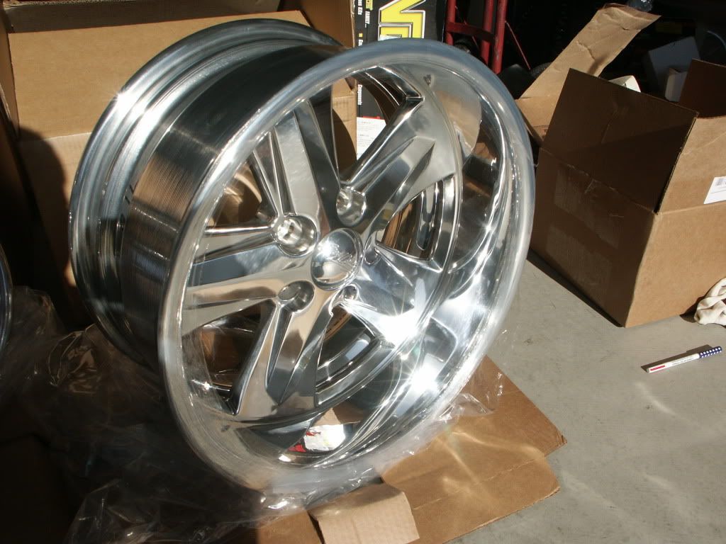

I wanted to show these Rims From Dr. Model I have purchased rims from this make on a few other projects and im never unhappy with there products I was gonna modify them but there really close to the rims im puttin on my 1:1 (in the bottom Pic)
Posted Image
Posted Image
Posted Image

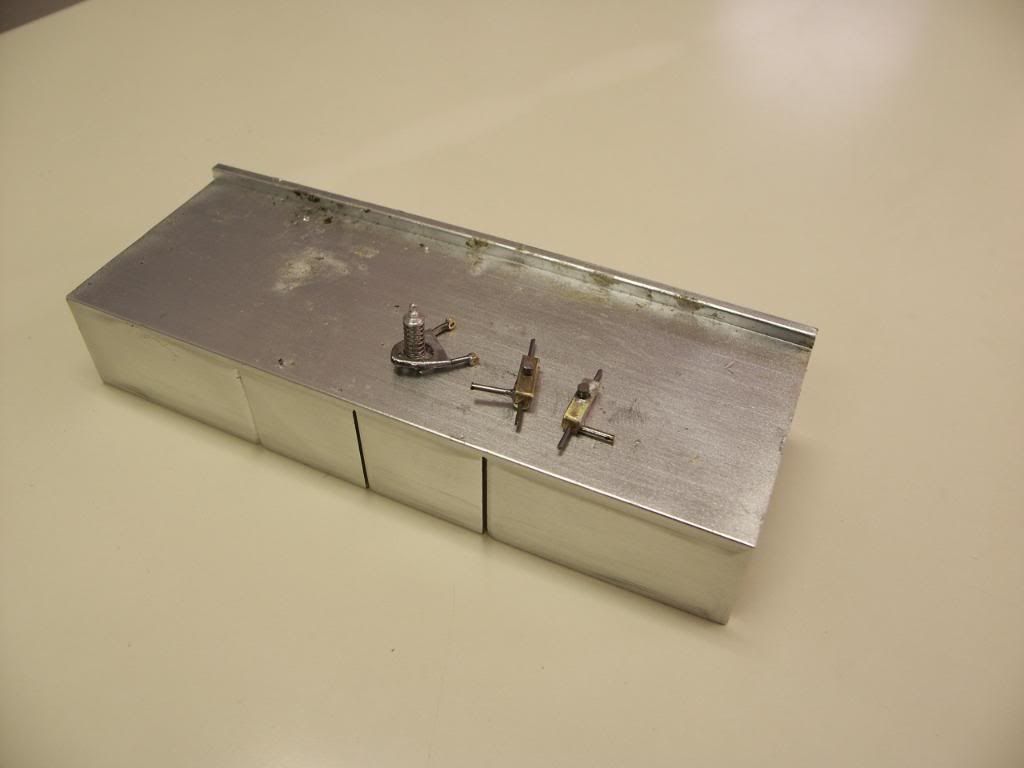

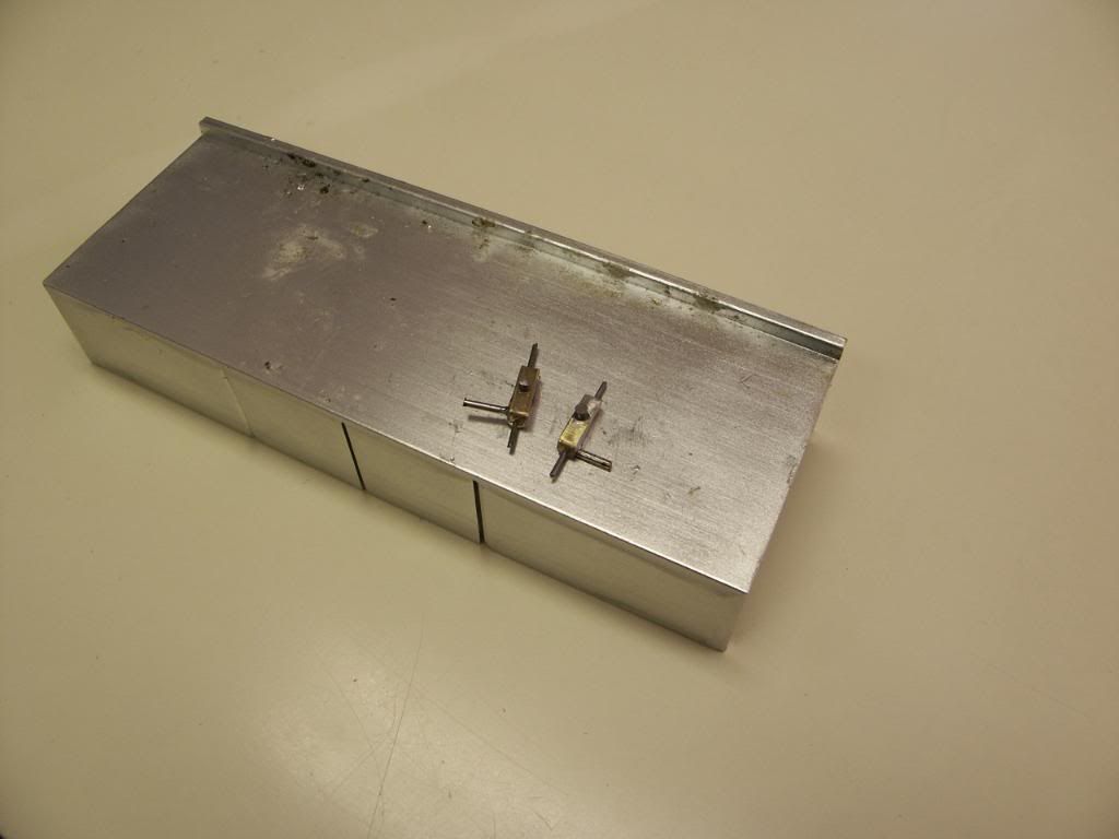

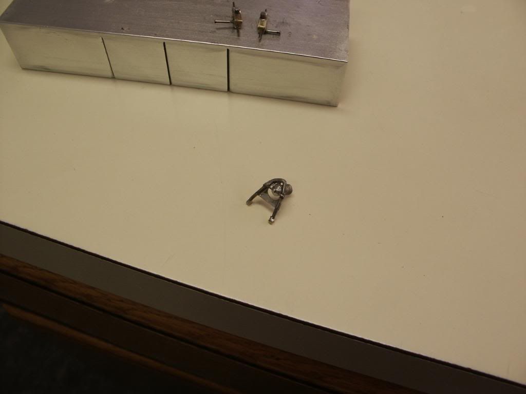

Well I was able to fabricate all the components for the front suspension today I finished one side so i could show you guys. And yes it all works. Its just set up temperaraly, it all still has to be cleaned up and painted. I hope you enjoy.....
this is a pic of the bottom of the A arm with the coilover attached
Posted Image
I facbricated two 2 inch drop spindles
Posted Image
Heres a pic of the parts together
Posted Image

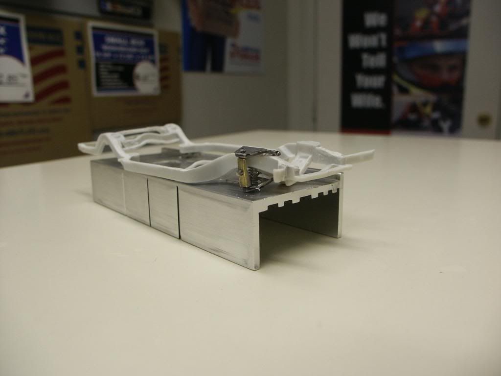

heres an early mock up
Posted Image
Posted Image
