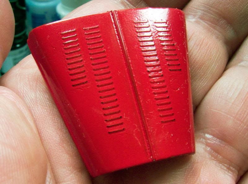

Excellent summary of the issues invlved in making your own louvers. And they are pretty daunting as well as extremely labor intensive.
Here's the fully polished piece. The Archer louvers have survived some pretty agressibe polishing on my part, starting all the way down to 3200 grit (I usually try to avoid anything more coarse than 4000). With three coats of clear and as many of color to protect them getting down to the raw louvers was not a problem. Here are some pics. There's more orange peel than I'd like but that's primarily an artifiact of the ultra-closeup picture. They look pretty smooth and shiny at any distance at all (like 1 ft.+). Overall the louvers remain finer and more realistic than most but could benefit from some more depth to stand out in relief more dramatically. As I said before, in an application with flat or semi-gloss paint this would not be an issue.

After applying the final coat (usually clear), I wet-sand with 1500 or 2000 grit in order to remove all paint texture. When the surface is perfectly flat and free of all texture and orange peel, I polish, first with a coarse compound (Tamiya Coarse) and then with Tamiya Fine.
Because their edges stick up from the surface, it seems like that would put the transfer-type louvers "at risk." Will they stand up to that kind of treatment?

Your routine is essentially the same I use, except my final polish is with polishing cloths. If the surface is especially orange peeled I'll start with 3200 going out to 12000, but usually I'll start with 4000 since the 3200 and 3600 cloths risk going through the color coat. I usually color sand at 2000 wet although, again for rough stuff, I'll go down to 1500. With this project the decal louvers went on over the primer coat before color layers. They stood up fine to all the sanding and did not seem to lose any height. They seem to be pretty tough. The color coats did rub off the tops of the louvers, though, revealing a bit of the black color iof the louver edges. From a modeling point of view, however, this proved beneficial since it made the louvers show up better against the gloss paint. In the future I might try applying the louvers just prior to the final color coat and clear coats to minimize any fill from the paint. This build only had three color coats and two clear coats, all lacquer, so the advantage in terms of crispness may be minimal.

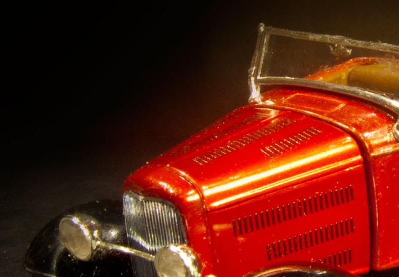

The original post was the first time I hade used them. I continue to use them and have refined my technique quite a bit. I've also been in touch with Archer from time to time pitching them on true 1/24th scale louvers that would stand higher above the surface and perhaps be available in white or light gray to contrast with darker colors. Archer say they are aware  of the 1/24th & 1/25th scale vehicle market but that the printing technology limits them to black and the current height of their details. To date, while they have released other 3-D details they haven't done any more louvers.
I measured the width of the 1/48th scale louvers that I use and, after application, they are about 3.5 mm in width. For the metrically challenged (like myself) this corresponds to 3.31" wide louvers at 1/24th and 3.44" wide louvers at 1/25th.
The next time I used them I got far better results. Applied to bare polished white resin and then covered directly with a bright metallic (in this case Testors Aluminum Plate Metalizer) they really pop and show through with no problem. This is the case with almost any metalizer type paint and with most light to medium matte finishes.
On the same car, here they are with a light dusting of color coat over them but with no clear. They show through pretty well, I think, and to good effect.
The last two times I used them was the first time I appplied them to relatively dark metallic colors. In these instances I applied my clear coats prior to doing the louver decals, did most of my final polishing and only applied a light sealer coat of clear over the decals, avoiding them for my last polish. They are in their raw black state. Here they are over a dark gray metaalic and a deep red metallic. In both cases I think they look pretty convincing.
This fall I plan to experiment with black surfaces, both matte and gloss, to see what techniques I can develop to use them. I have considered a medium gray under coat applied after putting down the louvers but before applying the black, then clearing and polishing, allowing the gray to show through the black. I have no idea how much control I will have and what the final effect will be but it's definitely worth a try.
Also very important is how you apply them. Archer has a video on their recommended technique and I highly encourage anyone using the louver decals to follow it scrupulously, It pretty much eliminates most problems with the louvers breaking up on the surface and gives you a very high success rate putting them down. Here's the link: http://youtu.be/aptnvFeEqio
