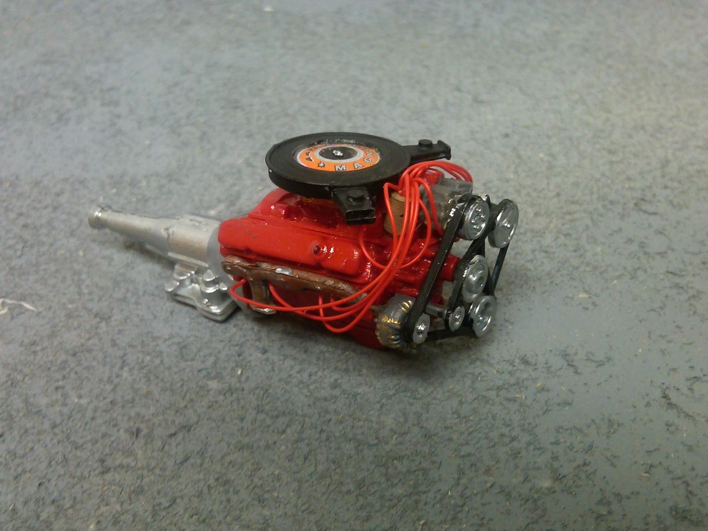

Posted 07 June 2010 - 06:43 AM
If you must make your own, please make sure they look the part! I have been noticing builders on these message boards using wiring that looks like it would be better scaled for garden hose! That is why I suggest the best way to go is to buy wire that is packaged for 1/25 scale plug wires. Not only are you getting the correct scale, but you are also helping the hobby by supporting the model car aftermarket.
guilty as charged
i admit i have found out by trial and error that certain wires are great for radiator hoses and not so much for plugwires
Posted Image
this turned out to be a better size wire
Posted Image
