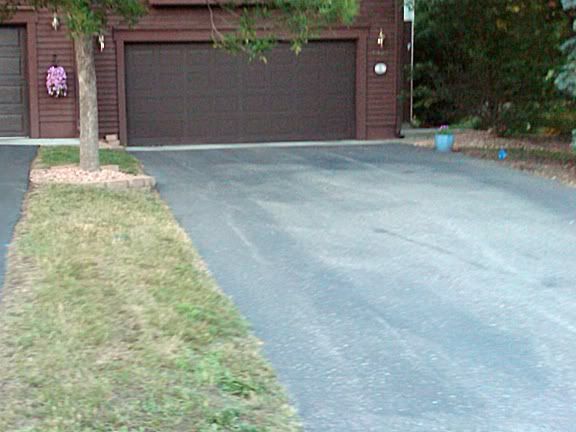

Posted 11 June 2010 - 08:34 AM
Do NOT spray the sandpaper Black. Very few driveways are true black (even fresh asphault has some Gray in it, as well as some blue hues). Instead, if you are going to use the sandpaper idea, shoot it a meduim Gray color and airbrush/cut template spray various shades of darker Grays and oily Blacks into it.
Agreed. The only time an asphalt driveway is black is just after it's been laid down. From that moment on it fades. Go with a medium gray, then use some white, black and gray pastels to add different areas of color... use your finger to smear the pastels around to create a mottled look. A real asphalt driveway (especially an old, worn one) is never all just one shade of gray.
Then use a fine brush and flat black to add a few random cracks. You can create "oil patches" by using diluted thinned black and painting random splotches on the "driveway."

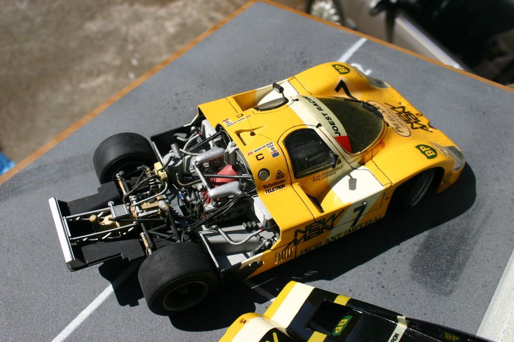

Posted 13 June 2010 - 04:04 AM
Gray sandpaper is what I used... splattered with flat black (and some white) using a toothbrush. Plus a few other "clues" for pavement (burn outs and pit marks). Really easy and quick to get realistic results.
Posted Image
Let me know if you want me to get some pix of it without the car.

Posted 13 June 2010 - 10:11 AM
^^^ Looks good John ^^^
