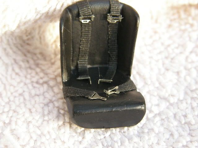

I use I.V. tape or medical tape you can get at Walgreens, and you already have some. Here are the belts in my Cunningham.
It looks almost real and this is magnified several times with my camera. It's hard to see the texture with the naked eye. That's a towel it's sitting on.
David
