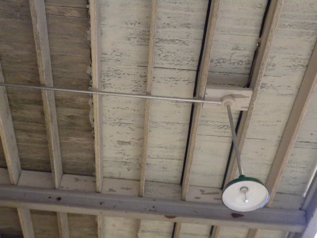

I gotta ask about the lights...I bought a pair of shades from you for my dio and would love to light them. Is the info on the functioning lights back in an earlier part of the thread? If so, I'll go looking. If not, do tell!! :)

Thanks Tony! ...the bulbs I used are "grain of rice" from Model Power #252, the conduit is made from 1/16 aluminum tubing. I could of used larger diameter tubing to make wiring easier but the thinner tubing looked more to scale. First I drilled a hole in the top of the lamp shade to fit the tube. The problem with the 1/16 tubing was that both wires would not fit through it, so I removed the insulation from one of the wires(the one I was using for ground/common) and then wrapped it around the other wire in a loose spiral. Once thought the top of the tube I separated them and soldered them to their prospective "bus" wires running along the top edge on the back side of the ceiling joists. From the side of the dio they went to an HO train transformer.
Posted Image

Thanks for the info Danny!
