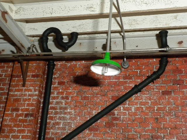

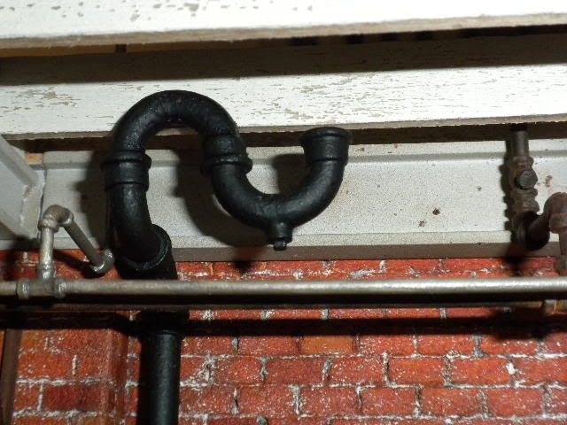

...thanks Jim, Chuck and Tony, appreciate the feed back! It feels good to be working on this again. I'm taking advantage of the spark, so I got the cast iron drain pipe started too. Not sure yet what's going on with the second floor so this is all I'm going to add for now. The pipes will get some light weathering because their inside the building as opposed to outside. Some dust, a little rust and maybe a leak or two..........after the lights and pipes get weathered it'll be on to the second story floor boards.....

Unbelievable details!!! I'm guessing the pipes are styrene rod... but where did you get the joints and bends? Or did you cast them?

That third picture above, looking up at the pipes....you'd swear it was the real thing. very nice!!!

...thanks fellas! ..appreciate the kind words.....Tony, your right, the straight pipes are 3/16 tubing from Evergreen. All the other pieces I made from scratch. I'm going to offer these and other pieces on my web site. Should have them ready sometime next week. These pipes make an interesting and uncommon detail item.........

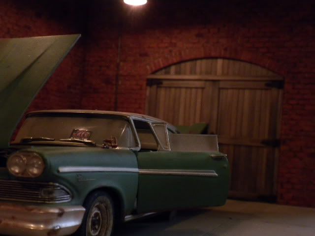

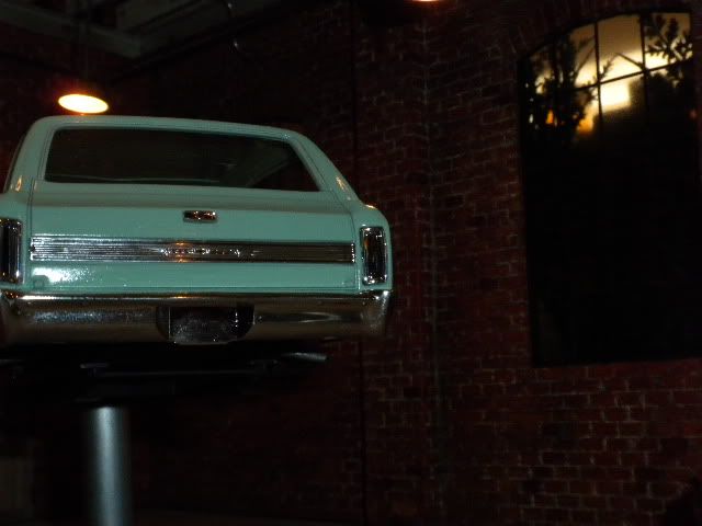

...got the lights temporarily hooked up....took a couple quick shots.....

Man, those lights sure set the mood, don't they? Wow...fabulous!

...thanks Tony, I really wasn't sure how all the lights being on together were going to work, but was pleasantly surprised at the effect.

Fantastic. The shot with the two cars in there really made it. Very nice work.

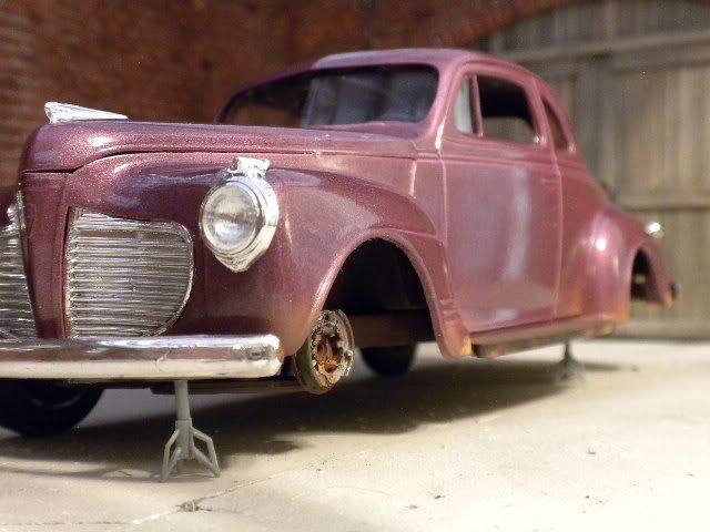

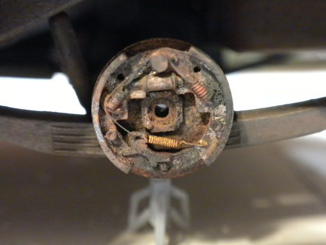

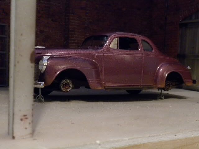

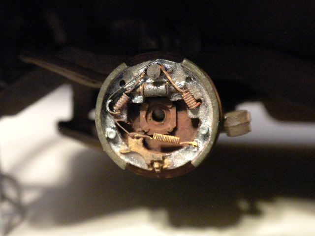

..got started on the detail work for the '41 Plymouth. It's going to be poised having a brake shoe change. The front shoes have already been swapped out. To save money the mechanic used the old springs and hardware. I guess the owner is a money miser! The rears are next. The front spindle and rear axle shaft will be put on once I get them weathered. Still need to weather the car a little more with some dust and a bit of road grime. The plan is to have the wheels and tires, tools, old and new shoes and other detail items laying around the car also. More to come, thanks for looking in.........

Danny...I have followed this from day one. Your additions and creativity is outstanding and should be an inspiration to all! I for one am truly inspired but my time is so limited at this point. Now...just how did you create those wheels with brake shoes and springs? Thats really cool...as is the pipes and lighting and heck,just everything !! What is the overall dimensions of this Dio ? Good Stuff is all I can say.

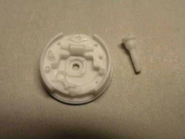

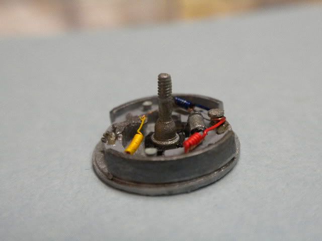

..Vaughn, the brake shoe assemblies I make and sell on my web site and E-bay. They don't come with the springs but are not hard to make. I use .008 brass wire for the main return springs, .005 brass wire for the adjuster spring and .003 magnetic wire for the cable to the adjuster lever. I simply wrap the wire around different size piano wire then cut them to length.
The pin at the top of the assembly is a standard straight pin with the head filed flat. For new looking sets I just paint them, for weathered ones I use rust colored paints and powders. The over all dimensions are 25" long x 12" deep x 10" high. Here's a couple of pics of the brake assemblies.....
