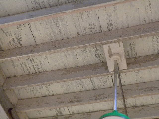

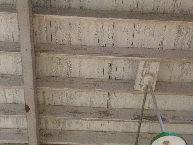

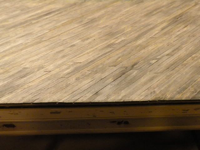

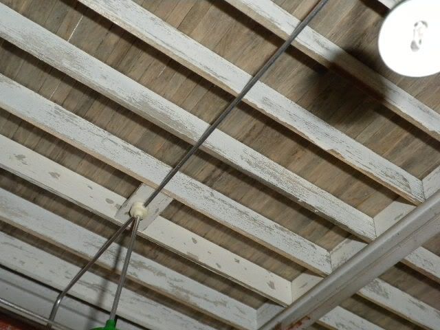

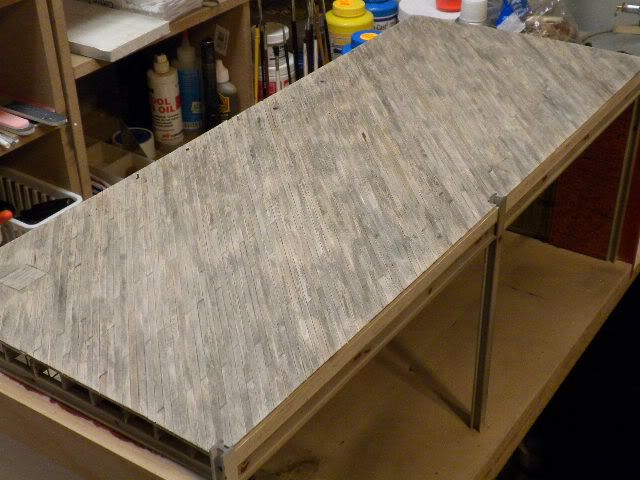

....got the ceiling/upper floor started. I angled the floor boards like the ones I remember from the factory I worked in, and that was constructed around 1911, so the time line is close. I have the ceiling boards running perpendicular to the ceiling joists. Those boards will get the peeling paint effect like the joistshave. Not a 100% sure yet what I'm doing with the upper floor yet. Thinking about an abanded small parts factory that is now a storage area for car parts, we'll see..........thanks for looking...

Danny... with the greatest respect.... and I maybe wrong....... but I believe you may have the floor upside down. From my experience as an architect and property developer, all the structural floors I have seen in old warehouse type buildings, have the main floor boards running diagonally on top of the rafters and the finished floor boards running perpendicular to the building walls.
Your work is unbelievable and I am in great awe of your talents, so I have hesitated to mention this..... and perhaps it has been done in the way you have shown in real life in some cases.... but it may be an idea to double check.
Even in my own house, which is over 100 years old, the second floor is built the way I have mentioned.
I'm getting old and perhaps my memory is fading... but please check it out before you get too far.
Tony
Thanks Tony, I appreciate you mentioning this. The way your describing the construction does make sense, and being an architect, I have no doubt your right. Gotta admit I didn't research this much. Just went off memory from the plant I worked in. That complex had over 45 different buildings most being constructed around 1911 to 1913. For what ever reason there were certain areas of the plant where the floors were diagonal and I always thought that looked pretty neat, so I went with it on this. Now I wish I would have inquired about this before stating my floor, would definitely do it the other way. But after gluing over 600+ boards I don't have the gumption to change it!..lol For now anyways I'm just going to hope most people don't notice this detail flaw!

...I decided to do a little research on the flooring. Didn't get a great lot of info but there was plenty of pictures with them done both ways, diagonal and perpendicular. Perpendicular was definitely the most common. I just might have to reconsider the floor after I discovered that the diagonal flooring in all the pics I found had flush cuts not angled cuts. Looks like I've learned a couple of valuable lesson here...first..don't rely on just your memory if your like me and can't remember sh..stuff...and second.."take the time to research!" if you what to be fairly accurate. The plan is to enter this at the Detroit DAAM show April 3rd. But with so much to do to get this ready by then, it looks like a new floor will have to wait till after the show.....at least I have some experience at gluing hundreds of coffee stirrers!

One more comment and then I'll shut up!
The main structural floor boards were usually done diagonally, to add rigidity to the floor. The same theory as the triangulation in a sports car or race car frame. Sometimes these structural boards were just left as the finished floor above. That's why, on a single structural floor board construction you would see diagonal floor boards on the second floor and dust coming from between the floor boards below as they shrunk after being installed over a period of time. There were probably exceptions to this rule, as many buildings were constructed by unqualified contractors who didn't always understand structural theories and there was no building dept. authority until the early 1900's to monitor the contruction.
If they added a finished second floor (which wasn't usually done in old warehouses), the finished floor boards would then be laid opposite to the direction of the structural floor boards to create more rigidity or even just for appearance. Sometimes a diagonal finished floor would be added over the original perpendicular floor to either create a more rigid structure and/or to create a more aesthetically pleasing finish to an upper floor, where offices may be built.
Whetever the origin of the floor in your building, Danny, I certainly wouldn't change it at this stage of the dio. No one can say for sure that your building wasn't built the way you've shown it! And after laying over 600 individual boards..... you've got my total respect, just for that achievement alone!!!!
Keep going my friend... and if anyone ever does ask (which I doubt), now you have a little background information to baffle them with!!

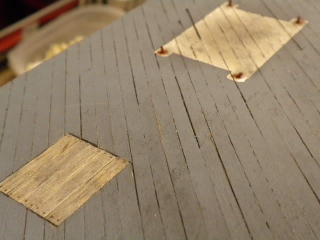

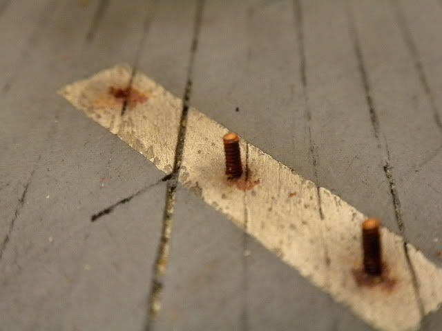

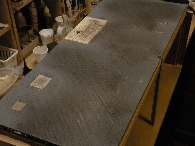

....a couple up date pics...started the weathering on the sub floor boards, hope to have that done by tomorrow. Then it's on to the main floor boards.....the show is this coming Sunday. Trying not rush through this but I'm hoping to get a lot done this week.....

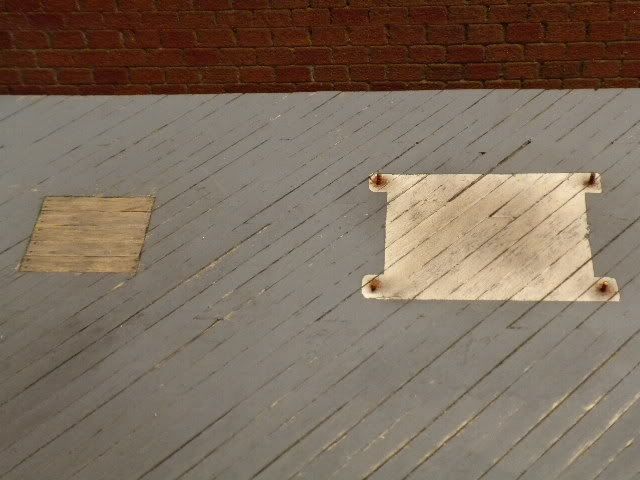

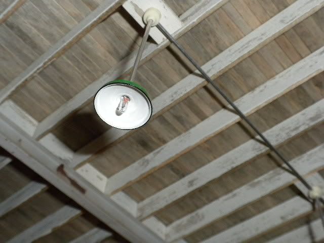

..here's a few more progress pic's.....the upper area was a small parts business that's been long gone.....machinery and tooling have all been removed....

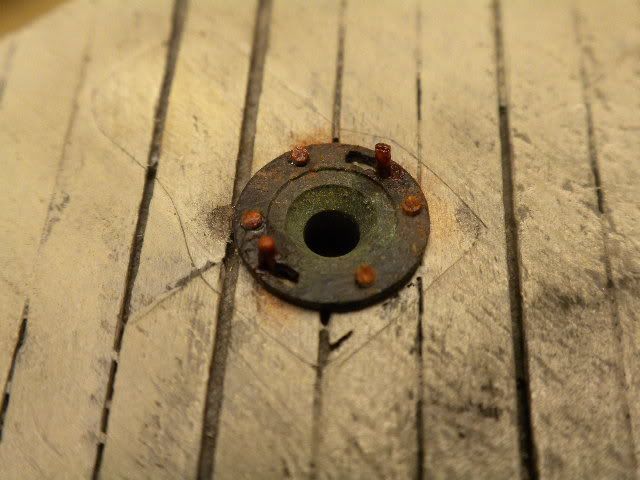

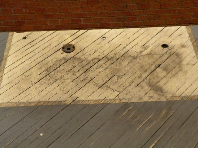

...a couple more....the old bath room.....
Posted Image
Posted Image
..this is about as far as I'm going with the upper floor till I figure out what I want to do with it......
