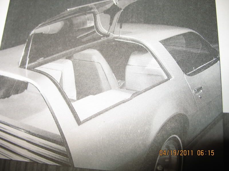

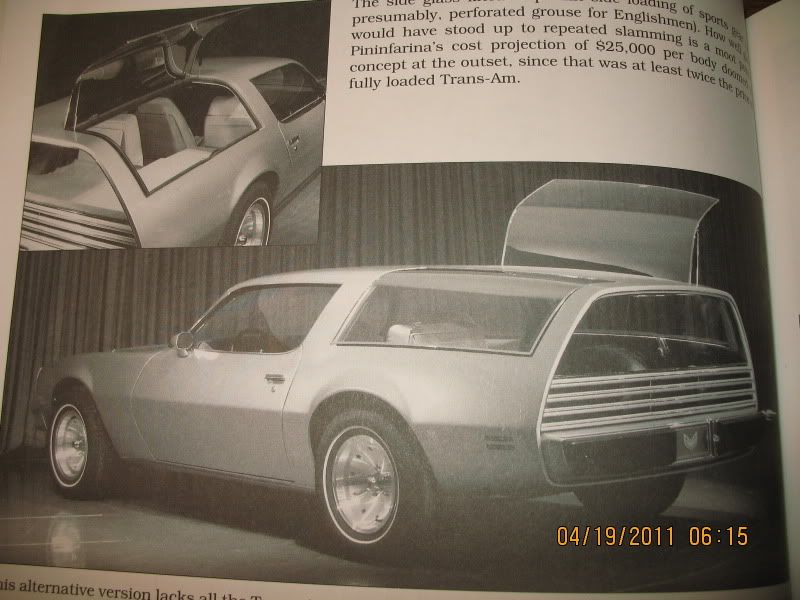

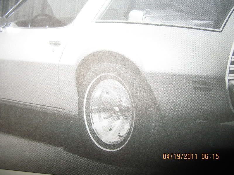

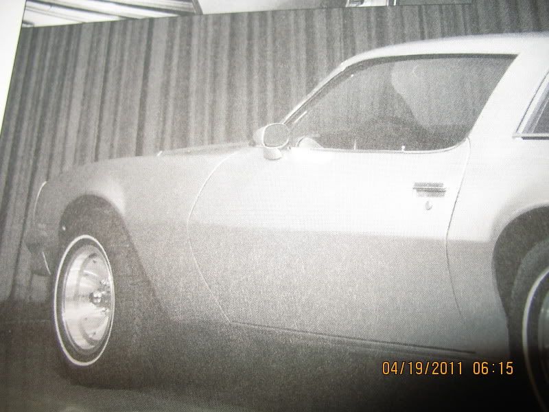

If you can find it, there is a book on the history of the Firebird Trans Am's from 1969 to 1999 written by George Scala and Wallace Wyss. It includes the history of the K-Type. Interesting side note, the first K-type was built in 1977, it had a standard non shaker hood, no flares, standard Firebird front fenders without the T/A scoops, and it had custom aluminum deep dish wheels that have what look to be 1/2 inch holes drilled in them. According to the book, Pininfarina's projected price estimate would've cost(in 1977 prices) $25,000.00 per body, Twice the price for a fully loaded Trans Am.B)
According to the book, an after market company in California offered a package to convert Trans Am coupes to wagons...
Hope this info helps a little bit

Thanks for the info. The earliest pictures I have found are of the '78 version before it was re-built for the '79 year so that is what I am trying to replicate.
The wheels and tires in 1/18 scale are going to be a problem, I have not found the perfect combo yet and shudder at the thought of trying to re-work the facets of the wheels that I have. They (the facets) appear to be the proper design but are cast too thin and go into the centre too far (sigh).
Link to comment
Thanks a bunch! This forum and you guys are the greatest. I could turn those wheels out on my lathe (if I had to!) One more set of tires added to the mix. I am going to carry on with the later version if I can if only because I think it a little cooler! Thanks again.
