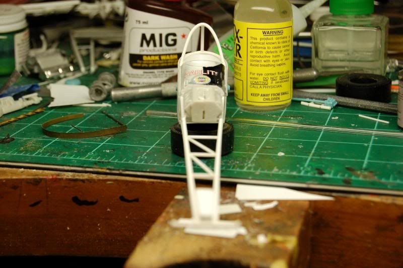

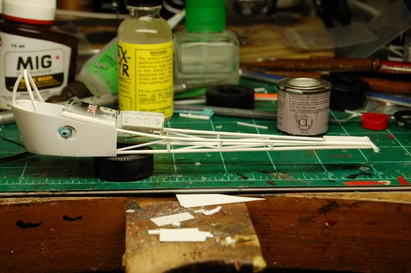

OK guys heres a small update on the car.
Built the body, fuel tank and seat pan out sheet styrene added a few more tubes to the chassis and wound up using the cowl from a old cobbled garlits FE rail. Building the frontend and wheels next.
Thanks for looking
Posted Image
Posted Image
Posted Image
Posted Image

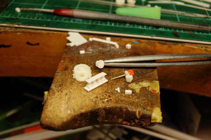

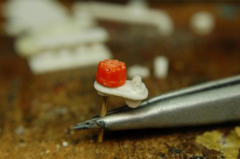

I built another Cirello "Frankenstein" Magneto. Very popular Mag with the fuel crowd. Surprisingly, I haven't seen one in kit form so I built one.
Posted Image
First I cut up the materials I needed.
2" strip of .022x.022
7mm piece of .10x.20
4mm piece of .080 half round
small piece (drop) of.060 round rod.
Posted Image
round off the four corners of the .1x.2 take the 2" strip and glue it around the edge of the piece you just sanded. Take the half round and glue it at one end on the bottom to replicate the curved bottom. next take the drop and glue it above the half round and drill it to accept the coil wire. now at this point you will need to find a dist cap and glue it above where you'll need to drill the dist for the drive shaft. drill the cap..
the plan is to use an aluminum sleeve over the brass rod. you can use a piece of 1/16 rod for the shaft, the choice is up to you...
here you go, Pics are worth 1000 words to me.

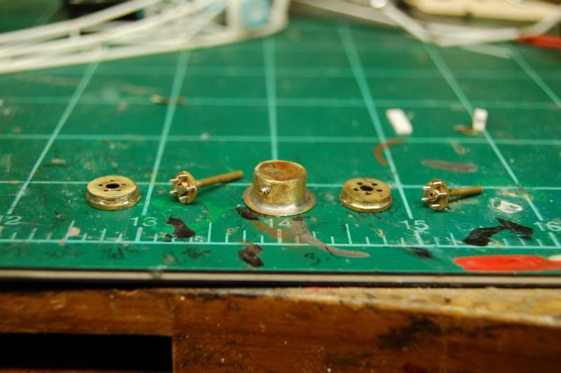

here's the fuel injectors, pump and fuel blocks.
Posted Image
Posted Image
Posted Image

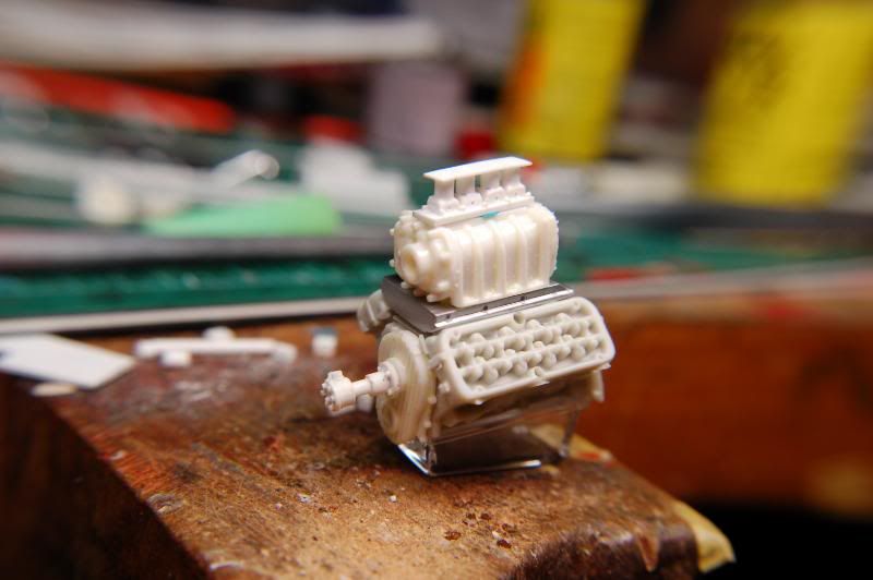

heres the motor mocked up
Posted Image

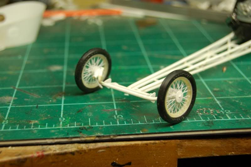

Been a while guys and I haven't forgotten about the tutorial. With temps near 100 and a heat index of 109 Ive put the 1:1 away for a while and got back to my surfers car.
Hand laced rims
Posted Image
Posted Image
Built an axle for it. Went back to basics on the front axle.
Posted Image
did a small amount of brass work
Posted Image
