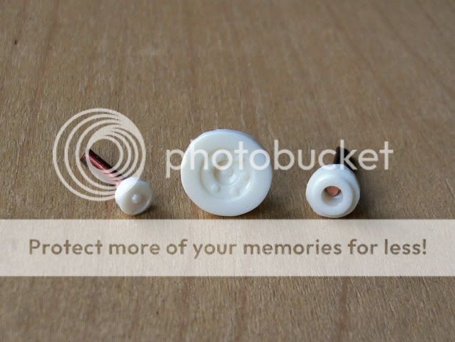

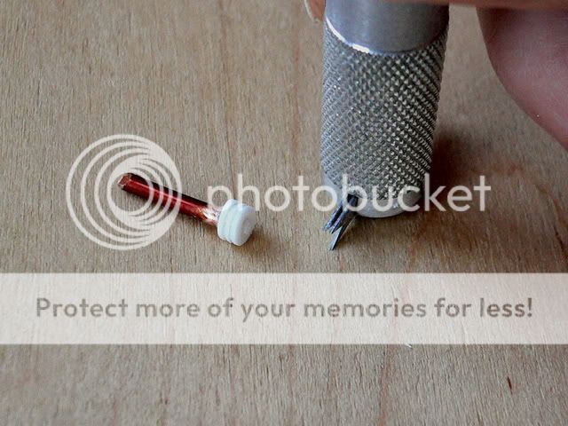

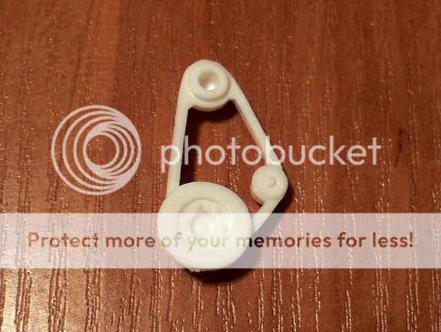

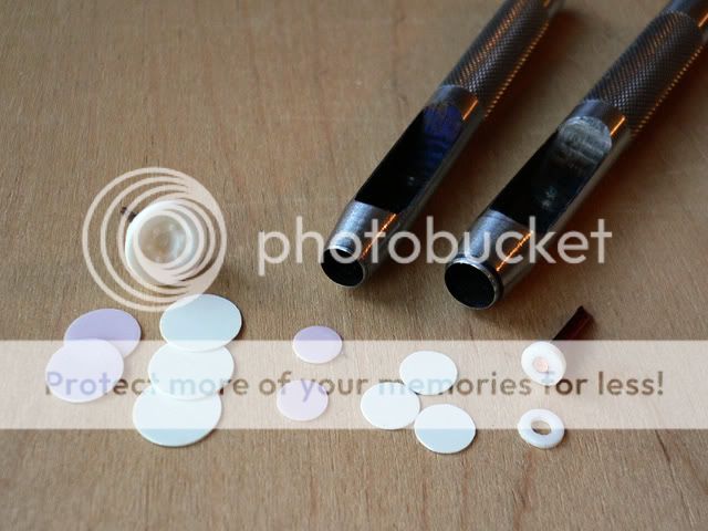

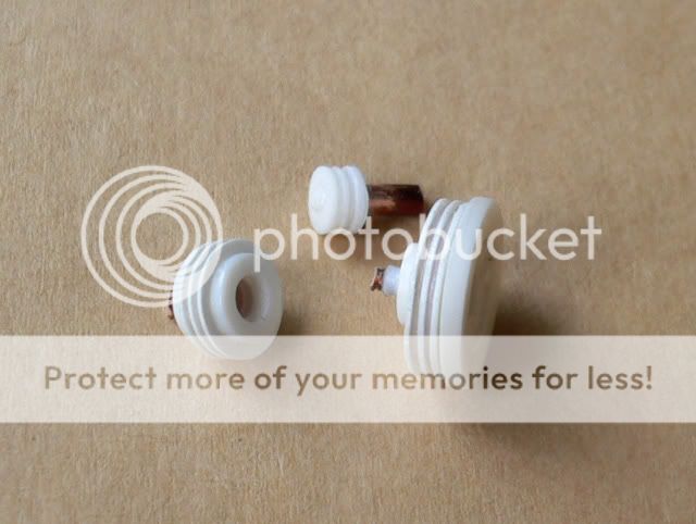

I decided to improve pulleys.
Posted Image
Cut off the belts.
Posted Image

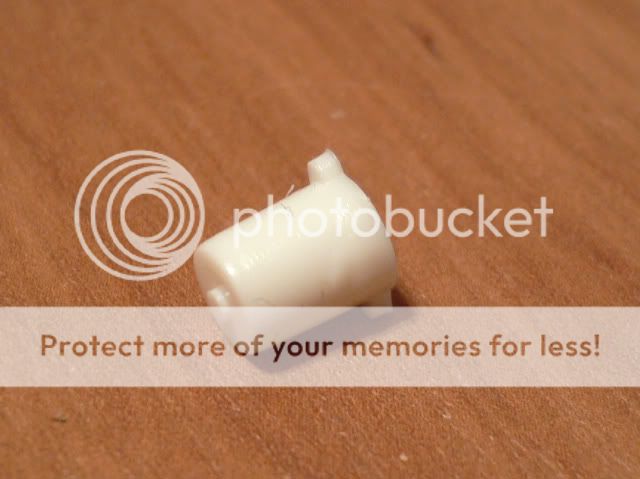

Alternator pulley was turn using power drill and device on photo.
Posted Image
The rest of the pulleys were partly punched from styrene.
Posted Image
The result.
Posted Image
Alternator seemed too simple.
Posted Image

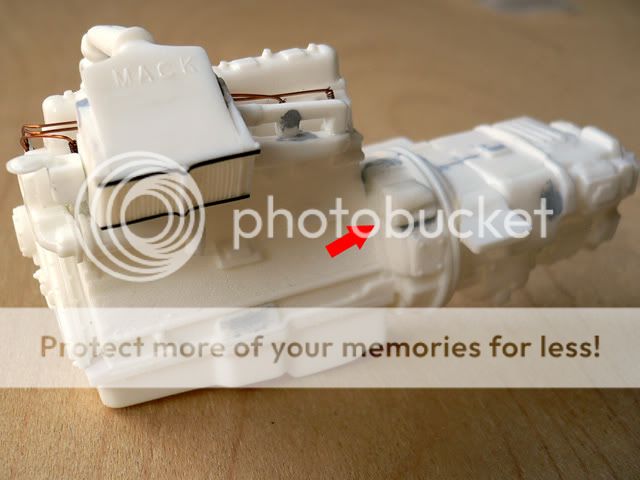

So it was altered with one more lug (marked with arrow, flywheel (on the left) and bracket(on the right).

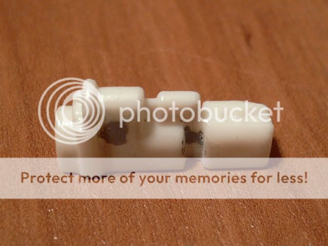

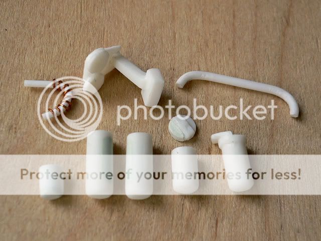

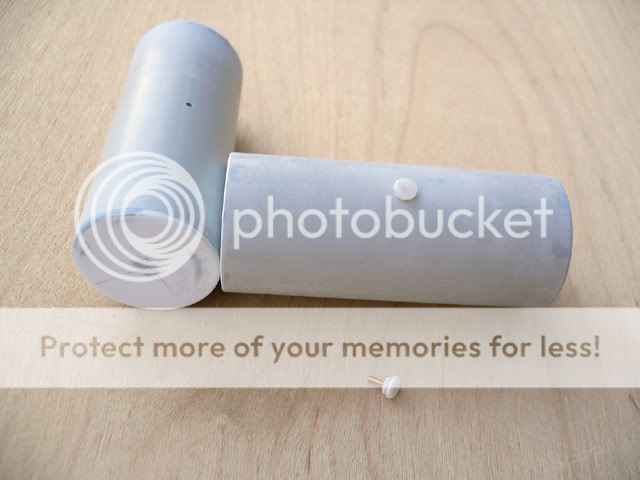

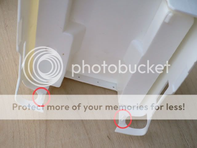

I cut off the part, which will be painted with the engine
Posted Image
...and added some detailes to unit:
Posted Image

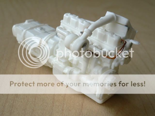

The engine (not finished jet):
Posted Image
Posted Image
Some parts are not glued because they will be painted seperattely in a different color. Filters were cut of brackets by the same reason.
Posted Image

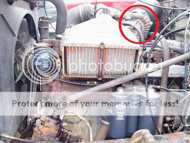

Up on the right is the tube locating above the valve cover. Up on the left is reinforced tube surraunding air filter hose:
Posted Image

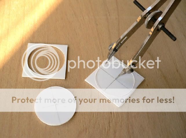

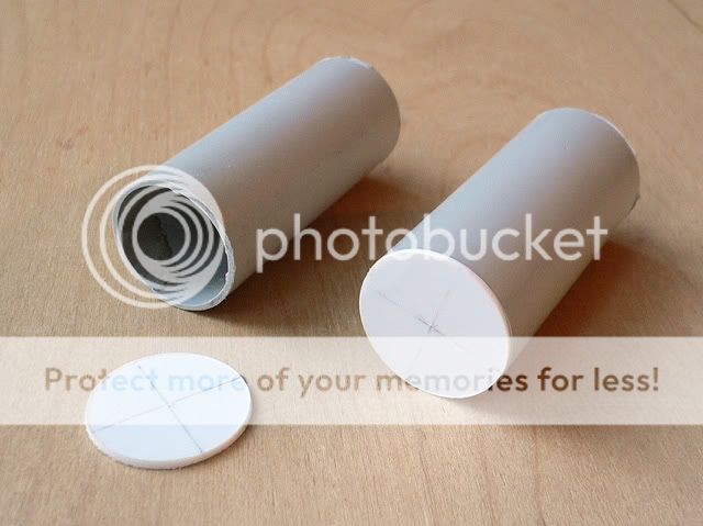

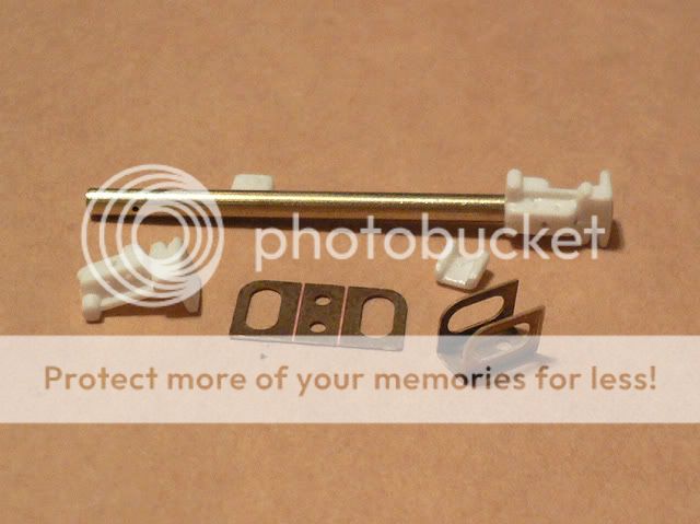

Kit radiator suffered form lack of rim on the back side. I used 25mm plastic tube to cut a short piece for radiator. By the way, this tube will be used to make fuel tanks.
Posted Image
The hose between air cleaner and intercooler proved to be too short. I plan to cut it and insert pieces of aluminum tube 6mm:
Posted Image

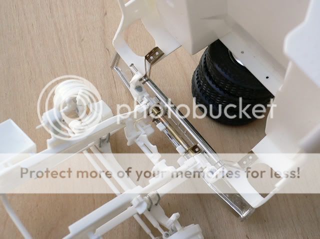

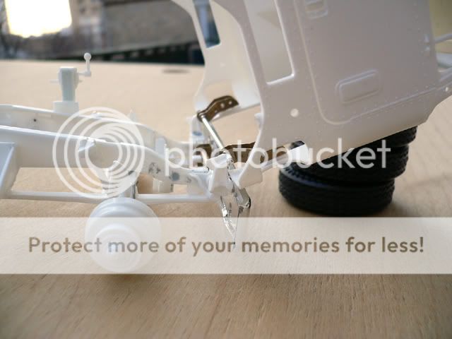

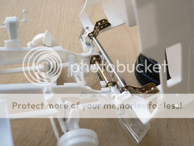

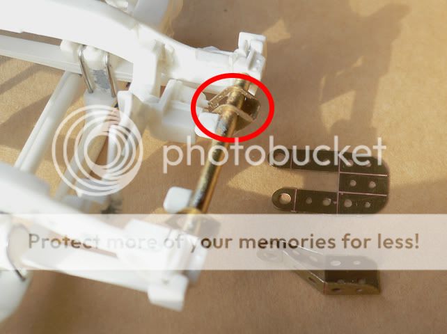

First cross member will be replaced by brass tube (on the left) because it will hold bull bar hinges.

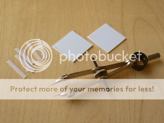

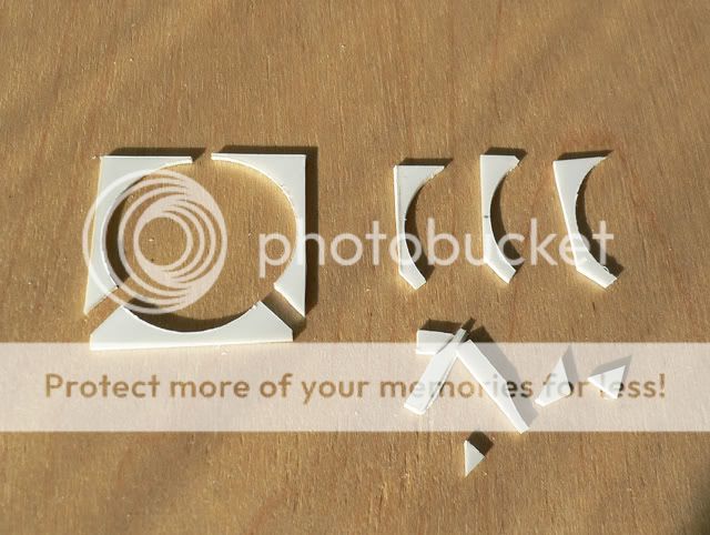

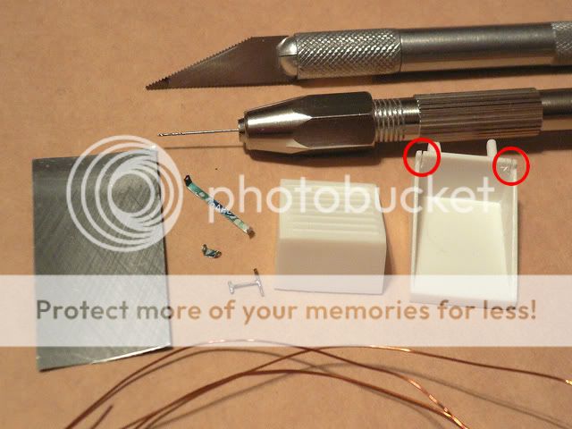

As I mention before the tanks will be replaced. Tank brackets too. Here are the tool and materials for that:
Posted Image

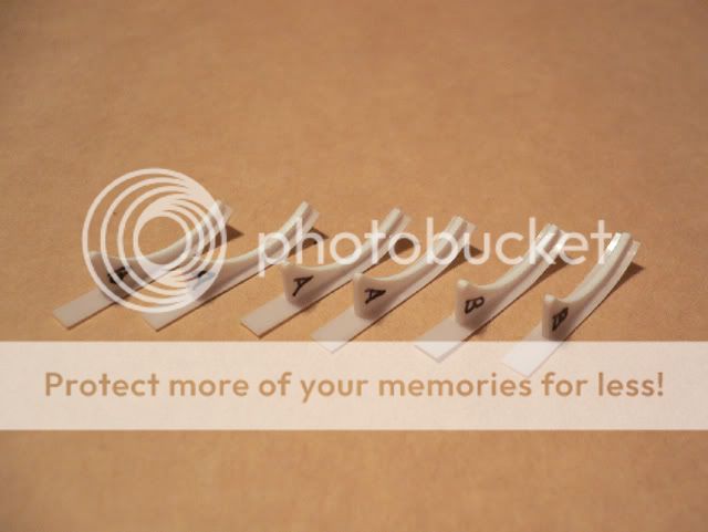

Here are the tank side pieces:
Posted Image
I used the rest of the material for tank brackets:
Posted Image

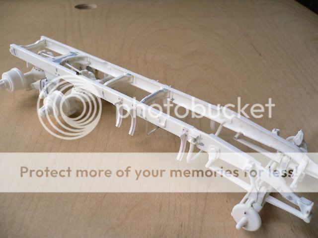

Fuel tank:
Posted Image
Fuel tank brackets:
Posted Image

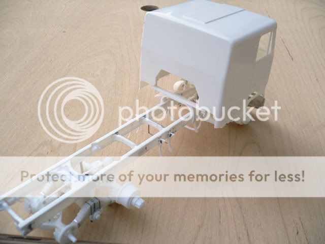

On the frame:
Posted Image
A photo of the real frame to compare:
Posted Image

Posted 19 March 2011 - 12:11 PM
Sergey
Nice detail happening here, with some nice attention to detail
One thing most people leave off when detailing a engine is the clutch assembly on the gear box
and when you do the tank straps for the tanks, they also have a rubber moulding under the strap in most cases, some custom trucks don't have these
I attached a pic of the KW version of these straps, and a pic of the 1/16th version that I cast in rubber so you could see the result
I really like the pulley detail, they really come up great, will have to use that idea myself
Look forward to another update
