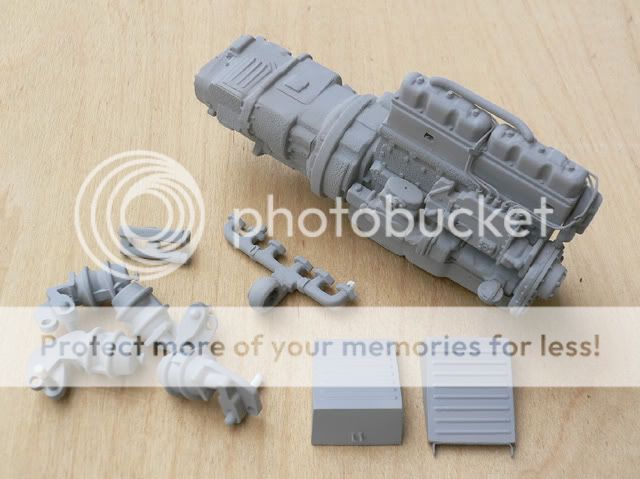

One thing most people leave off when detailing a engine is the clutch assembly on the gear box
Thank you Tony. Do you mean a rim around engine/gear box joining? Thank you again. I was not sure about it. I guess I should file the rim off?

The rim around the gearbox is fine, as it has some of the bolt detail, I would whoever fill the gap between the box and the engine to smooth it off, as between both is a flat area, if you can understand that, will see if I can find a picture,
as for the gear box clutch assembly, that is the fork that operates the clutch, it has a hydraulic line that runs to it, and a slave cylinder that operates a fork arrangement will find that pic to

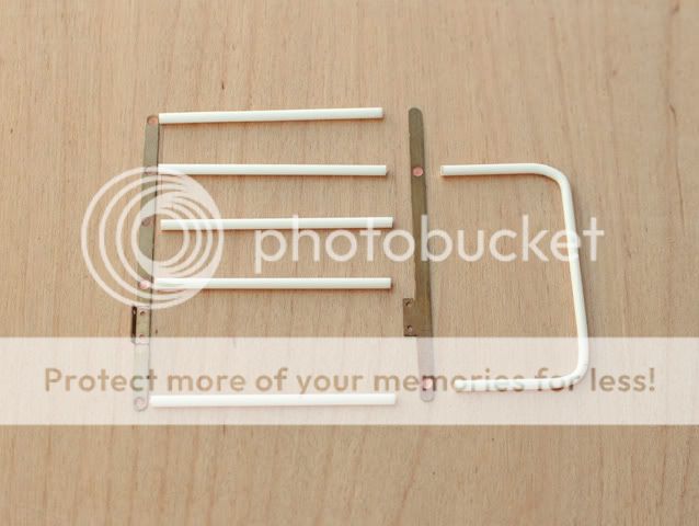

Meanwhile small update:
As acumulator box consists of two halves I decided to detail it a little. Sprite can tin and cooper wire were used. Also drill bit and model saw:
To start I made sawcut in the bottom half (marked with red circles). Hinges are made of tin. Lockers are soldered wire.
Here how it will open:
... and close.

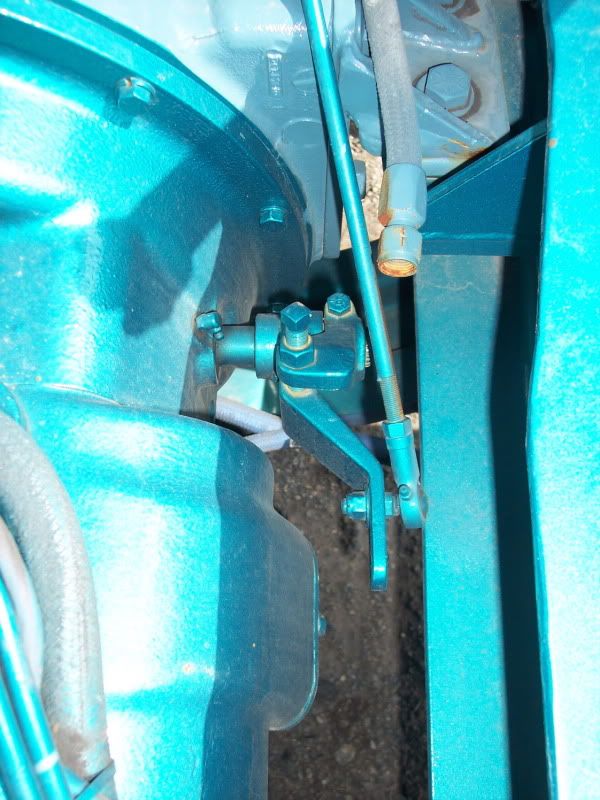

#57 Tony Bryan
Tony Bryan
  • PipPipPipPipPip
  • 361 posts
  • Location:Sydney,Australia
  • Full Name:Tony

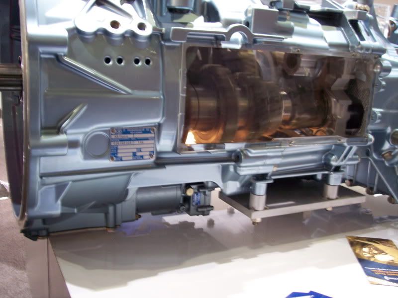

Posted 14 May 2011 - 01:50 PM
Hi, Tony!
Have you found pictures of the gear box clutch assembly? I would use it as reference.
Sergey
I have over 20,000pics, of trucks and machinery, not many are in folders, one day I will fix that
Here is the better pic I have, this shows the fork in place, what it does need is a way of engaging the fork, this is done either by air or hydraulic ram or even mechanical means
you can just see it behind the bell housing
Posted Image
A better pic of the ram set up
Posted Image
You could build what ever you like here and it would still look the part, as not many people add this,
I have other modern detailed pics of a road ranger box from a truck show if you need other detail pics
Hope these help
I also had the opportunity to photograph a W model Kenworth , which I took 300 pics, this was in a re build stage,
and it was a perfect opportunity to take a lot of detail shots
A W Model setup, with a series 60 engine, note how clean the joining of the box is to the engine, and the Mech clutch
Posted Image
Hope these help
Tony
