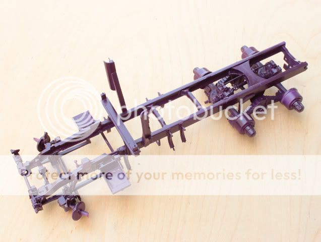

I wasn't wasting my time. Here is the chassis in color:
Posted Image

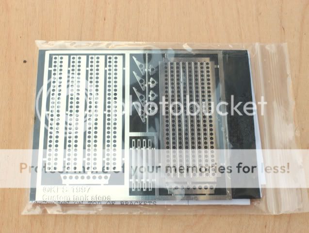

This fuel tank steps are came from KFS
Posted Image
