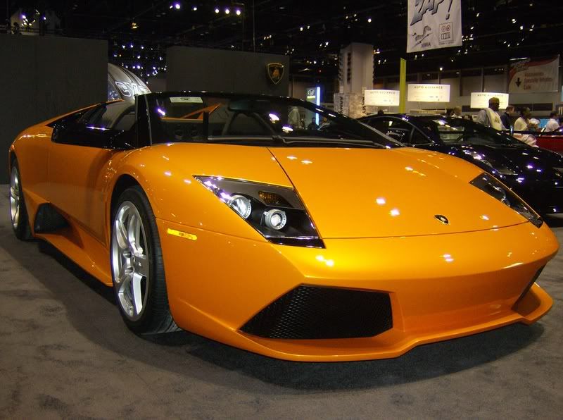

Awesome! Thanks guys, that helps a lot. I think i need to get an airbrush and start playing around with it. As far as color goes, the closest thing i found online was this lambo: Posted Image

What you should look at is HOK by Black Gold.
The color you show is a cross between HOK Tangelo Orange Pearl and Sunrise Yellow....Both come in rattle cans...
