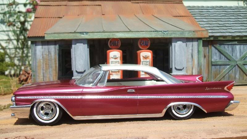

Microscale makes a foil glue, you can find it at your local hobby shop. I just finished this 60 Impala a couple of weeks ago, I used the new improved chrome,it worked great.
RAMSMeetingAPR_72011009-vi.jpgHosted on Fotki
RAMSMeetingAPR_72011012-vi.jpgHosted on Fotki
RAMSMeetingAPR_72011013-vi.jpgHosted on Fotki
