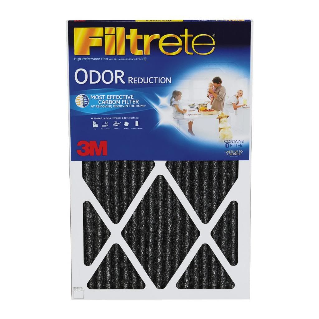

One of the big projects I was working on before I stepped away for awhile was this booth.  In the new house, my hobby room does not  have a window.  My plan to get around this was to use carbon filtration to trap the VOCs and odors.  The big hangup back then was the fact that these activated-carbon filters were still a relative niche item and the only reliable source I was looking at would be Grainger.  This carried a pretty healthy premium at around $30 a pop and you had to order a multi-pack to obtain them.
That all changed tonight when I had to stop by the Walmart on the way home from work to pick up some filters for the house.  Up on the top shelf, I found these:
Carbon filtration has finally hit the mainstream and they aren't too expensive at around $16. As I illustrated in the OP this is the second stage in my stack of filters with primary filter above this one in the stream to capture the bulk of the overspray.  That method should protect this one from having to do much more than just capture the nasty, dangerous stuff.  I built in extra airflow capacity by going with the larger Dayton blower to account for the multiple stages of filtration and the expected resistance. I'm really excited now to get my booth finished up so that I can prove my concept correct.

Posted 11 July 2013 - 08:58 PM
All Right!! Another 3M product being used in modeling!! Great choice ;)

Interesting thread! A year ago, I moved my family from a large home in the Northeast to a 2 bedroom apartment in Central Florida.  Prior to the move, I had begun construction of a downdraft booth with a Grainger sourced Dayton fan.  It is a down draft booth, designed after reading Klaus's articles.  The booth is made of plywood, and has an open plastic grid from a fluorescent light fixture that allows a large amount of air to from down to the filter.  I like your idea of a carbon filter, as venting the booth to the outside can be a challenge in the small apartment.  I will look into the filters as an alternative!
