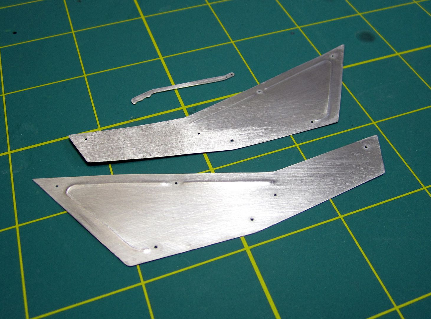

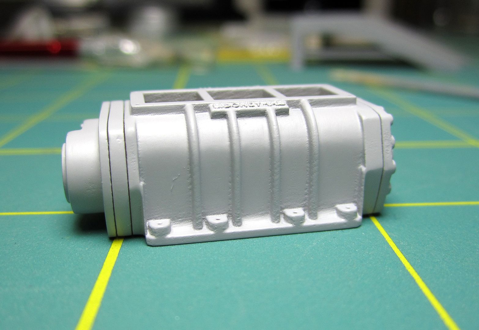

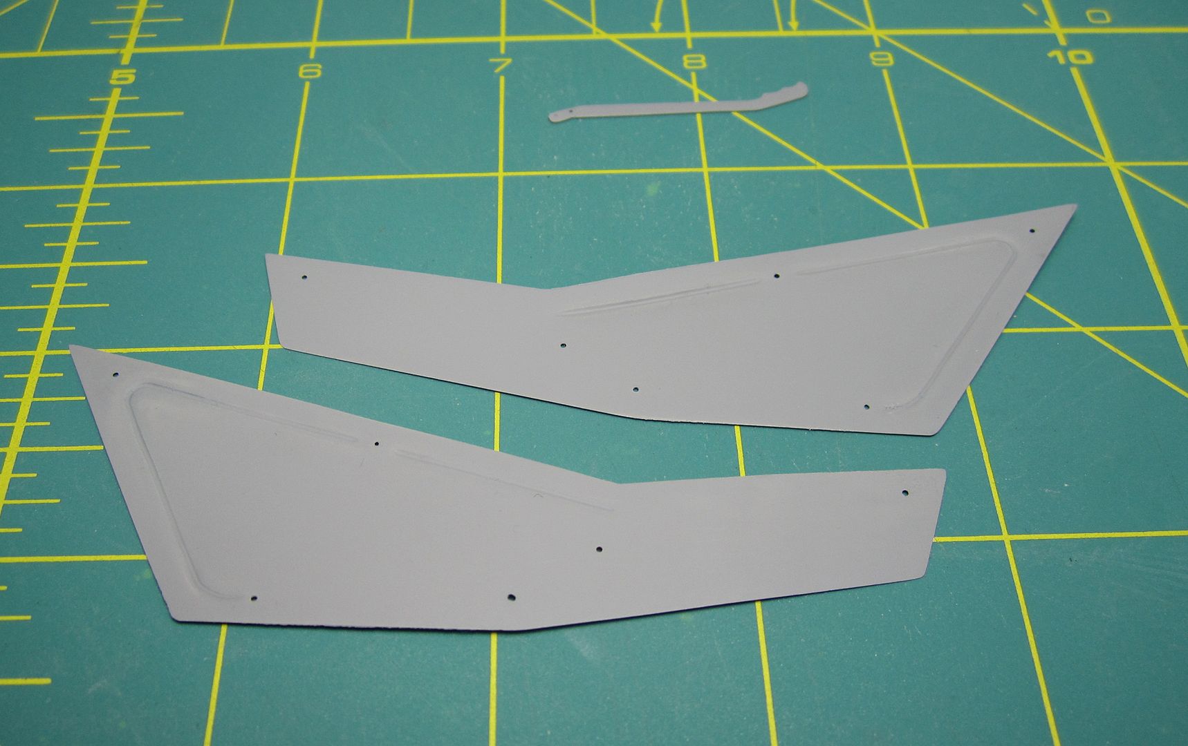

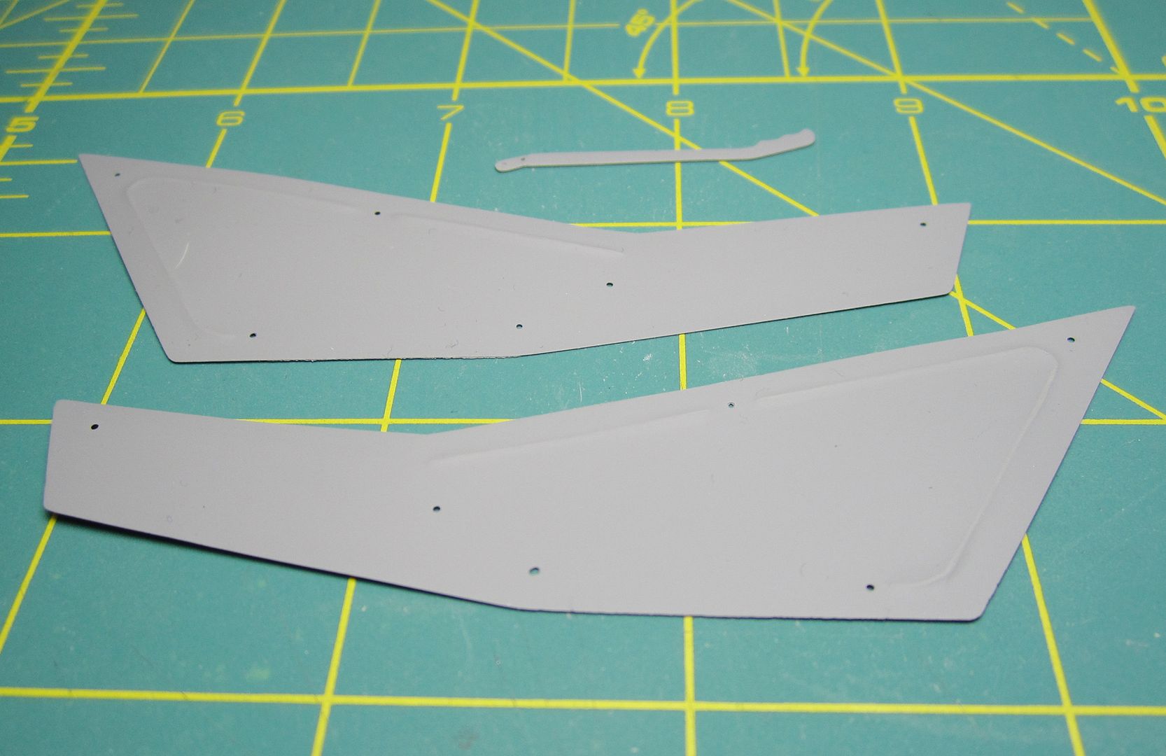

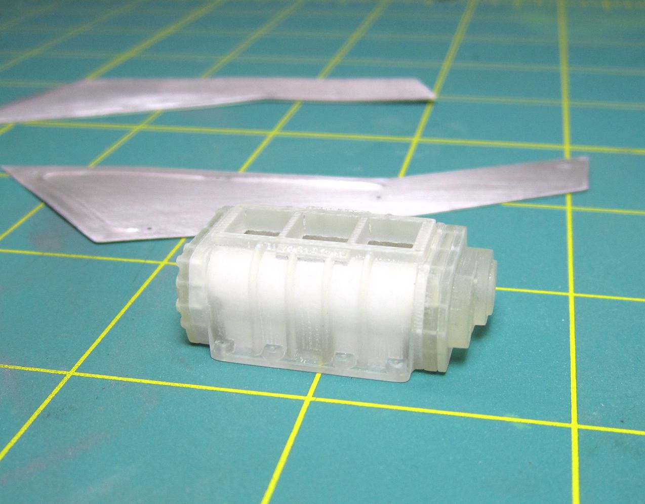

Mooneyzs Posted January 2, 2015 Author Share Posted January 2, 2015 Well Fellas... I have finally gotten back to the bench now that Christmas and New Years is past us its time for quick update. I have started to fix the chassis tins. I got the side tins stripped and read for primer as well as I got the blower sanded again and a quick coat of primer, which reveals more sanding in my future...lol. Anyway gonna be a weekend that I pretty much will be building for most of it. Hoping to get some good progress this weekend. Here are some pics... Well here are the side chassis tins and the brake lever. I tossed them in a jar of lacquer thinner to strip these. Now just a little sanding and they will be ready for primer: Here is the blower once again. Last night I spent at least and hour and half just sanding this part. What tedious work...lol: I got the fuel tank reprimered after installing the supply port. only to notice that I have a little more body work on the thing: After all of that sanding on the blower. Once I primered it thought it would be good. But no... More sanding in my future....lol I think I am gonna be sick of sanding this one part very soon... hahaha : Quote Link to comment Share on other sites More sharing options...

gasser59 Posted January 3, 2015 Share Posted January 3, 2015 So glad to see you back on this buddy. Those tins came out better than I thought they would. Quote Link to comment Share on other sites More sharing options...

Mooneyzs Posted January 7, 2015 Author Share Posted January 7, 2015 John... Thanks Brother. its feeling good getting back to the bench. Tim... Thank you so much. Brad... Thank brother. yeah they were a little better than expected. Just had to do a little sanding to them. Mike... Thank you so much my friend. Happy New year to you too. Paul.... Thank you so much on that. I do have to say some of the clean up is tedious from Shapeways but would be easier if I didn't have all of those nooks and crannies to sand in....lol. I never knew which type of technology that shapeway uses But I know the Frosted Ultra Detail is UV cured. I do know someone with a Labforms printer. I may have to talk to him and see if I can have him print me a part to check out the quality from it. Danno.... HAHAHA I think you are right that it got stuck with the rest of the spam... Hakan... Thank you. Randy.... Thank you. Yeah the sanding can be a drag but all of the hard work on prepping it will pay off when its time to paint it. Its not hard sanding it but more rather that I am folding pieces of paper up and using my tweezers to hold the paper to sand. Think I need to come up with a better method Dave.... Hey its great to hear from you. Thank you. You know I have to be honest that I never read the label on the super clean. I have had no problems with it when I have stripped plastic parts. but its a lesson well learned and hopefully with me posting what happened it will save anyone else stripping aluminum parts...lol Dave.... That would be awesome to have a miniature media blast booth...lol.... Maybe I can just borrow Mr. Teresi's little minions and give them some sand paper to sand away. Although I have heard that they can be expensive to rent.... hahaha Quote Link to comment Share on other sites More sharing options...

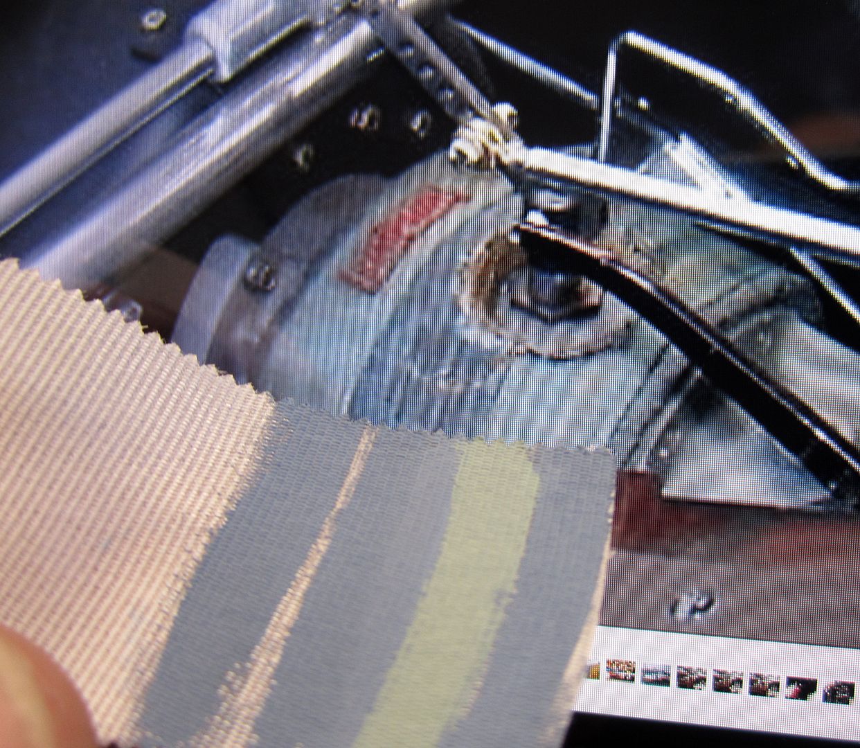

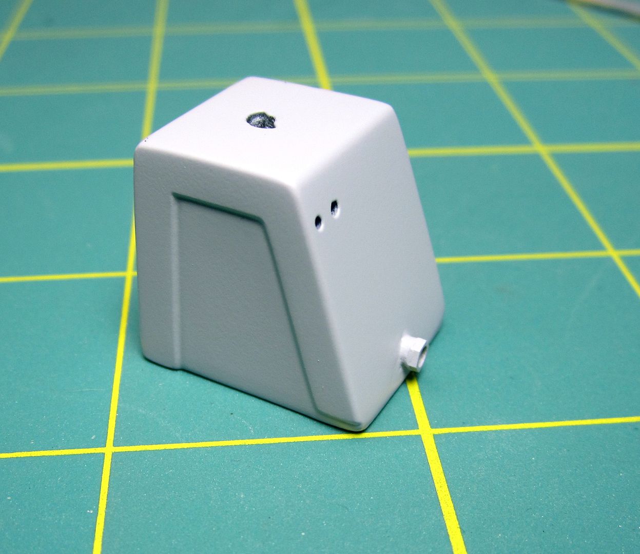

Mooneyzs Posted January 7, 2015 Author Share Posted January 7, 2015 Ok Fellas... time for a little update on a few things. Did a little work over the weekend. not as much as I was hoping though. Anyway I will just show the pics... I started messing with some colors for the transmission blanket. I picked up some Vallejo paint from Hobby Depot which is a local hobby store I get most of my supplies from. These were the colors that were painted right from the bottle to see how they looked. I picked up some black and white that I will tint to get the right shade I am looking for: This is the same paint with different lighting. I definitely need to do a custom mix: I got the tins primered over the weekend: Here is the backside: And for a sneak peak what I have been doing since I got home from work, I will show a few more pics later when done: Quote Link to comment Share on other sites More sharing options...

Codi Posted January 7, 2015 Share Posted January 7, 2015 Chris, I tip my hat to your never ending pursuit of true replication / perfection. I never would have thought about the color of the trans blanket to be honest. I'm especially jealous of the fact that I see paint and an air-brush in your post. It's 24 degrees here. UGH! And your tins look good too. Cheers, Tim Quote Link to comment Share on other sites More sharing options...

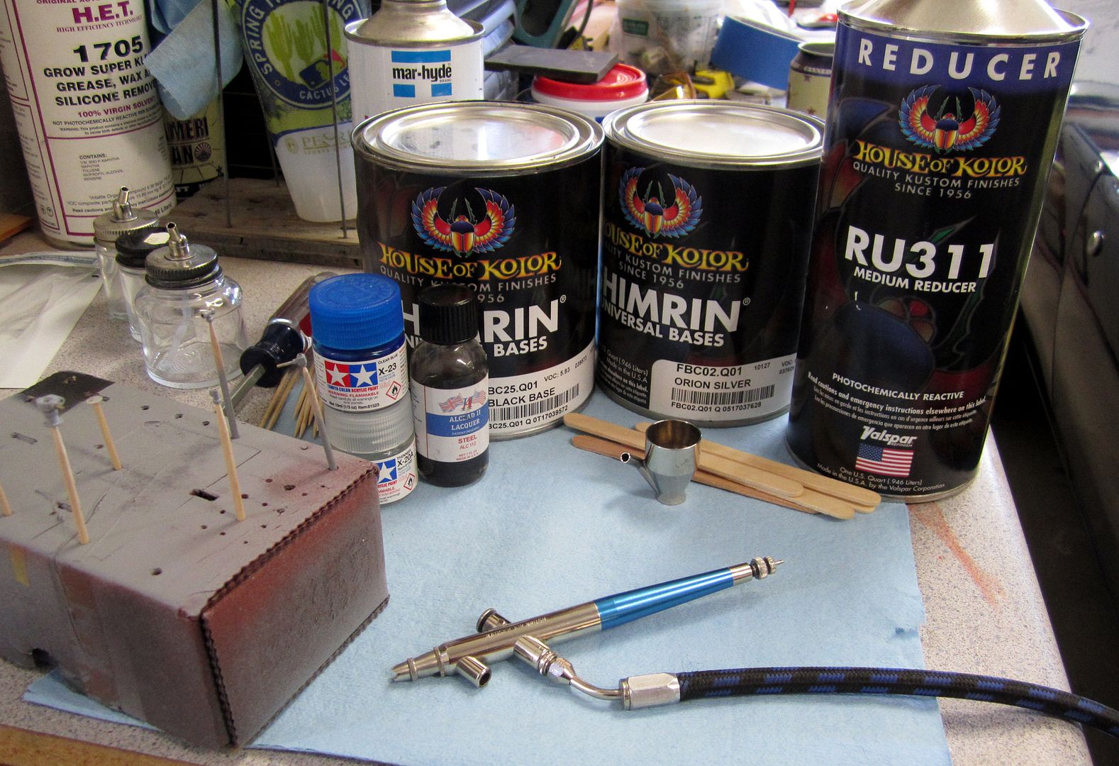

Mooneyzs Posted January 8, 2015 Author Share Posted January 8, 2015 Mitch... Thank you for the kind words and you are right that I don't need to be beating myself over things...lol. Sorry to hear about the body on your funny car. Tim... Thank you very much for the kind words. I guess I was trying to capture every detail I could to make this look like the replica with trying to match colors for the transmission blanket. Oh wow its very cold for you guys there. It was about 65-70 degrees here yesterday when I sprayed my parts. I wanted to paint a week or two ago but it was in the 50's and tool cold to spray. Quote Link to comment Share on other sites More sharing options...

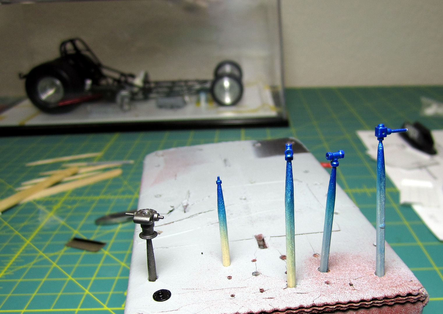

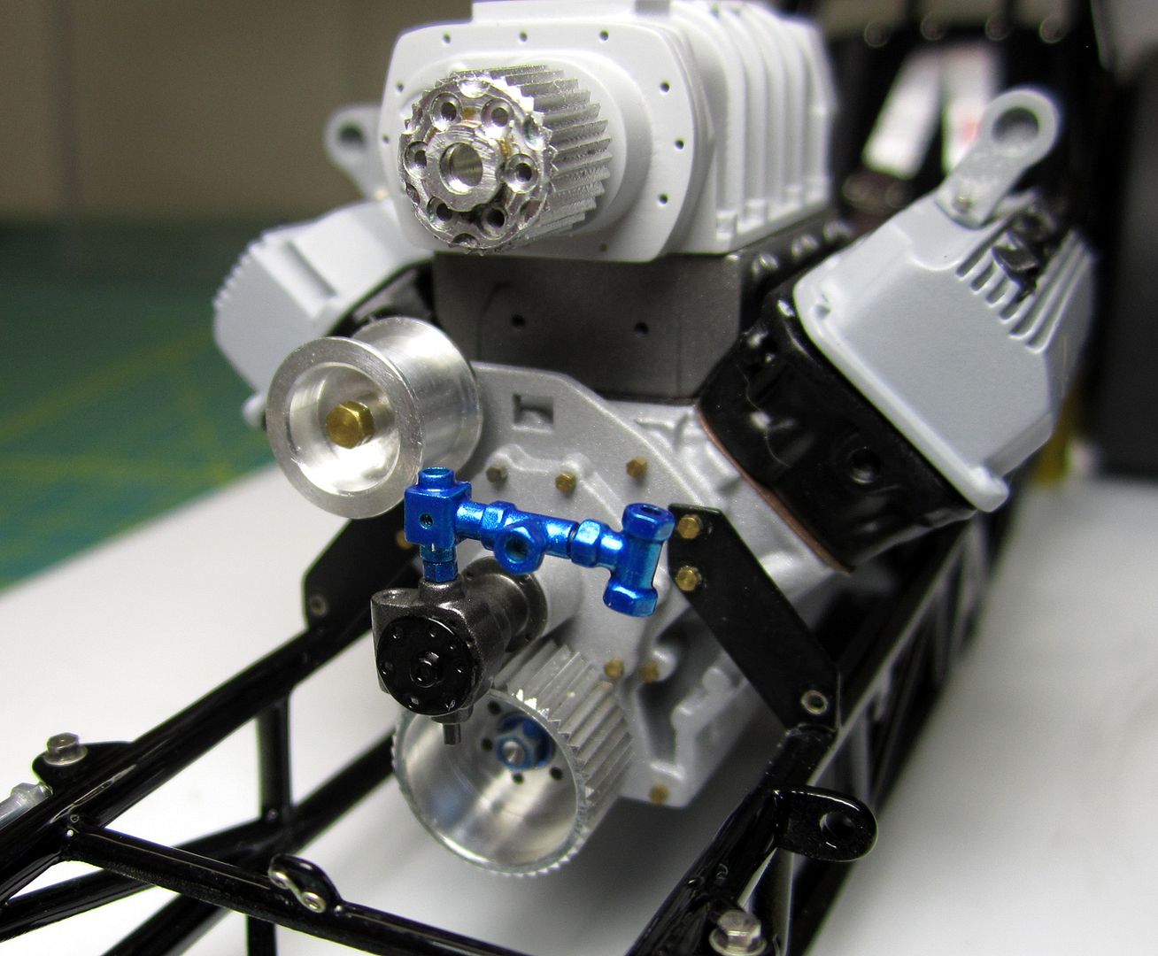

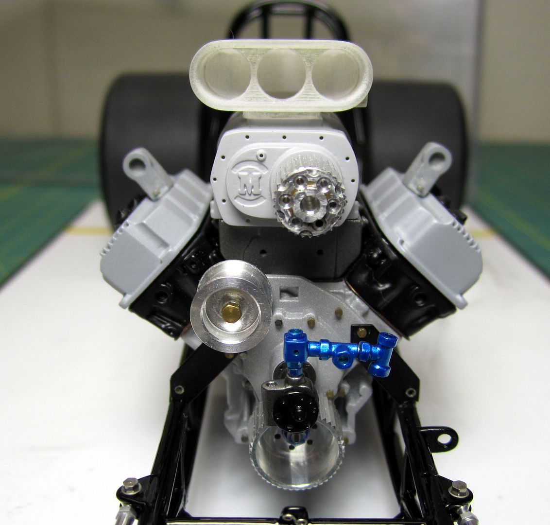

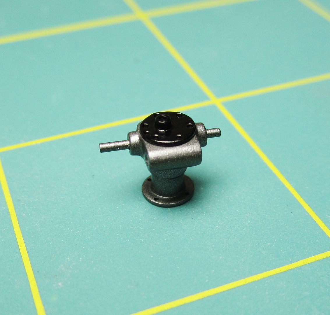

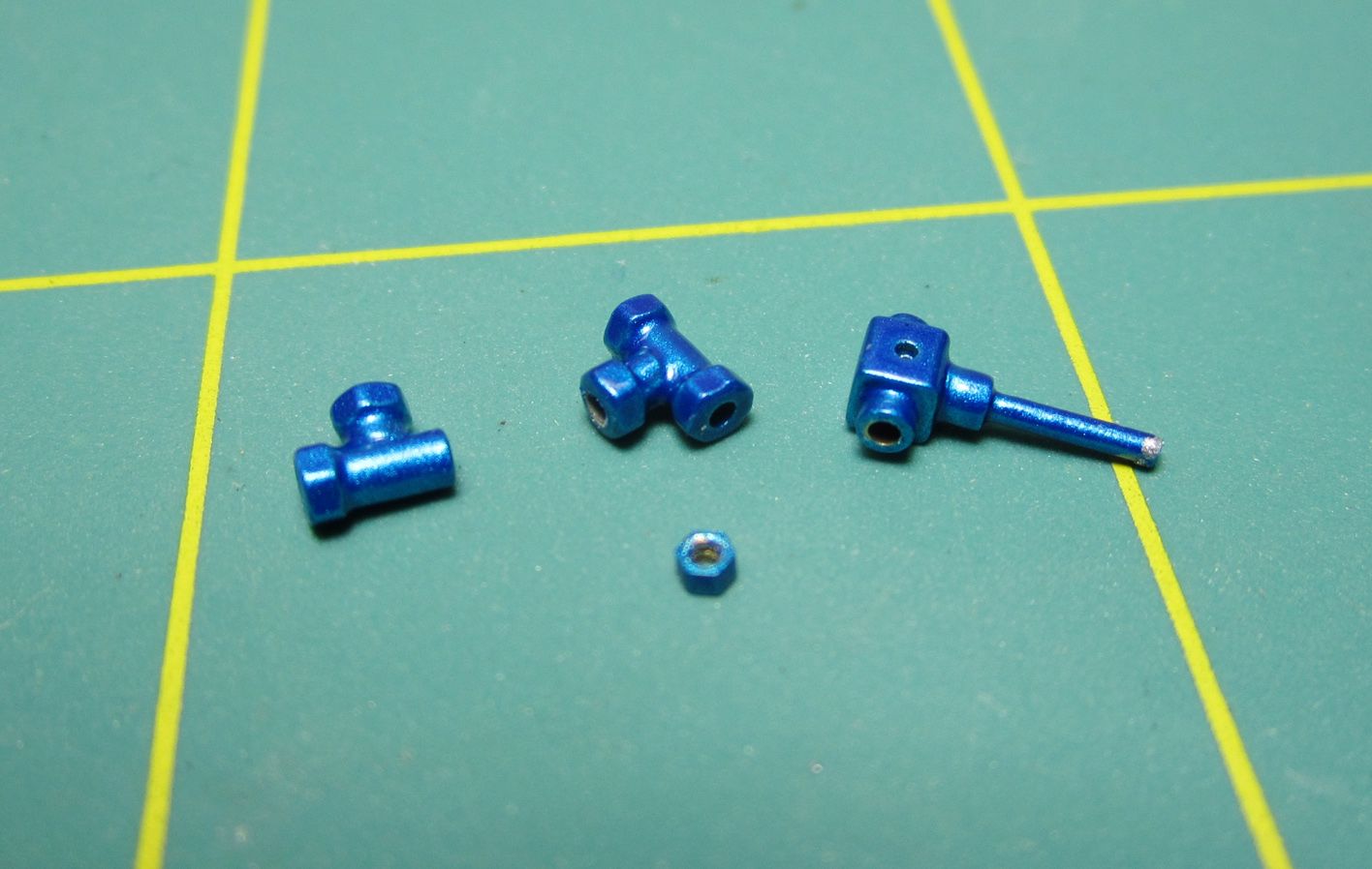

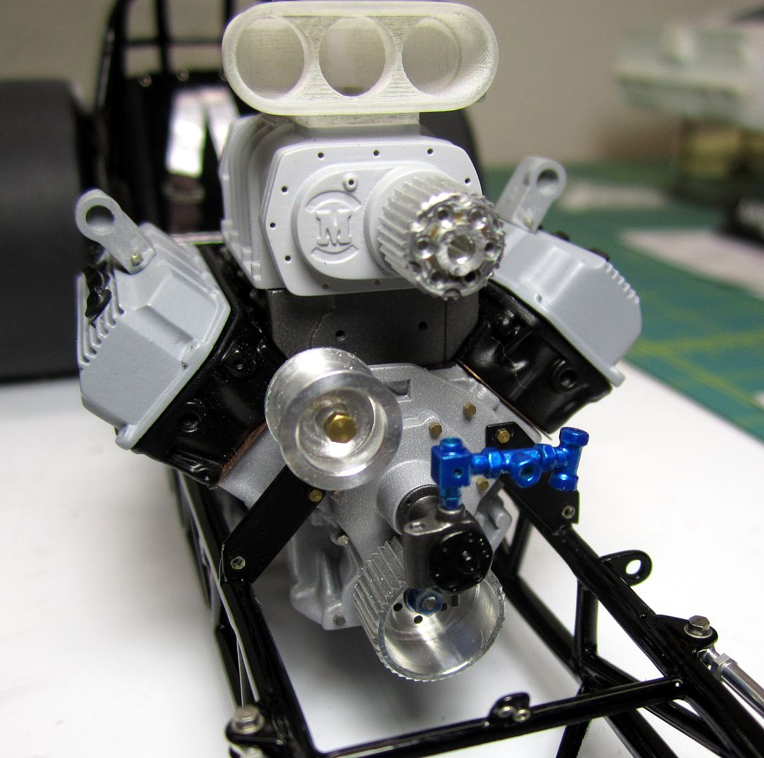

Mooneyzs Posted January 8, 2015 Author Share Posted January 8, 2015 Ok Fellas here are some pics that I didn't get uploaded last night on the parts that I got painted. Here they are: Here is the fuel pump. The body is Alclad steel and the cover plate is House of Kolor BC-25 black base: Here are the fittings. I sprayed them with HOK orion silver base and then with Tamiya clear blue: And as usual I had to mock the parts up snap a few pics: Quote Link to comment Share on other sites More sharing options...
AZ Boy Posted January 8, 2015 Share Posted January 8, 2015 Awesome Chris. Good job, bud. Quote Link to comment Share on other sites More sharing options...
John Teresi Posted January 8, 2015 Share Posted January 8, 2015 Chris..........I just mad a "BIG" doo doo in my pants..........and it`s all your falt ..........now I`m afraid to look at anymore of your up-dates........because,I might make another doo doo in my clean pants Quote Link to comment Share on other sites More sharing options...
Nitrozilla Posted January 8, 2015 Share Posted January 8, 2015 Chris..........I just mad a "BIG" doo doo in my pants..........and it`s all your falt ..........now I`m afraid to look at anymore of your up-dates........because,I might make another doo doo in my clean pants At least you have minions to help with that. Can I borrow a few? Chris, I knew you remembered how to shoot more than primer. IMPRESSIVE. lol Quote Link to comment Share on other sites More sharing options...
bobthehobbyguy Posted January 8, 2015 Share Posted January 8, 2015 Looks great. Quote Link to comment Share on other sites More sharing options...
