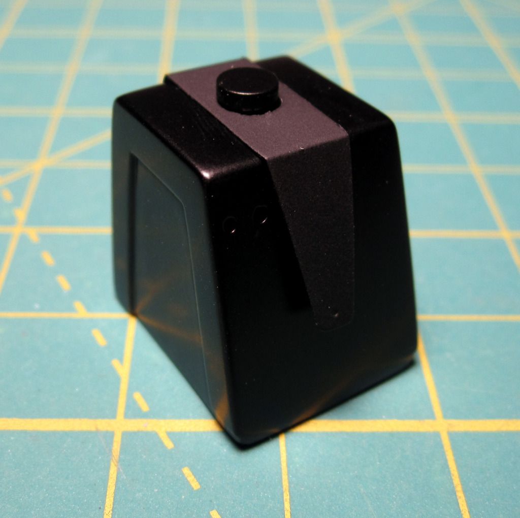

First Up is the side Tins of the chassis. They are spayed with House of Kolor black base and then shot with HOK inner coat clear with some flattening agent in it. I had to play around with how much flattening agent I used to get the look i was going for. There is a couple pieces of dust that I am thinking of hitting with some fine paper and reshooting the inner coat clear:

Next is the Fuel tank. I had shot this previously and for some reason I had some fish eyes that popped up in the paint which i think was caused from wiping it down with was and grease remover and I may of not waited long enough before I shot the paint or shot it on a little to heavy the first time. But now I am pretty happy there were a couple pieces of dust in it so i am debating on hitting it with some fine paper and misting a little more HOK black base with inner coat clear over it:

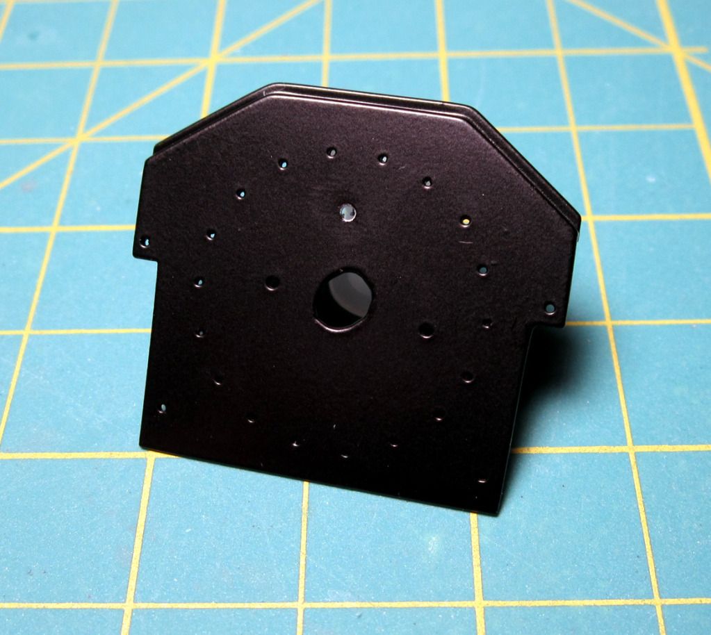

Here is the Midplate which I sprayed again and the reason it got repainted was I had to trim some of it off the bottom because it was a little long and hanging below the chassis. Some how I missed the boat on that one:

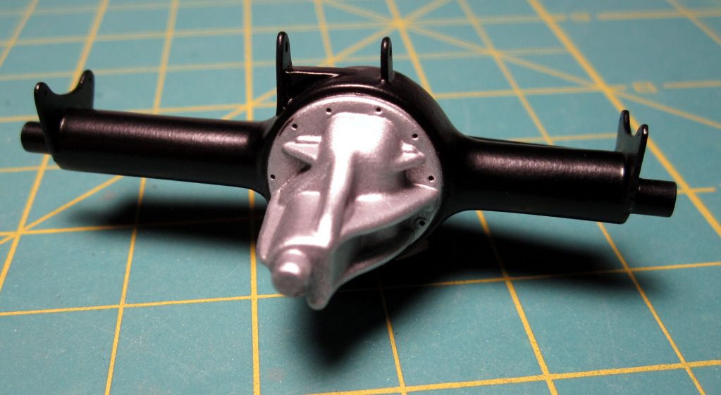

I repainted the black on the rear end and then shot inner coat clear with less flattening agent this time from the first go around with it:

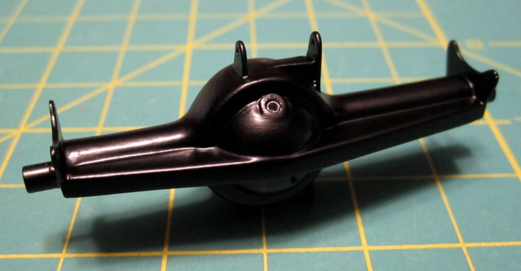

Here is the rear view:

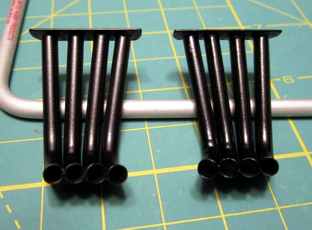

Here is the headers. this is one of the guys that the bug decided to fly in the way of. so they will get sanded lightly and mist a little black base back on it. Then I will be adding more flattening agent than what the rest of the parts have on it because I want these to be a flat black:

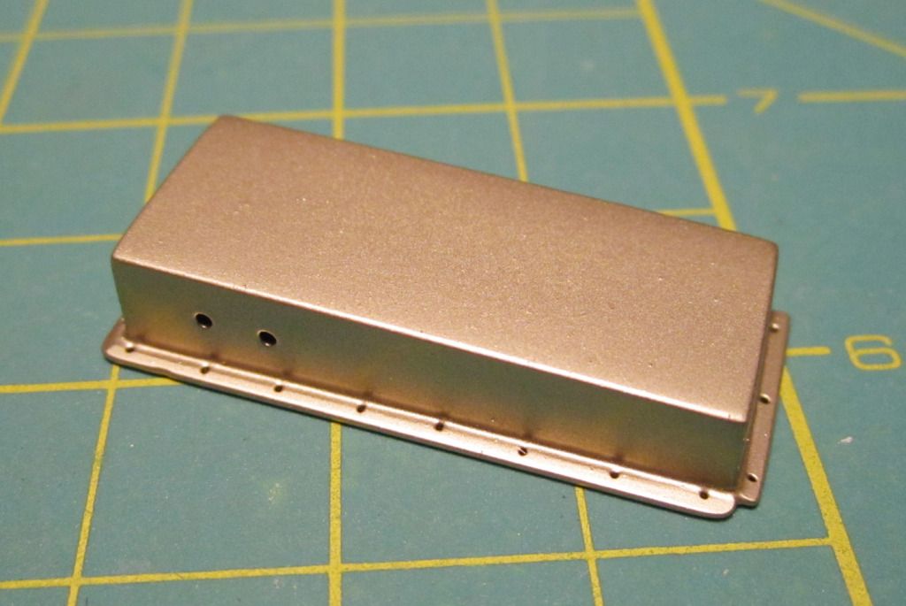

Here is the oil pain for the 2nd time, if you look closely you can see little bumps on it. So I am hoping the 3rd time is the charm on it. I am gonna try shooting it a lower pressure and make sure I mist every coat:

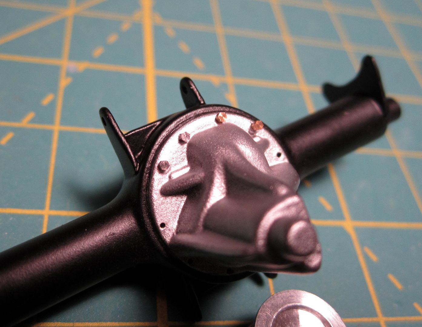

Hey Guys.... thanks for all of the kind comments. I know I haven't posted much lately but I have been getting some parts repainted this past week and well I need your help at the moment. I have stuck two different bolts in on the rear end and trying to figure out which looks best.... the Nickle plated bolt or the brass bolts on the 3rd member of the rear end. Let me know which you think is best. Also note that this is the last time you will see the rear end before the rear end assembly is completed. I will be gluing the disk brake and hubs to the rear end as well as installing the brake line, calipers and the few other details this weekend. So stay tuned but here is a pic of the bolts. Let me know which you think looks best.... Thanks!

NICKLE hands down Chris! generally you don't see many brass bolts in 1:1 automotive applications except for fittings and such, they are used in marine applications occasionally for corrosion resistance , I think the nickle looks more like it would have been on the real deal, brass bolts generally aren't as strong as a steel bolt that has been hardened, keep up the fabulous detailing my man!

Bill thanks man.... I was thinking the same thing. but the brass could kind of be like grade 8 bolts how they have the yellow zinc plating ;) .

I was going to mention that too, Chris. The yellow zinc plated grade-8 bolts are as common as mud. I'd be more concerned about the style rather than the color. These drop-in center sections usually slide over threaded studs and then secured by nuts. The bolts just don't look right.

Nickle.. looks more like what you would see on the real deal.

Alyn... You are right. I had over looked the detail of the studs in the rear end. So I pulled out some of my Simulated Hex nuts from Scale Hardware and swapped them out. But I am thinking of going with the threaded stud and nuts, shown just below the rear end. I just don't have enough of them to do the whole rear end at the moment. Looks like I may have to place another order to Bob at Scale hardware. Thanks for the compliments about this build. It means a lot.
Jim... Thanks man. I have to agree with you.

Chris looks awesone i think you should just run with the simulated nuts and tread usually there is bugger all thread on a stud when the nut is on and the ones you are using look perfect

there you go Chris, thats perfect, Alyn is right, That is the correct way it should be, worked out great that you had just enough layin around to get it done! very nice!

Those look perfect Chris. I like them much better with the studs showing.

x2.....yep,looks like the real deal.....AWESOME work Chris.

Definatily the studs, what size are the studs and nut Chris?
