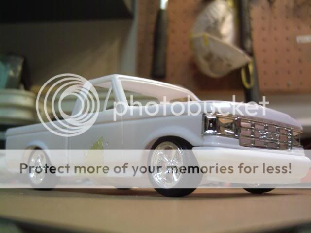

On the front of this I cut out the engine mount, cause it was way too low, and chopped the springs down to seem like lowering springs. On the rear I moved the axle on top of the leave springs, and put some blocks under there. It really depends on the truck and the style of build you are going for, be more specific and we could help you out better.
Posted Image
