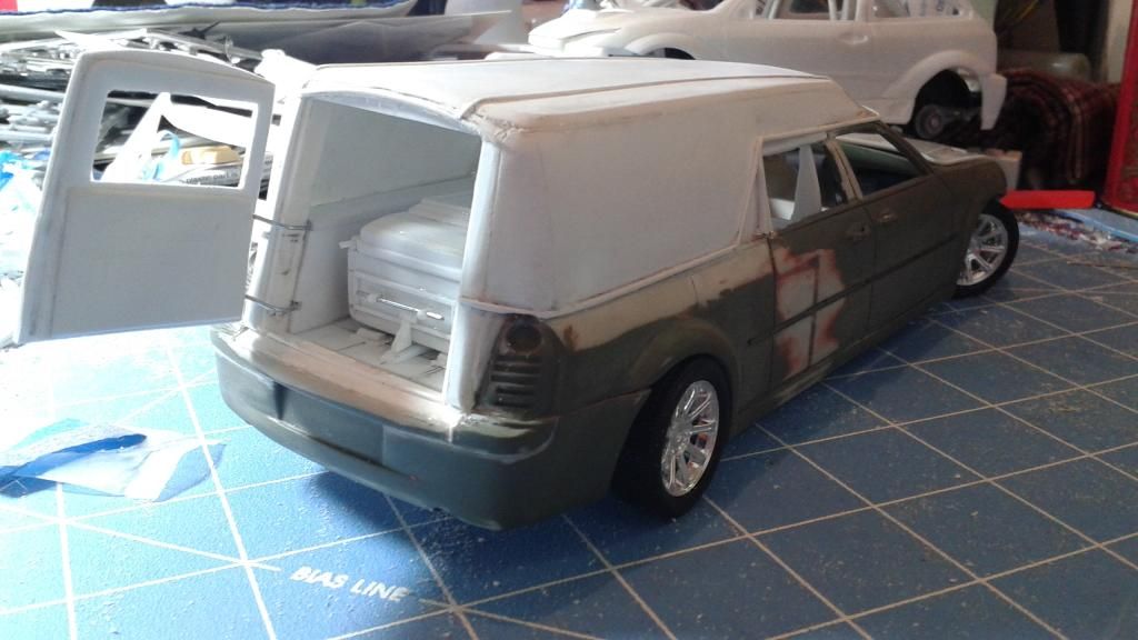

Its starting to look like a hearse now. Some "purist die-hards" wasn't happy with my High Top version. So, I lopped off 8 to 10 scale inches out of the roof. I added the vinyl roof trim, made a divider, and started the rear interior panels as well. Not much else on the body work now. Just tidy up a few things and get them ready for primer and paint. Not gonna do that just yet as I'm fiddlin' with hinges for the rear door, and the rear floor. So enjoy!
The hole in between the two pieces of trim is for the third brake light that I've made from scratch.

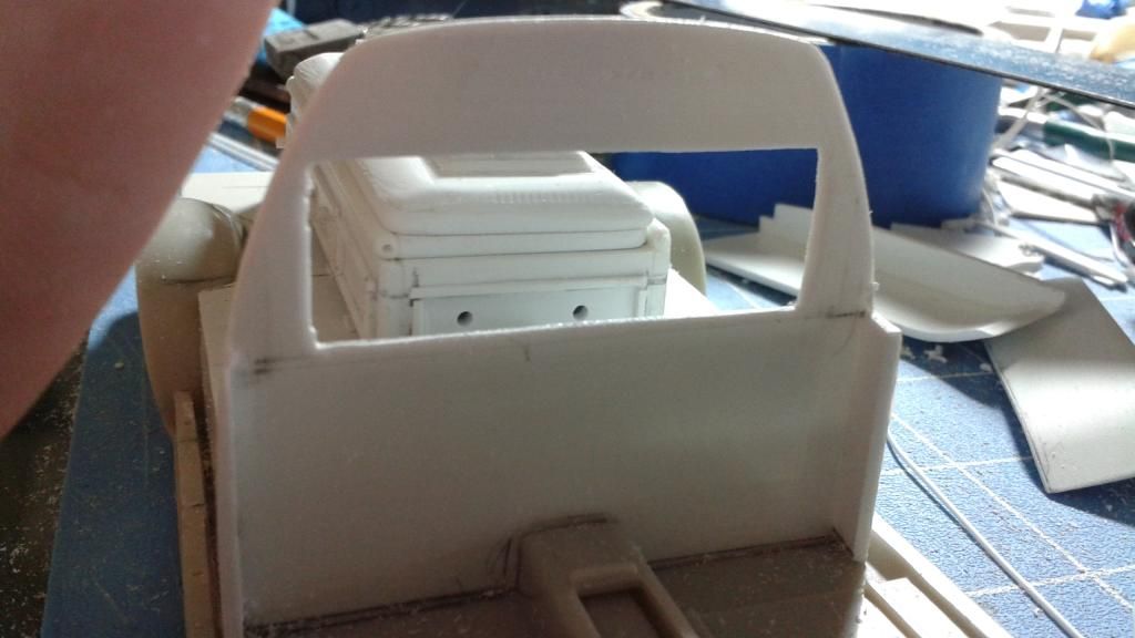

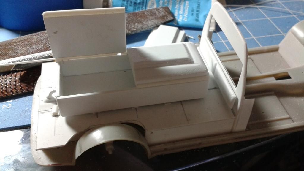

Thanx everyone! The comments and compliments go a long way with me and keep me motivated. I can say I've never had so much fun killing time and boredom with engineering parts and how they fit.  Box stock? What's that??? LoL
Ok, We start on the inside since most of the outside stuff is done. I've made the divider and rear door panels already. So now its time to build upon that and make the rear load floor and side walls. I'm toying with a couple of ideas in my head about the floor, not sure if I'm going to execute them or not. We shall see. Enough of my blabbing. Here's where I'm at so far with about 2.5 hours worth of work.
I know the divider window is a li'l low, but after doing some research some of the newer cars like this for some reason. Also, pardon the pictures, but I took them with my phone and uploaded via Photobucket Mobile. ;) Enjoy!

The big question in my mind... does a hearse actually have a divider window?  It's not like a taxi,  the rider isn't going to attack the driver from behind!  Or maybe..
Yea, but the smell of the formaldehyde.. essh. Smells really bad.. It keeps some of the smell in there and not in the drivers compartment...
Yes.  At least every one I've driven has.  It's as much a cargo wall as anything.  A loaded casket can weigh as much as 600 lbs and though there are casket stops at the front and rear keeping it in place, there's nothing holding it down.  In a collision a casket could possibly jump the front stop and fly forward- the divider wall is designed to prevent it from killing the front seat occupants.

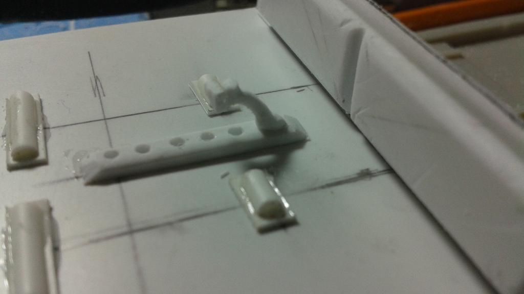

Well I had a bit of a hiccup with hinging the rear door, it seems its either open or close but no swing. I tried multiple location points and many different hinges and nothing works. Oh well, I'm going to display it open anyways as the interior is coming along smashingly!
I made the Rollers with Half Round glued to .010 Styrene Sheet and then I used .040 styrene strips to make the coffin stop/slide rails. I'll later foil these for some shiny bits in the rear end. LoL I drilled holes in it for multiple location points. I hand crafted and sculpted the rear coffin stop from scrap styrene. I doubt I'm making a front one as this one took me 2.5 hours of widdling and fiddling. Hands are tired. LoL Enjoy!
What you see on the divider that looks cushiony .... Well, that's the "crash pad" and I just need to put the trim on in between the two sides. I also made the window larger on the divider. Not sure if I'm going to put glass in it yet or not. We'll see!
Enjoy!!
