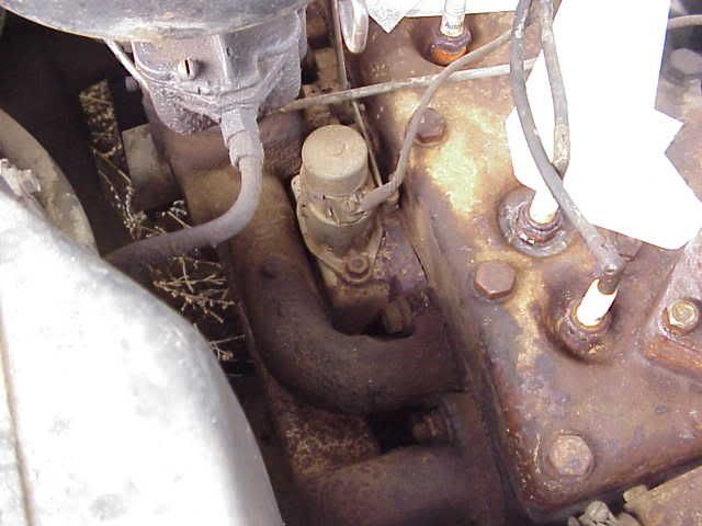

I'm thinking of getting back to the build of my '51 Plymouth straight 6 engine and one thing that put a pause on it was modeling the spark plug connectors. These are those old metal connectors .. made from sheet metal with a 90 degree bend and clamped around the wire with a press fit to the plug. They were all bare metal and were about the wire insulation diameter. I found one photo below.
Some thoughts I had were slitting the plug wire insulation so it would bend to 90 degrees, gluing and painting silver. I think this might be a tough glue job without making some jig.
I do have some rubber spark plug boots that I could just paint silver but these are large compared to the plug wire. Last possibility I will just use there as is. I do have some cast spark plugs I'd like to use and these would cover more of the plug that I want to.
Any thoughts on this would be greatly appreciated.

Wrap end of wire with BMF, bend the wrapped end 90 degrees over a sharp angle. A small piece of styrene rod will do for the spark plug. That aughta do it, aside from weathering.

photo research has shown these engines with straight plug boots, 90-deg boots and no boots at all.
if you are trying to replicate the plug wires in your photo, I suggest making your own plugs...
drill a hole into plastic rod that you will use as the porcelain part of the plug and insert the bare plug wire (remove the outer insulating layer) with a crisp 90-deg bend into the drilled rod, then drill a hole into some Plastruct hex rod to insert the "porcelain" rod into, mount this into the spark plug holes and complete the paint detailing.

You could  center drill the spark plug, then strip the insulation back some,  insert the wire securely, then add a little putty, or sculpt the porcelain. Almost to the top leaving a small bit of expsoed wire.

Now I'm thinking of notching the smallest aluminum tube available and bending it to 90 degrees. That might be oversize but look right after some corrosion is applied.
