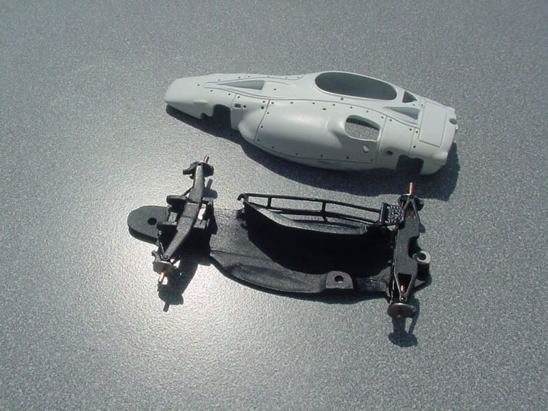

This has always been a favorite car of mine. This is the 1/43rd scale SMTS white metal kit. Here is the body after a mild clean up (nice casting overall) and some scribing of the (already somewhat heavy) panel lines disturbed by that clean up. Also the rivet dimples were drilled to a uniform depth.
Posted Image
Posted Image
Tamiya Fine White Primer for the undercoat of the Day-Glo Red. All the little body parts have been cleaned up and dry fitted before the final application of the primer.

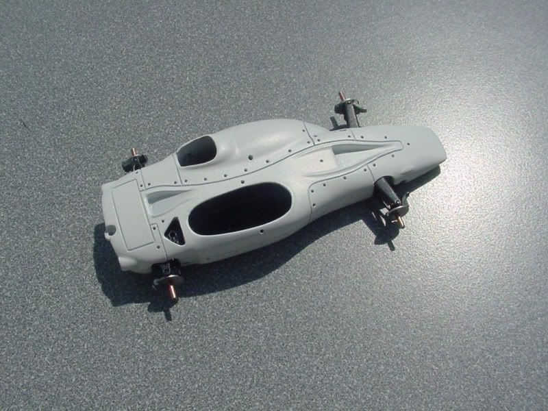

The basic suspension was assembled and aligned to the body and chassis, this is very important to do prior to applying the color coats to the body. Quite a bit of adjusting and massaging required on mine, especially for the front suspension. (Often par for the course on these older white metal kits.)

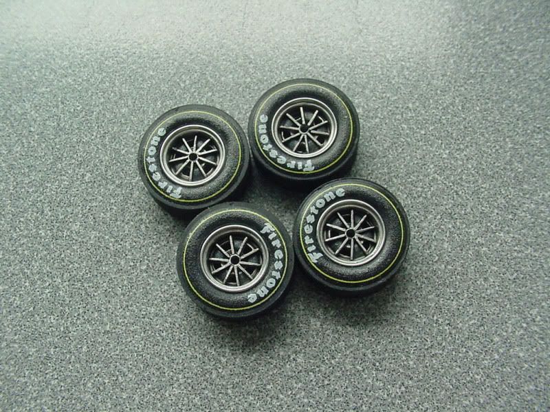

No tire decals were provided in the kit so I made a set. Here they are applied to the tires and finished wheels before getting a shot of Dullcote.

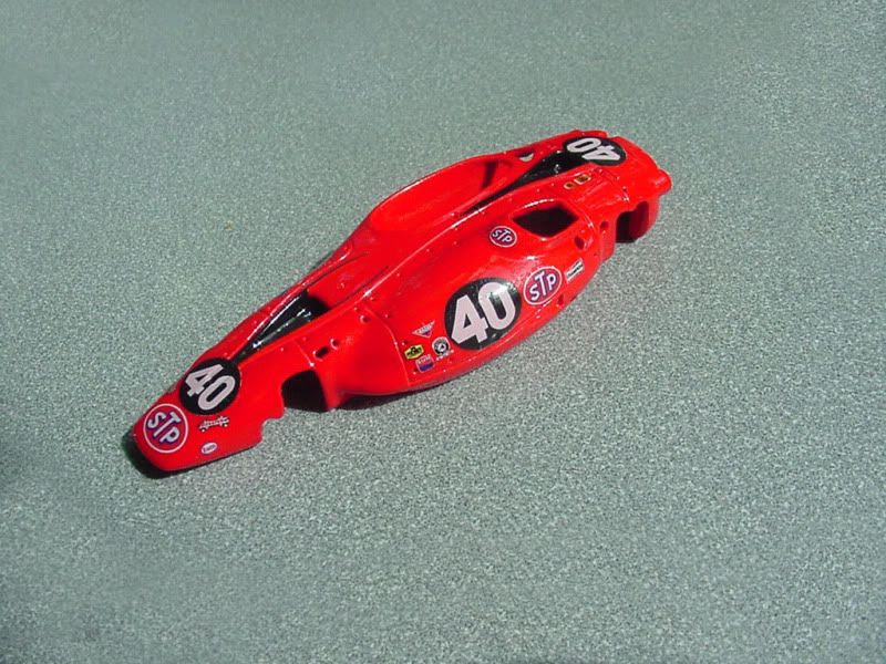

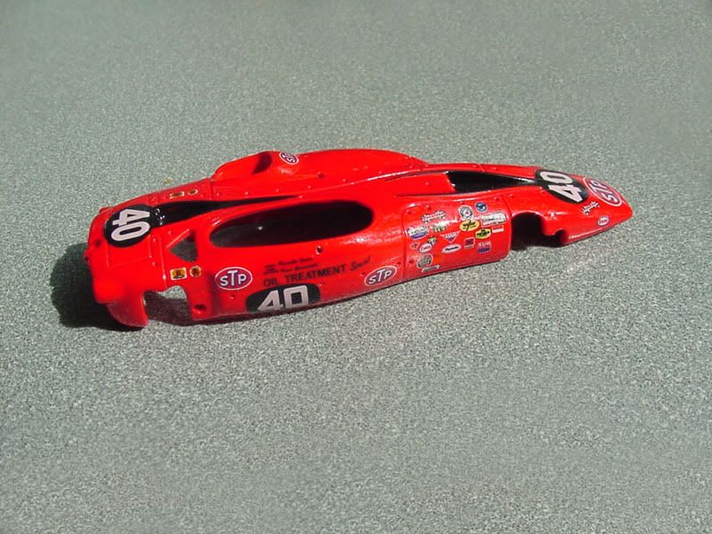

I used Tamiya TS-36 Fluorescent Red. Several coats built up lightly over about a week. The last coat was allowed to dry overnight and I applied my decals.

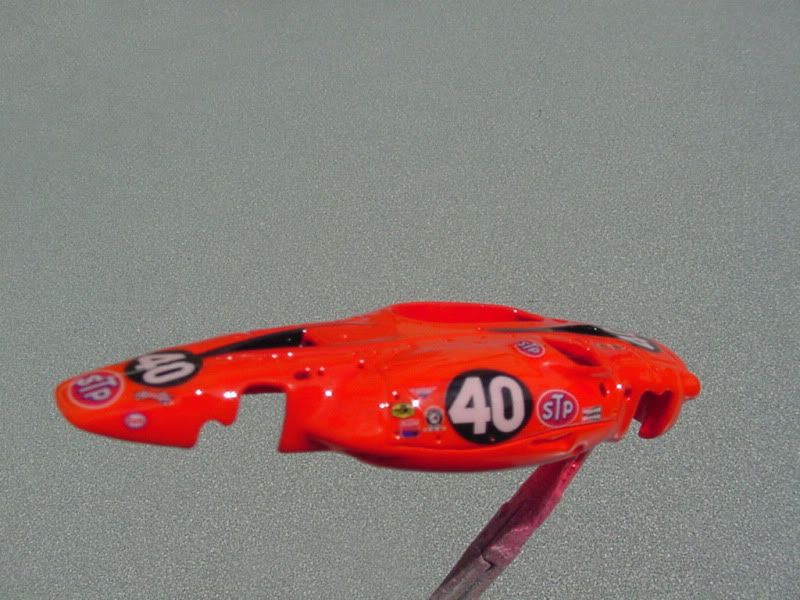

Got some clear on it over the weekend...
Posted Image
Posted Image
Once it is cured it is on to final assembly...
