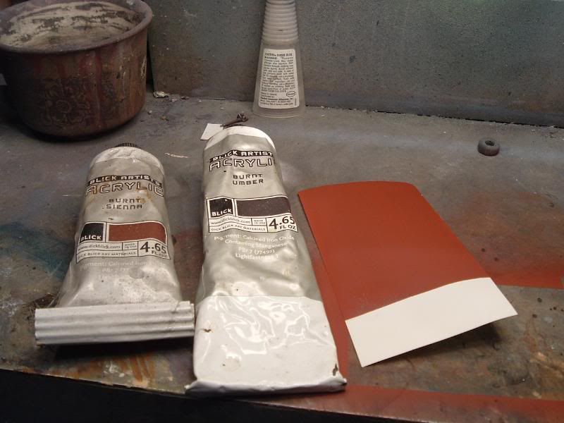

Here's what I do.
Mahogany is about the easiest wood grain ta replicate. Ya need some red oxide primer, burnt sienna, and burnt umber acrylic artist paint. Give whatever ya want a coat of red oxide and let it dry.
Next give it a good wet coat of burnt sienna and don't worry about gettin it even.
Now take some burnt sienna and burnt umber mixed and fairly wet add some dark areas and take your finger and smear it in one direction.
Now let that dry and take more burnt umber and sorta dry drag it across it. If ya get a little to much on, wipe it with yet finger.
Do this until ya get it the way ya want. Now give it a couple coats of clear and yer done.
Makin Oak is very similar. Use a tanish base coat and Raw Sienna and burnt umber. The grain pattern on oak is a little different but can be done in the same way.
It's just that easy my friends.

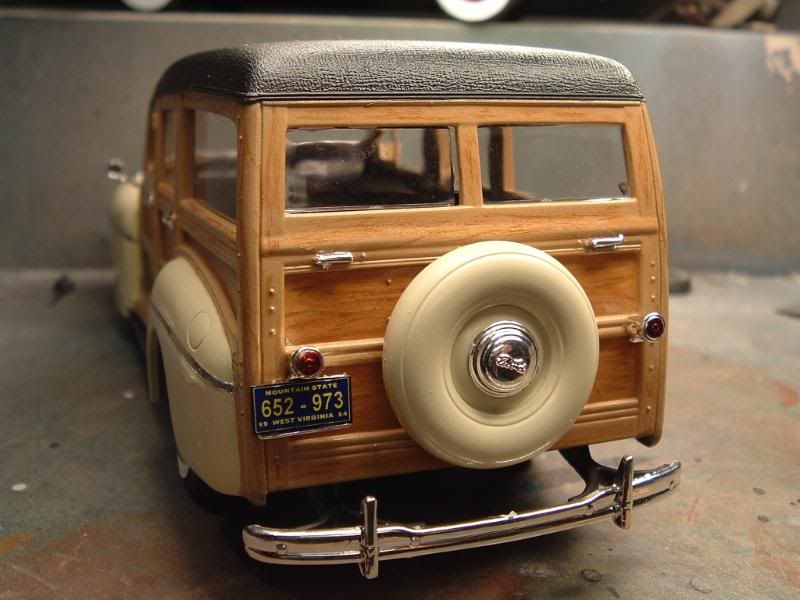

Now yer talkin'! That is some really fine wood grain there, Gramps. I'd have to say that's best I've ever seen painted on. Nice woodies. Is the cream-colored one the AMT '41? How is that kit?

Gramps post, boys and girls, is why this forum is the best. Holy smokes that's a great looking result!
