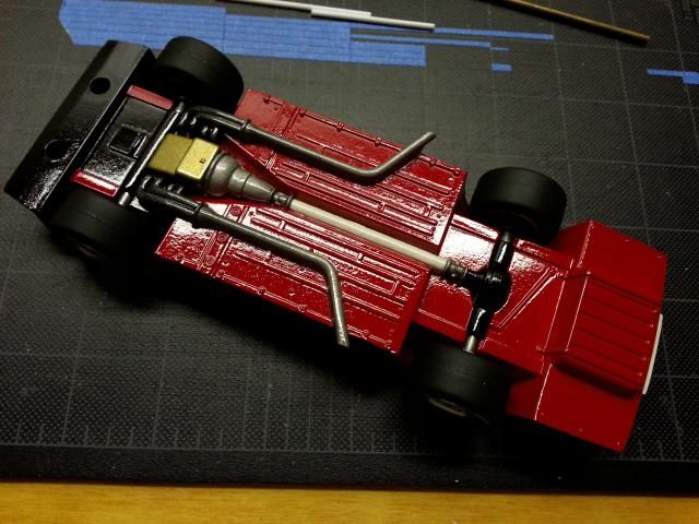

At some point in it's life we got a hold of a paint marker, and with hands steadied by gallons of Mt. Dew, we attempted to add some detail to the undercarriage.
Posted Image

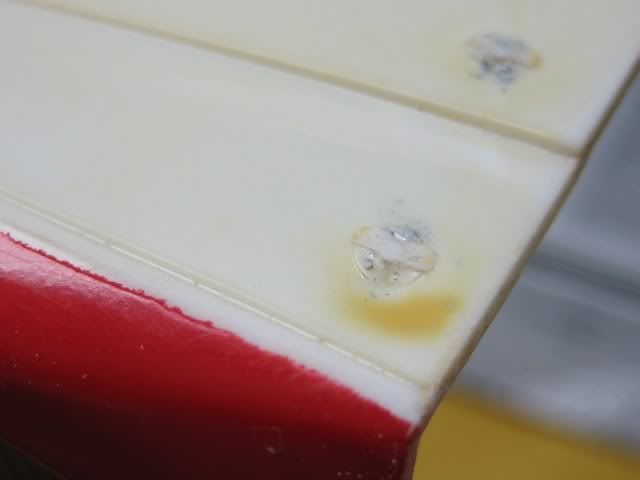

This is where the fun started. These guide pins are molded right under each of the front hood pins causing the hood pins to sit in a sink hole.

I ran a file across the hood and you can see it only filed down about half the hood pin.

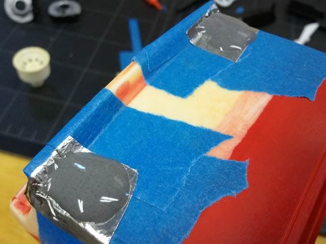

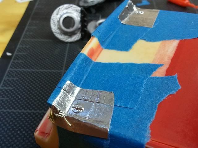

The rear hood pins were solid so I decided to try and reproduce a few to replace the ones on the front. I used BMF to make a nice tight mold of the pins and covered it with JB Weld to keep the shape.
Posted Image
Posted Image
Posted Image

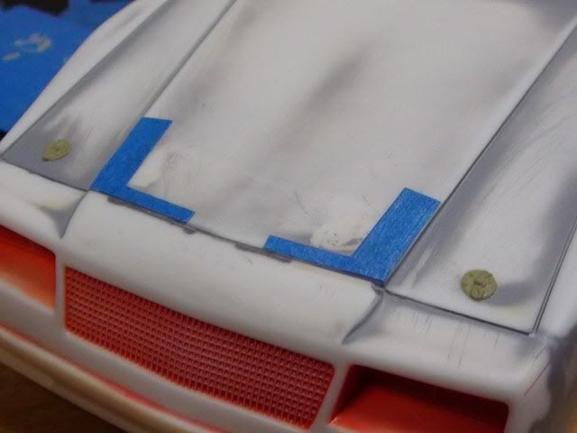

Then I mixed up some Milliput and pressed it into the mold. After it set I popped it out and carefully sanded it down to the right thickness. These little things are scary to work with, I almost lost my first two while sanding them. I wasn't sure if the Milliput would be too brittle when it was sanded that thin but so far it's worked perfect.
Here's the first two glued to the hood.
Posted Image

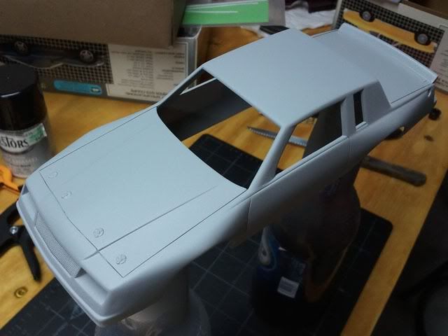

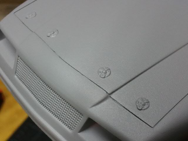

Finished the hood pins tonight. The last one I applied turned slightly before the CA glue locked it down. Oh well, I'm really happy with the way they turned out.
Posted Image
Shot one last coat of primer to check the low spots and body lines are blended smooth.
Posted Image
Now I have to start getting color on her. I'm going to stick with the red and white paint scheme but I will be putting my Dad's company's logo on it and that is white so the car will be mostly red before the graphics are applied.

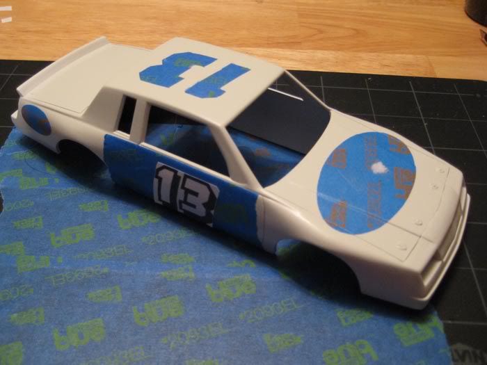

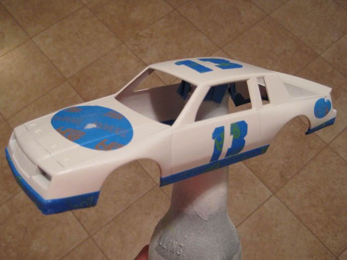

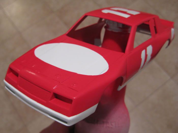

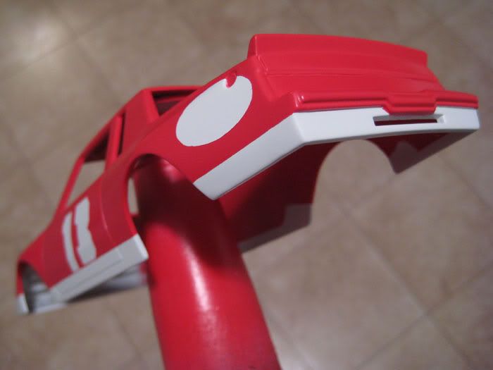

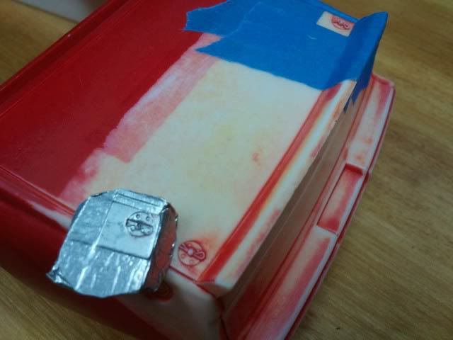

Hit it with some white a while ago and let that set before masking and shooting the red.
I'm printing my own decals. I figured to get a nice black edge without having to cut out the decal so precisely, I taped off the white areas and will just print the black outline on clear decal film.
Posted Image
Posted Image
Starting to look like she'll make a convincing race car.
Posted Image
Posted Image

This one looks like a great project! I like the job, you have done with it, especially those hood and trunk pins are looking really great, I like the way you made them. This Monte Carlo body is one of the best looking NASCARS of that era. Looking really good, paintjob is nice and just can't wait to see the finished product. I think, that I must get back building my Jeff Gordon Monte Carlo, finally. Keep up the good work! B)

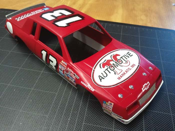

Thanks for the compliments, this is turning out to be a pretty fun build.

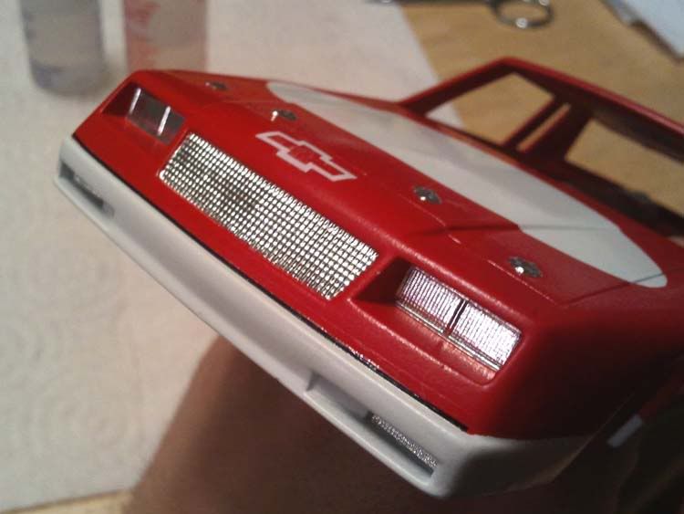

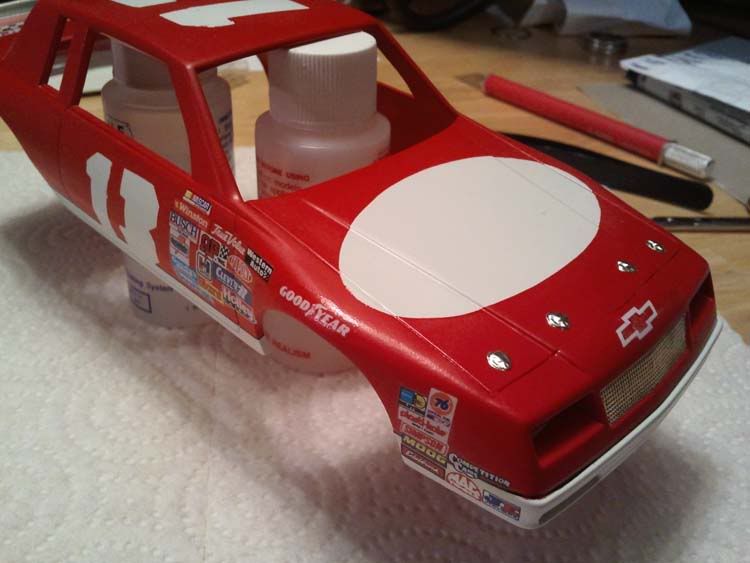

My first time using Bare Metal Foil. Cool stuff. I'm going to give the grille and ducts a black wash to bring out some detail.
Posted Image

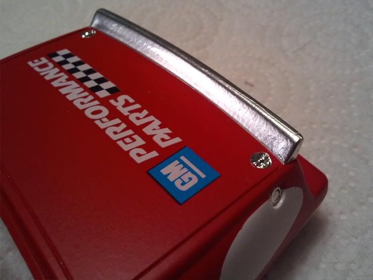

Hey, the hood pins are covered with BMF again! B)
Posted Image
Mixed a couple sets of old Cup car decals from my stash, pretty good fit.
Posted Image

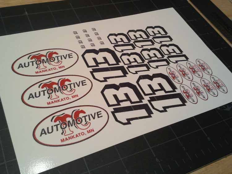

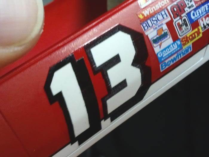

Printed my decals. I'm thinking I'll have to double up the #13 decals as it looks like the ink goes on in thin streaks since it can't wick into the decal film like it does on paper. The detail in the graphics is pretty good though.
Posted Image

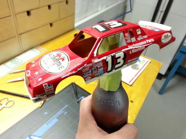

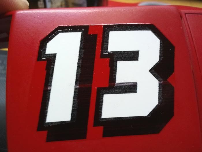

The black outline on clear decal film worked great. You can see the streaks in the ink in this picture.
Posted Image
I printed out extras though and an application of a second decal gives it a nice solid black. You can see how much better the #1 looks than the #3.
Posted Image
Time to dig through the decal bin and find some secondary sponsers.
Posted Image

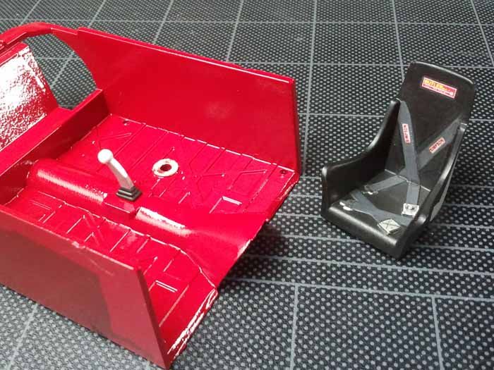

Wow! I hit the interior tub with clear and the red really popped! It's much brighter and deeper than even the cap which I went by when I picked it out.

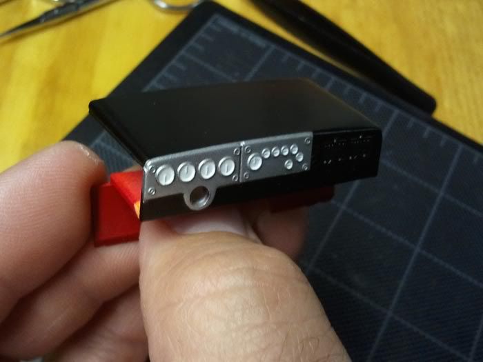

Here's the dash and gauges so far. going to keep this pretty simple. I'll paint the needles and the gauge panel screws but nothing more.

The interior tub and seat so far.

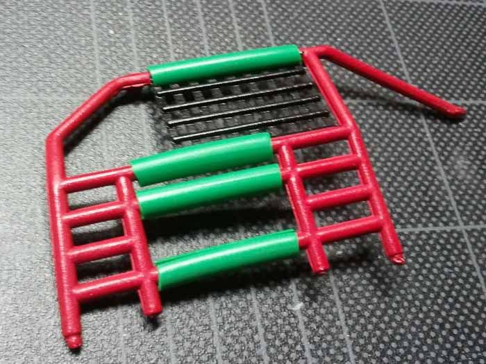

I was trying to add some roll bar padding with wire insulation. this stuff looked a little big but the roll cage sits right up against the interior tub so I think I'll just paint the padding on so everything will fit back into place.

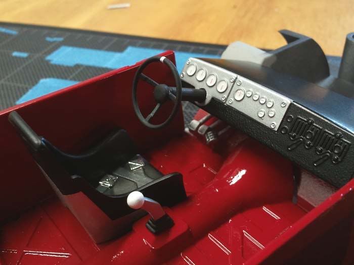

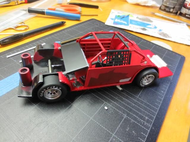

The interior is pretty much finished. I shortened some leftover pedals from a monogram stock car and that's a steering wheel glued to a piece of sprue.
Posted Image

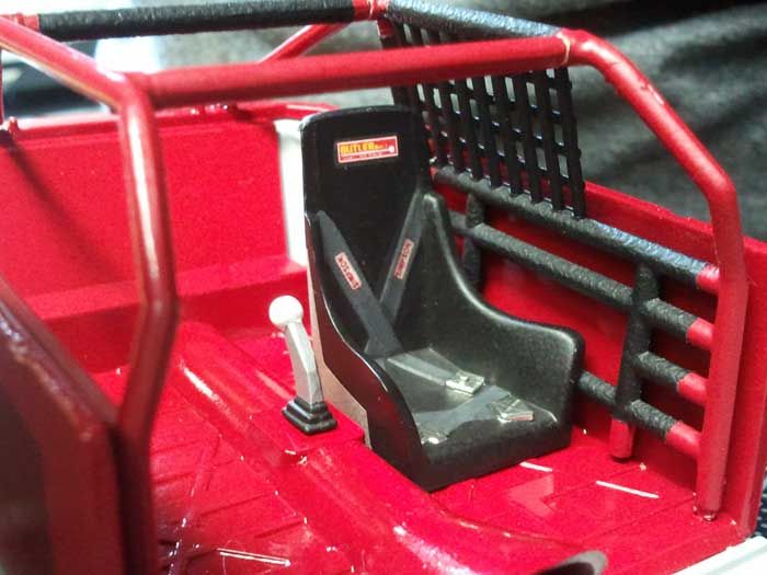

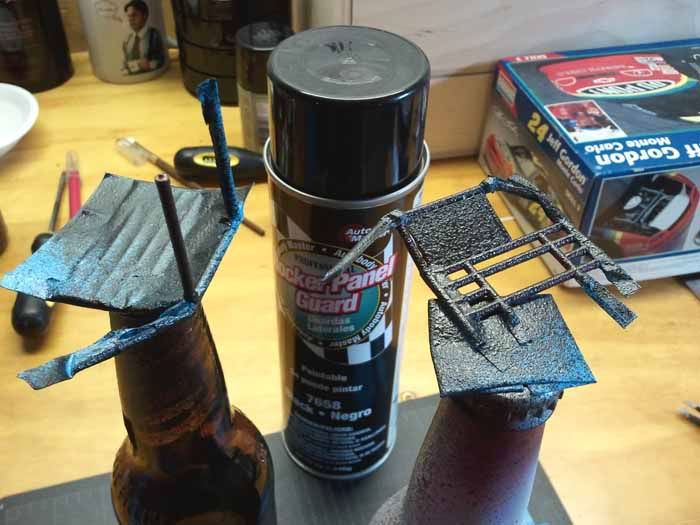

For the roll bar padding I taped off the bars and hit it with a light coat of rocker panel coating from an automotive store. Just enough to give it some texture.
Posted Image

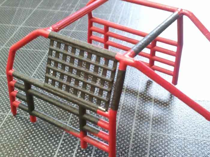

After that set I covered it with black and then gave it a nice clear flat coat to even everything out.
Posted Image
Looks pretty good in there!
Posted Image
She's coming together quick now!

Very impressive work Ryan. I love resto's and prefer them to new kits. Your ingenuity with mold making for the hood pins and rocker panel guard for roll bar padding is terrific. Looking forward to the finished product.
