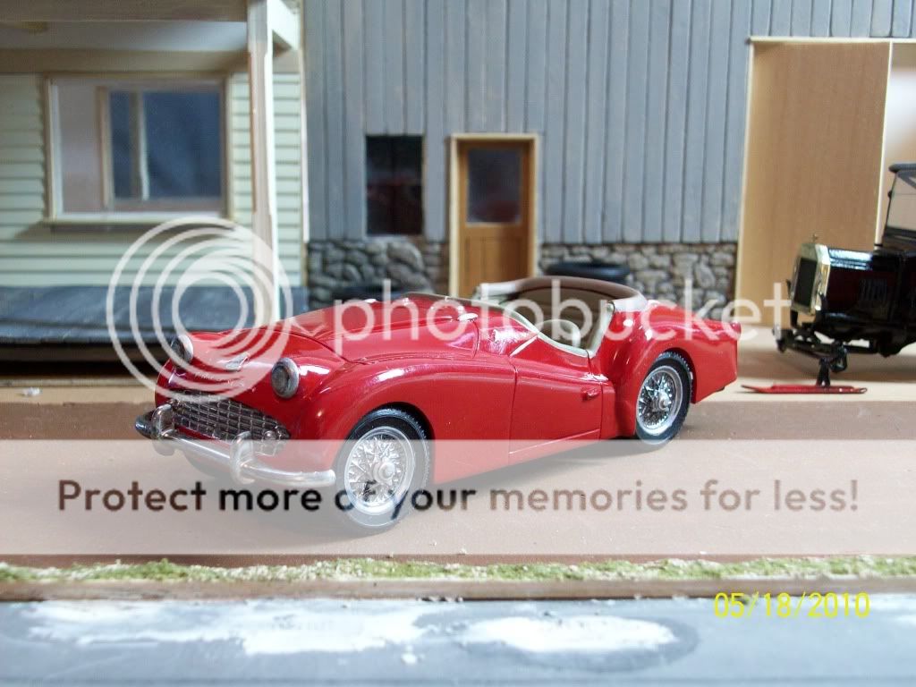

Replating is expensive. I've re-done chrome by stripping off the old and spraying gloss black... then brush painting Alcad over the black. I know it's not the the accepted method but let each coat of Alcad dry out for a couple of minutes and two or three coats should do it. This photo was taken "in progress". Here's an example where the kit came with no chrome on the bumper at all. I haven't cleared it so I expect it would come even brighter if I did: (I didn't "chrome" the wheels or headlamps.. just the bumper.)

Tony, thanks for the Alcad tip. I will give it a whirl. The bumper on the Triumph looks really good. I have a partially completed Pyro '52 Chevy wagon that stalled as I wasn't satisfied with the results of using BMF on the bumpers, grille, etc. I also have a few 1/43 Heller kits that your method might work on. I don't have an airbrush, so this will be worth trying.
