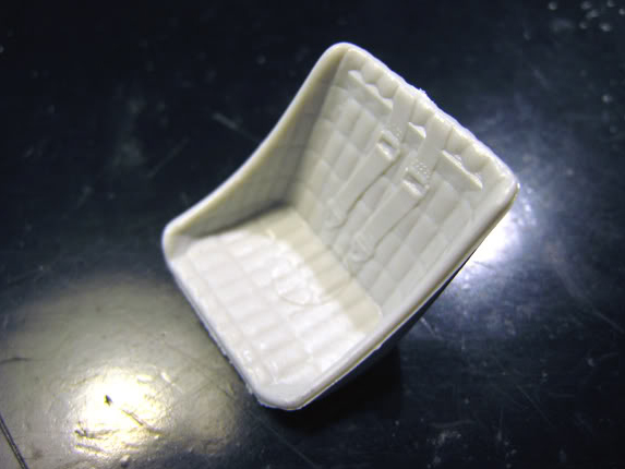

The Wild Willys seat left alot to be desired so I fabricated one with printing plate. Plan on drilling weight-reducing holes in the sides, adding some padding and PE seat belt hardware.
Original seat.
Posted Image
Fabricated seat.
Posted Image

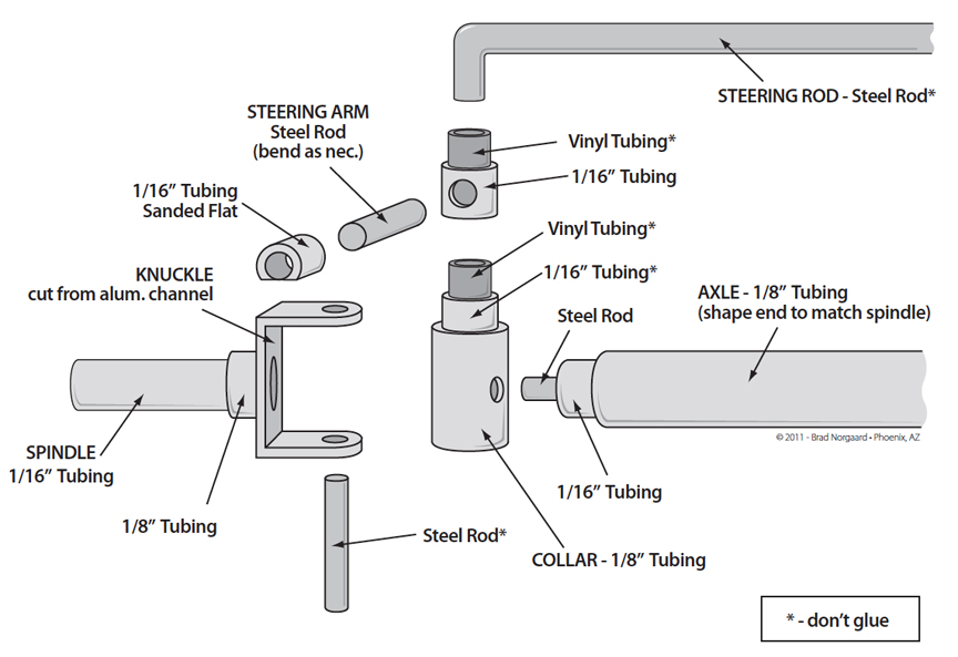

Here's my first attempt at making a batwing for the front axle. Its also made from printing plate and bent over the edge of my machinists ruler for a crisp fold. For the rods, I used aluminum rod that has been flattened with my toothless pliers and then drilled out. I have an order in with Scale Hardware for the bolts and nuts so I'm waiting for that to arrive so I can continue.
Posted Image
And a close up of the right side of the front axle showing the spindle, knuckle and steering arm connection.
Posted Image
I used 1/16" aluminum tubing for the knuckle connection to the steering rod with a piece of black nylon tubing (scale hose) to take up the slack and provide a smooth movement for the steering rod. The actual steering rod is a piece of solid metal rod with the ends bent at a 90 degree angle. What holds it in place is the two bent ends are slightly at a different angle to provide a bit of twist in the rod so it will stay in place without any glue. The actual knuckle is made from aluminum channel from the LHS that's cut to size and ends on the top and bottom of the axle connection are rounded with a small file. BTW - I use Zap-A-Gap for any thing non-plastic and Plasti-Zap for plastic to plastic connections.
Hope this all helps and gets you guys inspired to make your own tube axles. As always, comments welcome.
Edited by gasser59, 06 July 2011 - 10:52 AM.

Per your request, here's a diagram of how I built this front axle. I know, it looks really complicated but once you understand the stress points and have one built, its not that difficult. Just time consuming. Take your time, have a bit of patience, some fresh Zap-A-Gap and you'll get it done.
Posted Image
I've also made the steering arm as part of the knuckle once before but I like this version better because of how the steering rod attaches. Here's a picture.
Posted Image
Let me know if you have any questions or difficulties.
Edited by gasser59, 06 July 2011 - 11:10 AM.

Thanks for that Gasser59. I specially like the diagram.
I've made a number of straight axles myself. My 32 Ford Altered I recently posted here has one. Kit ones usually suffer from lack of detail. And kits usually come with drop axles for lowering. But I make mine out of styrene. I like the looks of yours better. I wouldn't even paint it if it were mine. Nothing replicates metal better than real metal.
And I also use Zap a Gap for everything that needs a strong bond, is not plastic or has a gap. Great stuff. B)
