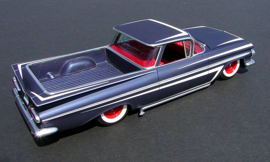

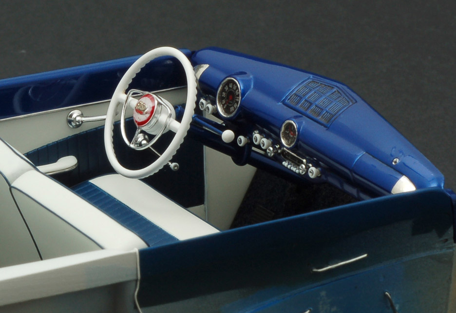

The key to the chrome look is a smooth, wet looking dark base coat. The "chrome" will only come out as reflective as the base coat. Orange peel on the base coat will result in bumpy, less reflective "chrome". I like Humbrol black enamel because it dries to a harder finish than Testors. I thin the enamel with lacquer thinner, which makes it dry a little quicker than enamel thinner. I've also used Testors flat black Acryl as a primer followed by Humbrol clear enamel top coats with nearly identical results as with black enamel.
I'm sure blues & grays would make a good base color. In fact that double nozzled spray chrome stuff uses a gray base coat. I've tried white & it looked pathetic.
Once the enamel has dried a few hours or a day, I spray very light coats of Alclad, slowing building up the chrome look. If you spray it too heavy, it will look like aluminum. If you don't spray enough coats, it will look like hematite, or whatever that dark grey metallic stone is that they make rings out of. I keep misting on coats until I see very few or no black specks from the black base coat. I'm talking very low air pressure
After the final coat, I set the part aside for a couple of weeks to let the enamel fully harden. After that, I wipe the overspray dust & buff it with an old T-shirt. I haven't found any clear that can go on top of Alclad without losing the chrome look. I don't remember if I tried Future, but I don't care for Future because it doesn't dry hard hard enough for my use. You will be able to handle the parts, but repeated pressure or rubbing on the part may remove the chrome. But, those can usually be touched up easily by spraying more Alclad on that spot or even using a brush to apply it.
All chrome except body/window trim on these is Alclad.

Horn ring, door handles & window cranks are Alclad. You can also use a paint brush to apply Alcad. All the chrome spots on the dash knobs & window cranks were done with a brush, as well as the bezels around the knobs on the dash.
