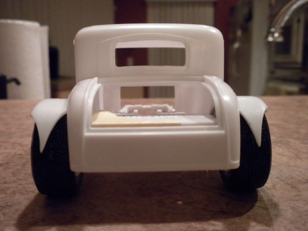

I put this build on hold for a while because I was to scared to cut into it. After a lot of brainstorming and driving myself crazy I decided to just start chopping.

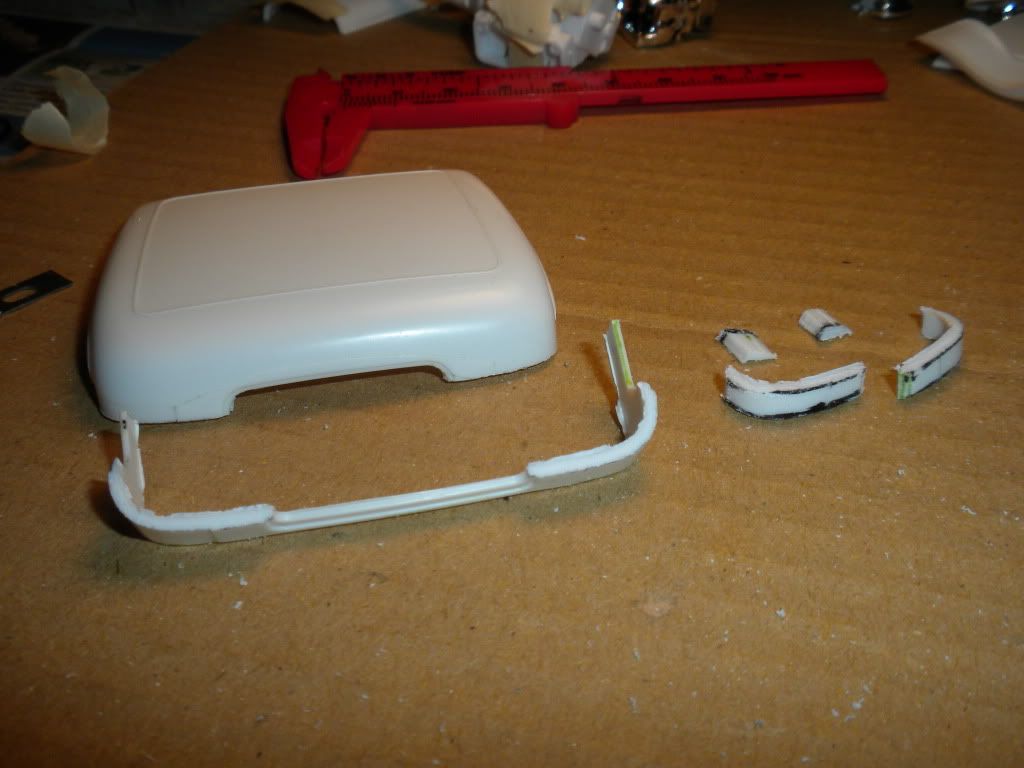

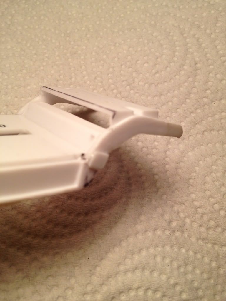

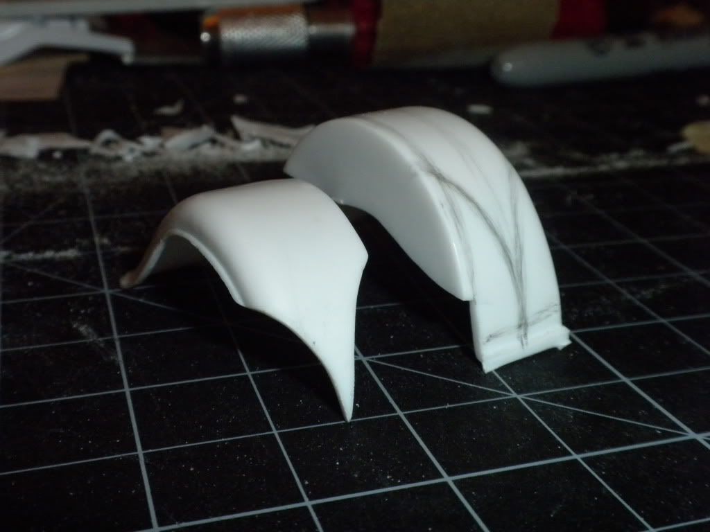

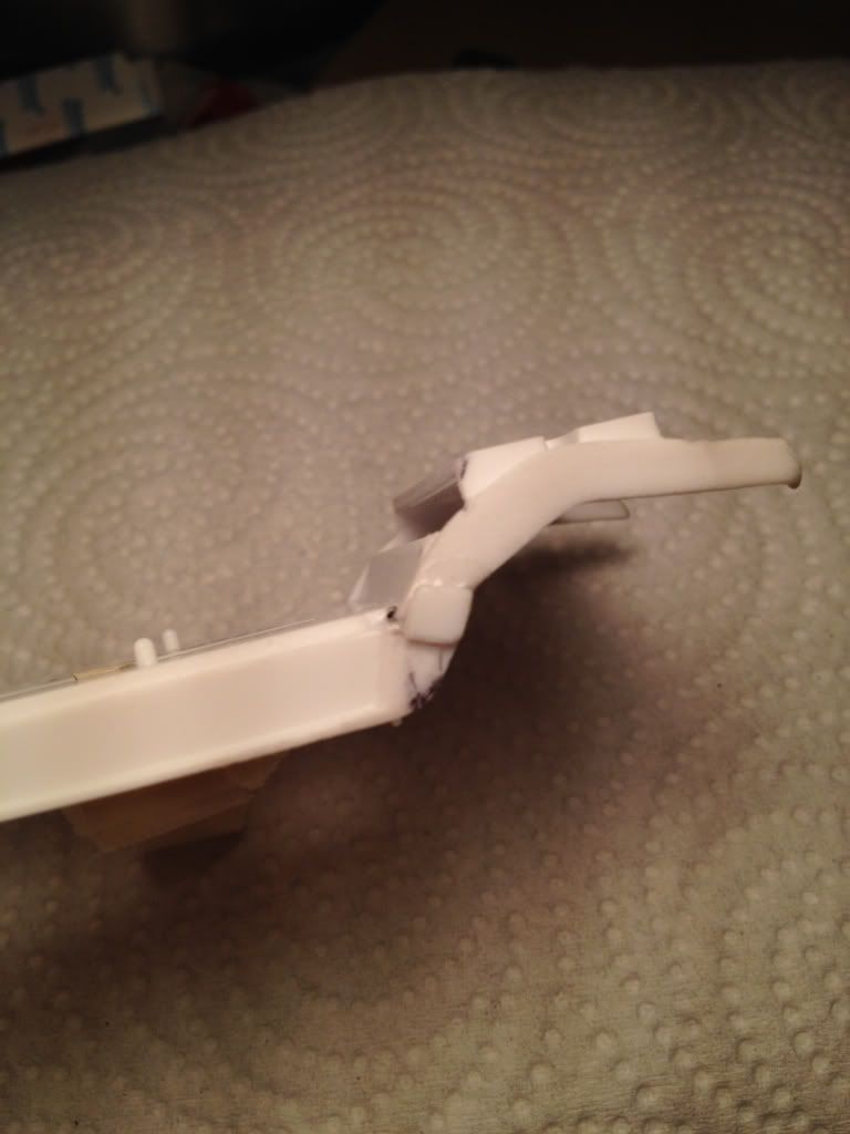

My main object is just to make everything flow but give it attitude. I decided to make this build my "first for everything build" so we're better to start then the rear fenders. I've seen this done a lot, in different ways, shapes and sizes but I wanted to make mine just a little different.

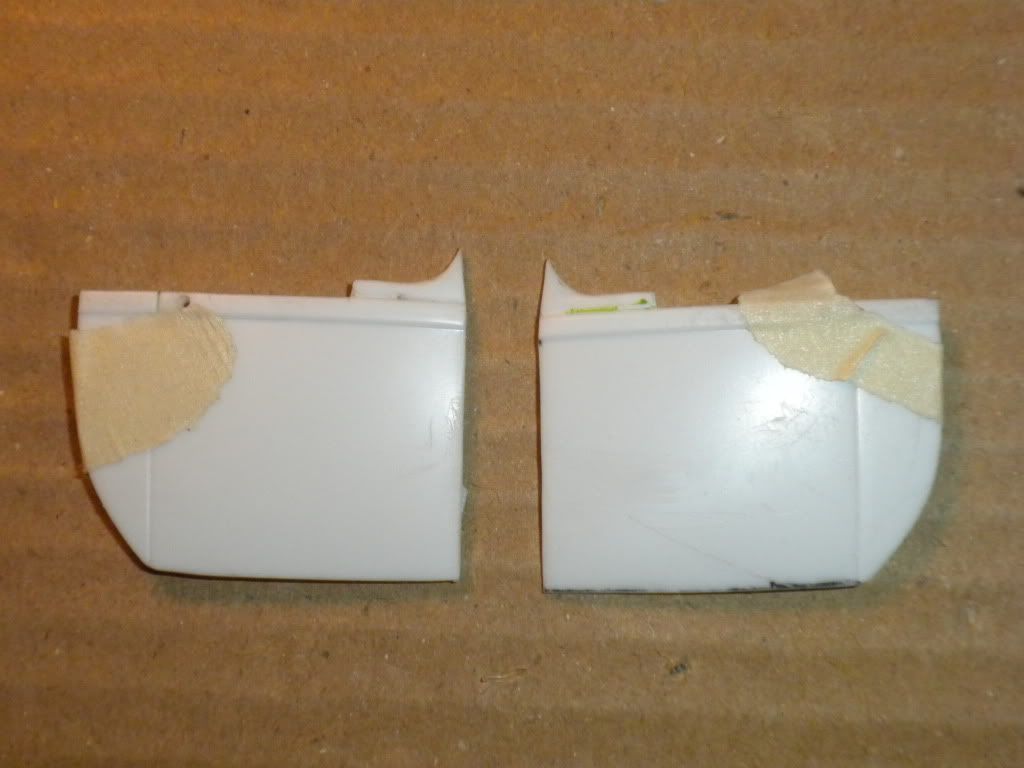

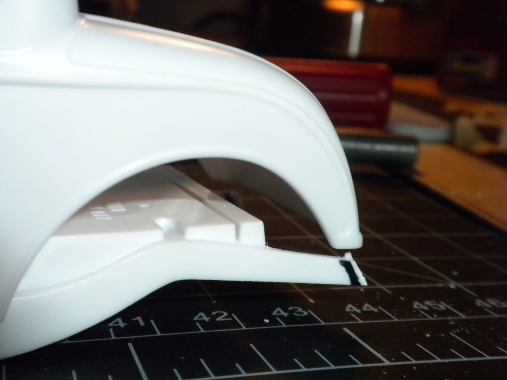

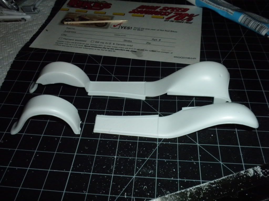

I didn't want the whole running board so I cut the back halves off.
Posted Image

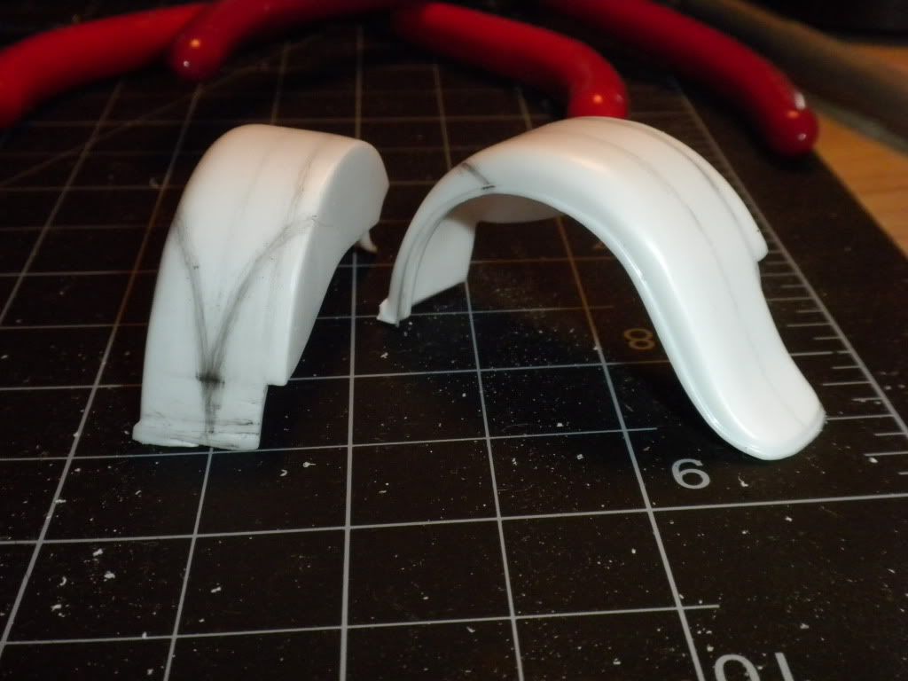

Then drew some lines and cut the fender to look like a chopper/bobber fender. I left the spike extra long until I can figure out how I want it exactly but this gave me rough idea.
Posted Image
Posted Image

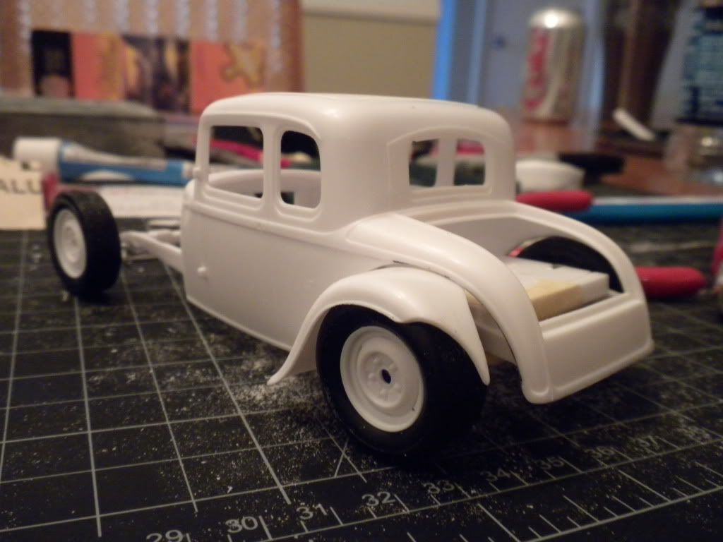

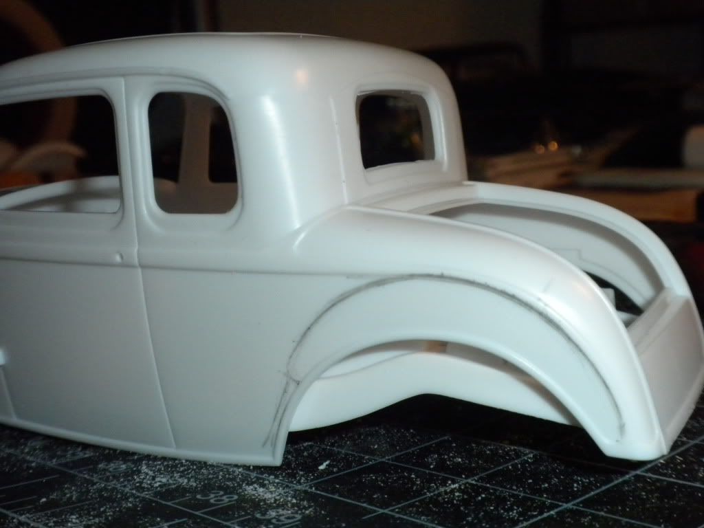

I marked the body up where where the fenders are going to sit as far as I could go without messing up the body line
Posted Image

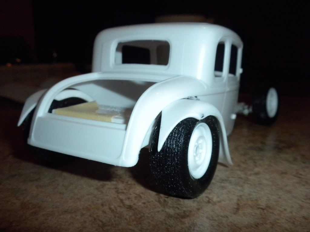

The way I mounted the fenders was I took the fender from the opposite side then flipped it so the the back part of the fender was facing forward. So if your looking at it from the side it would look like the air would flow right over the back wheel.
Posted Image
Posted Image
Posted Image

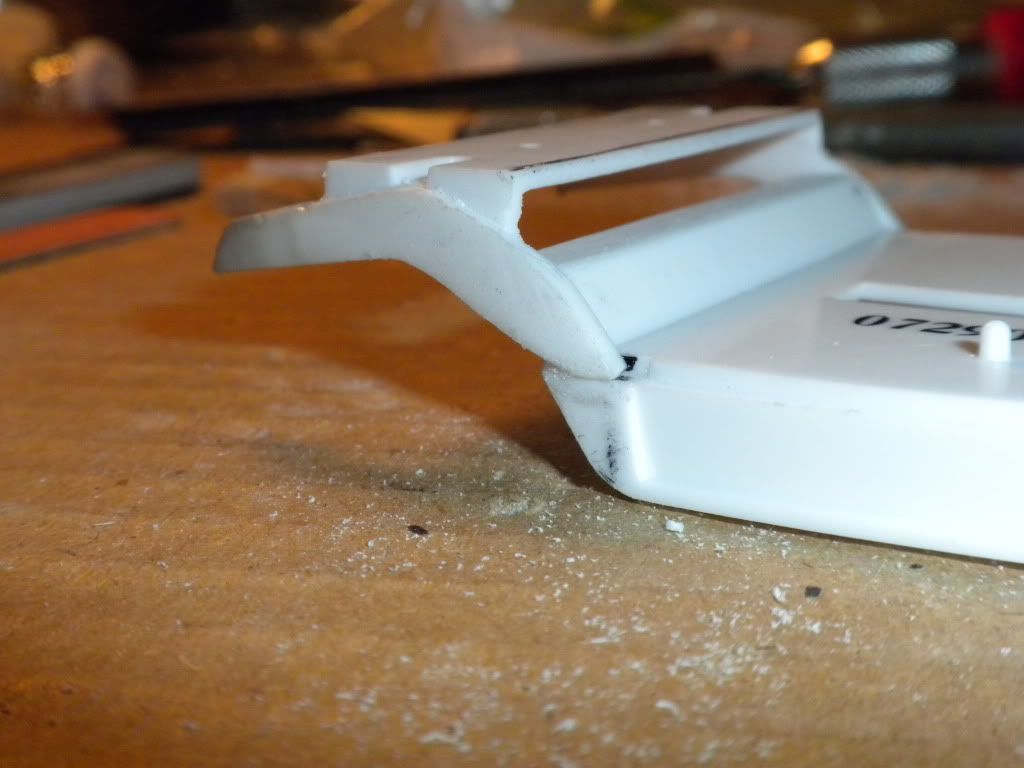

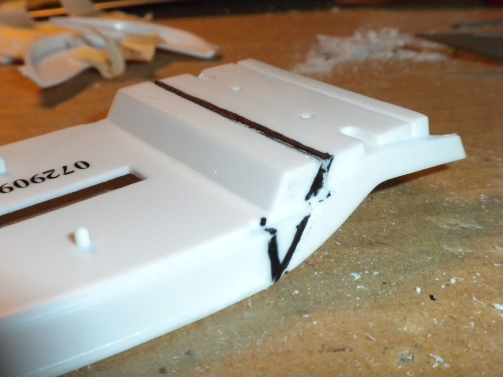

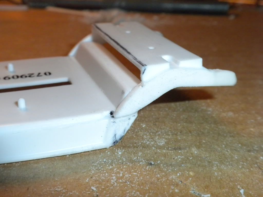

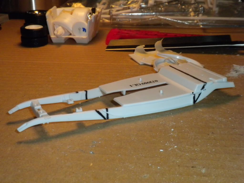

After pulling the band-aid off, I realized it wasn't so bad. So I thought I would try chopping the frame up. I found a simple way to Z the frame, I decided to just Z the rear frame for now so I can figure out the fender clearance.
Posted Image
Posted Image
Posted Image
Posted Image
Posted Image
Posted Image
Posted Image

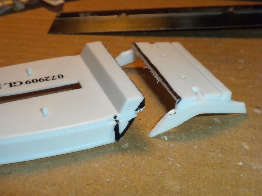

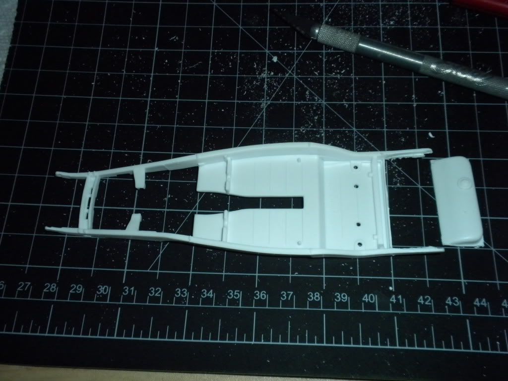

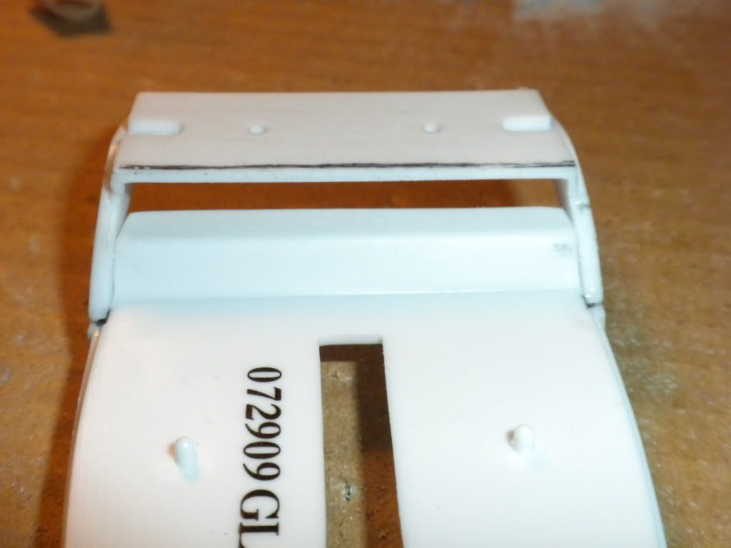

I wanted to add some strength so I added some gussets were the 2 frame pieces meet. I still have to clean up the frame
Posted Image
Posted Image
I also shortened the back of the frame and removed the gas tank in order to get it lower. I'll mount the gas tank in the trunk later
Posted Image
Posted Image

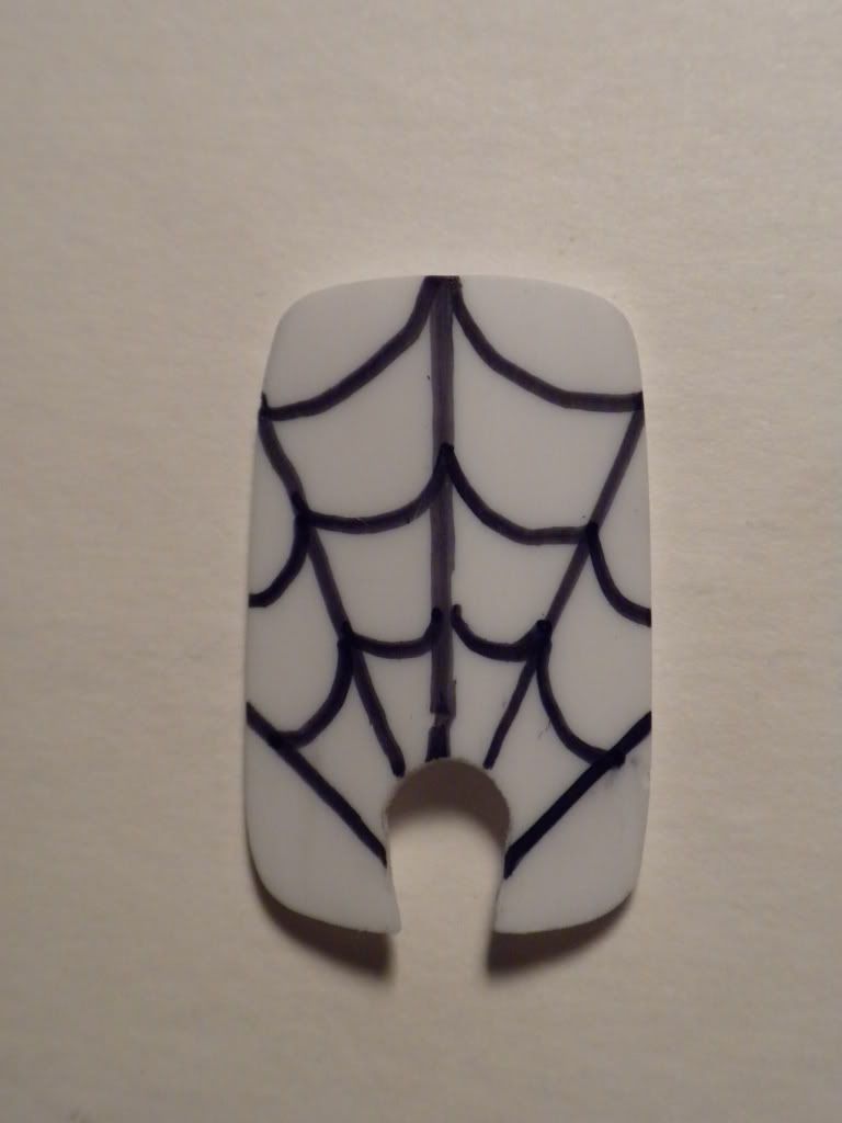

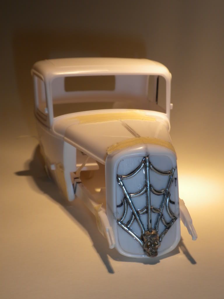

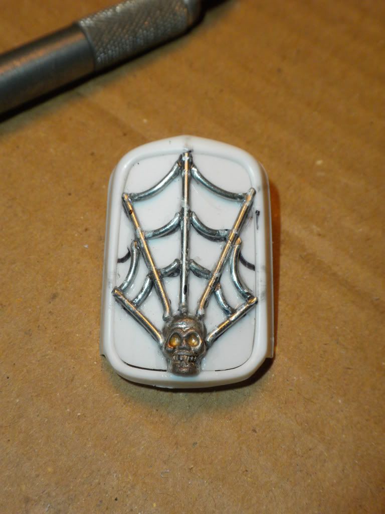

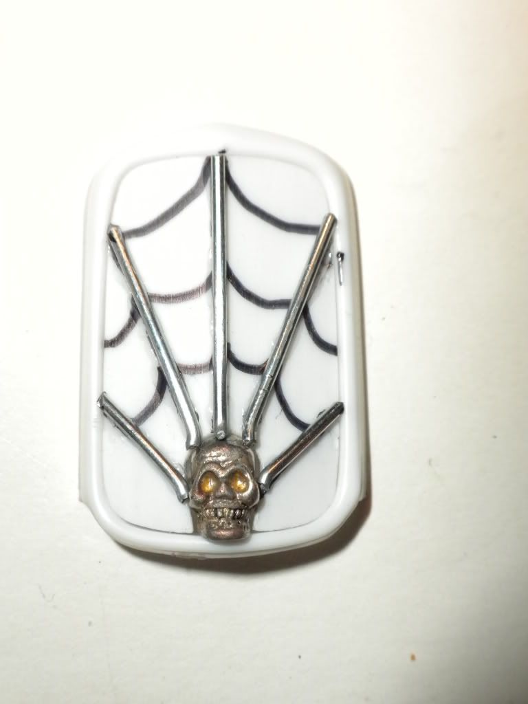

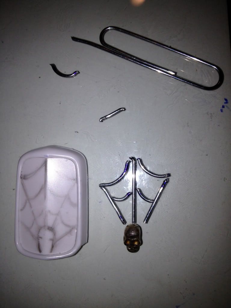

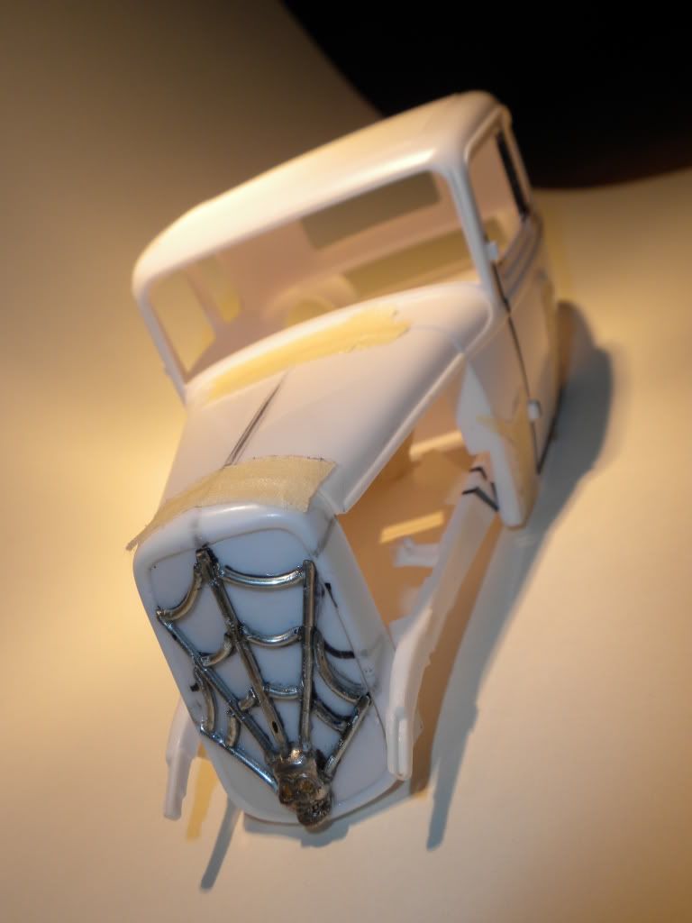

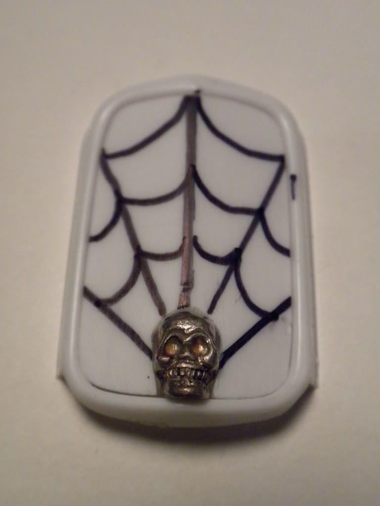

I wanted to do something different with the grill so I thought a home made web grill would be cool.  Paper clips and an old skull I had from an earring when I used to have some piercings.
Posted Image
Posted Image
Posted Image
I wanted the web to look like it was coming off the skull and I changed the direction of the web at the bottom because I'm thinking about bringing the web onto the body.
Posted Image
Posted Image
Posted Image
Posted Image
Posted Image

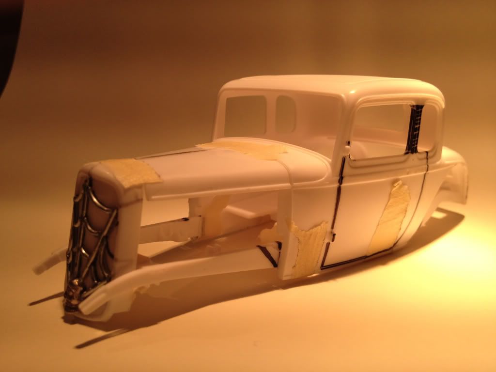

This is we're I stand as of right now. Tonight I'm chopping the top and hopefully tomorrow i can hing and cut the doors open. Opinions are always welcome.

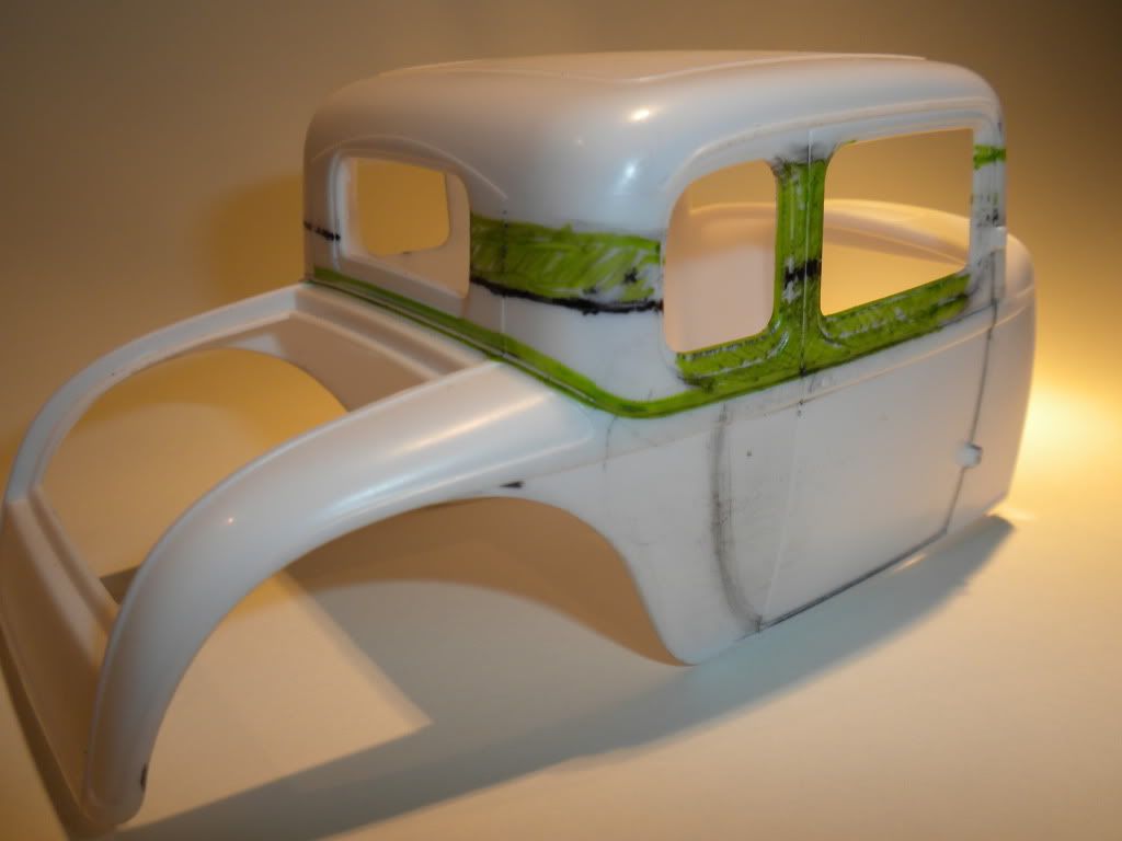

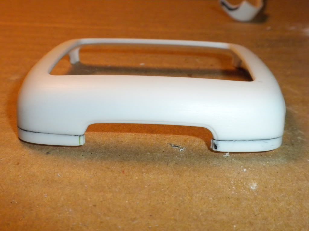

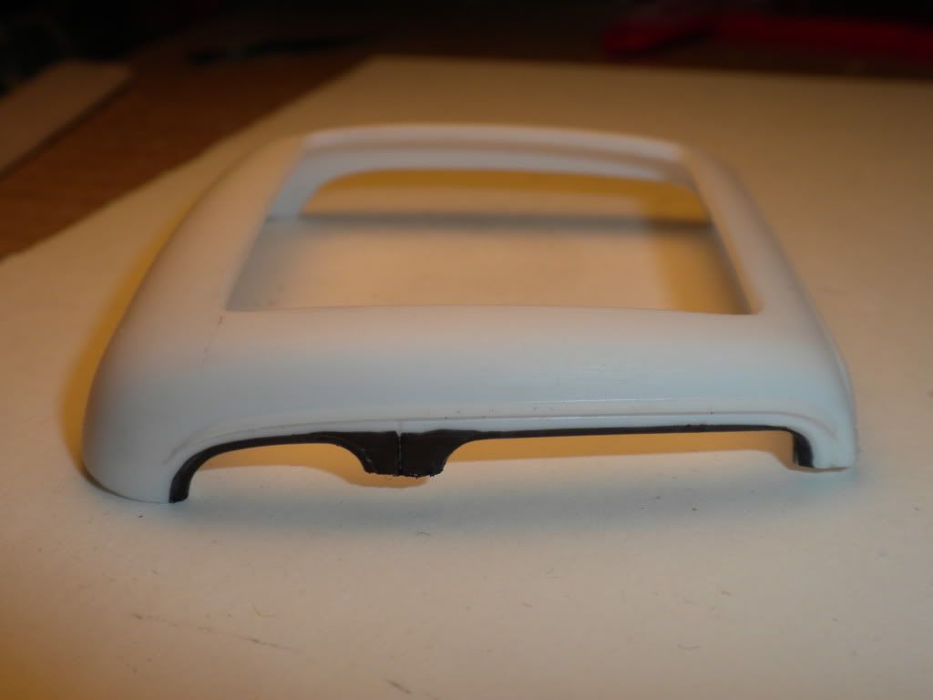

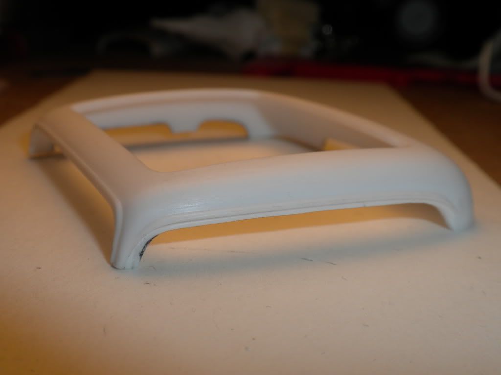

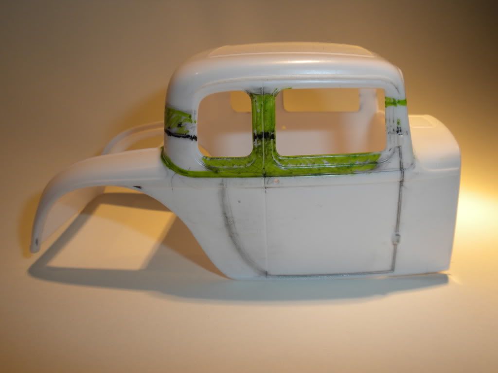

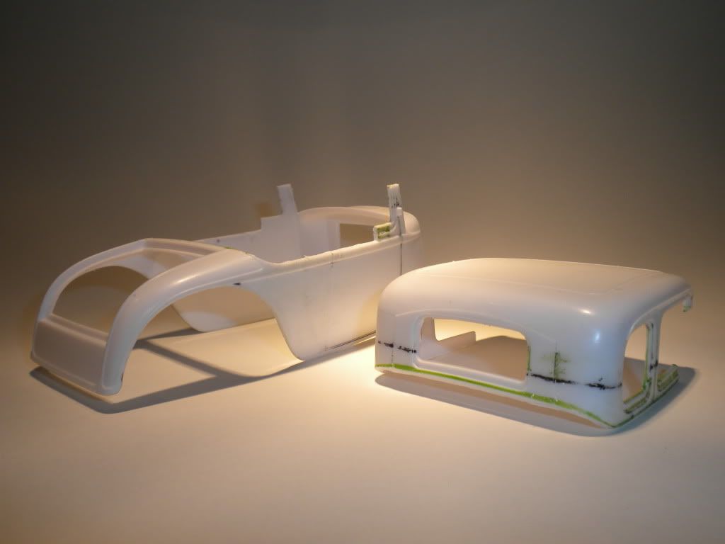

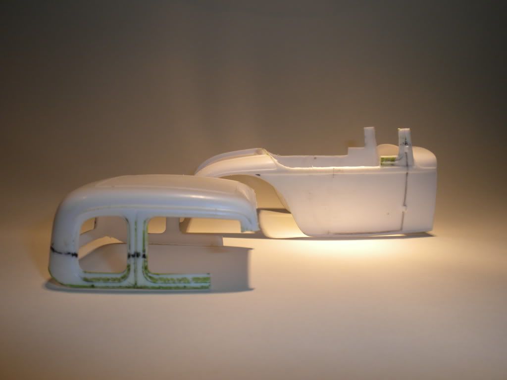

Chopping the top. I of coarse wanted a slanted chop top so my first chop wasn't going to be as easy as just chopping and dropping.  After making a post and talking to a few different members I went with the way I thought would be best to give me the slanted chop.
Thanks to Brizio and others for all the help and ideas.
http://www.modelcars...19
1st step I did was mark everything off in green that was being cut out.
Posted Image
Posted Image

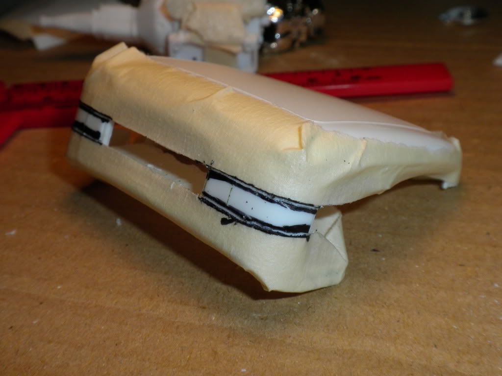

2nd step I took the back of my blade and cut the top clean off.
Posted Image
Posted Image
#19 JasonFL
JasonFL
  • 970 posts
  • Location:South Florida
  • Full Name:Jason Brackney
Posted 14 May 2012 - 01:06 PM

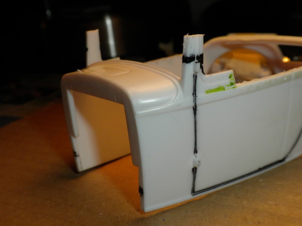

3rd step I marked off my post and chopped em' down.
Posted Image
Posted Image
Posted Image
4th step i cut the middle of the roof out, got rid of the middle post, and cleaned it up.
Posted Image
Posted Image
5th step I realized after mocking it up (forgot to take pics) that I cut to much out of the rear post so I took the pieces I cut out, shaved them down about half the size then glued them back in place.

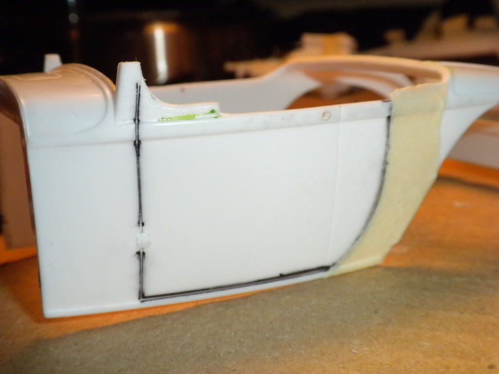

Posted 14 May 2012 - 01:07 PM

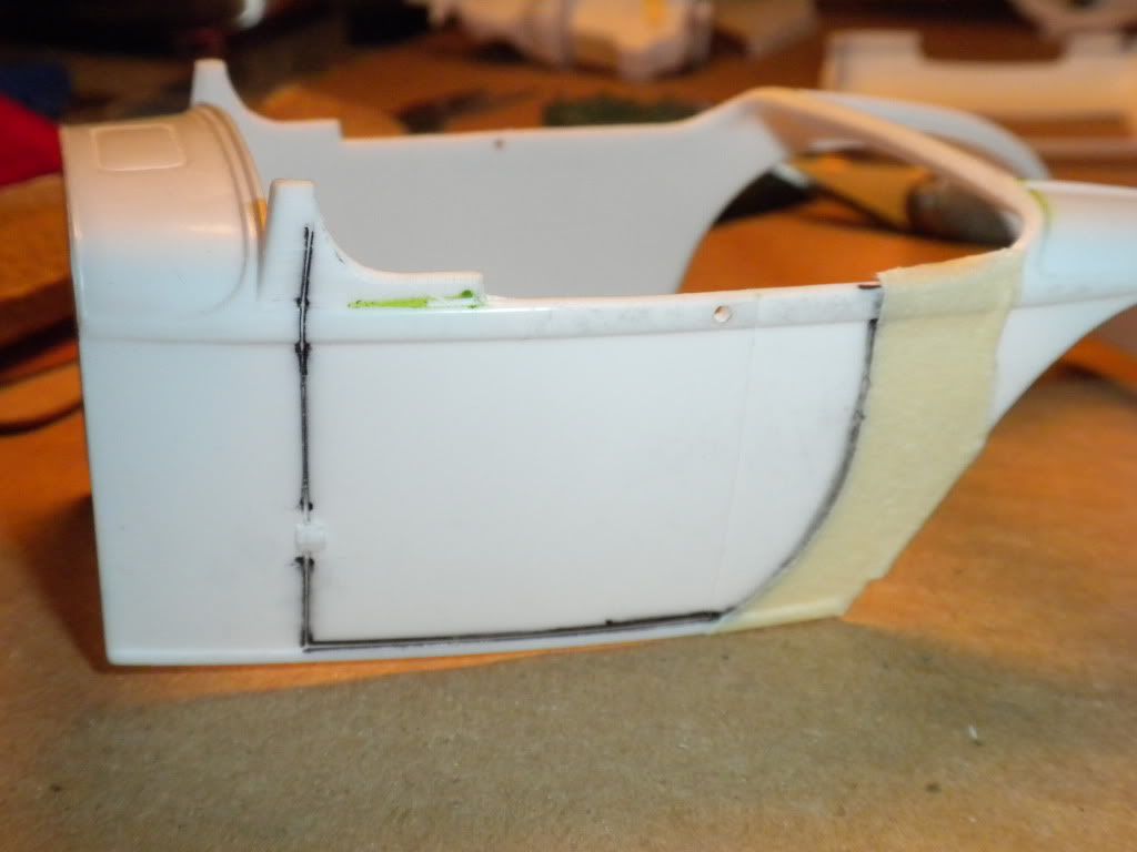

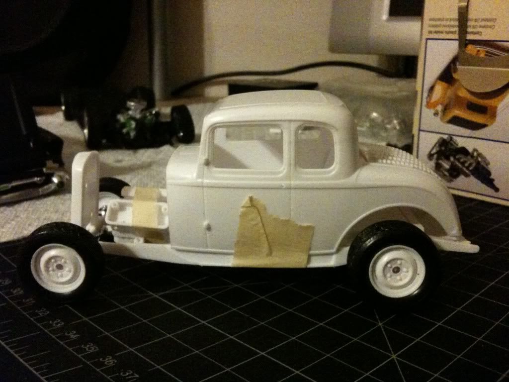

So while waiting for the pieces to dry on the top I wanted to get the doors cut out. The doors had to flow with everything else so that ment making a new door lines.
The first time cutting the doors out wouldn't be as easy as following the door line so I put some tape down as a guide, worked out pretty well I think.
Posted Image
Posted Image
Posted Image
