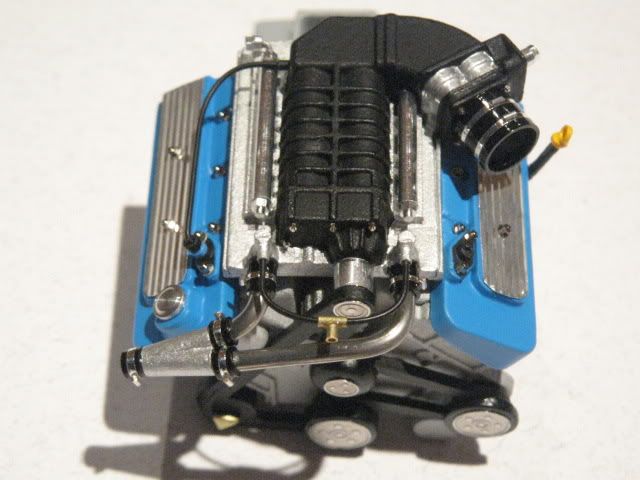

I make mine out of small diameter copper wire (painted)and just wrap it around the hose and add a tiny drop of super glue to hold it in place where it can't be seen. I bend the ends up and clip off the excess to simulate the squeeze type clamps.
Posted Image

On most of mine I've used the BMF wrap and dulled it with some clear flat. A few I've used plowboy's wire method for that type of clamp and I really like it.
I have some Model Car Garage Vintage Hose Straps that I really like the look of when I'm getting detail crazy. You can wrap then and leave the end long. Add a piece of sliver wire or a painted plastic rod at the juncture for the screw tightener if you're REALLY crazy! Those are shown below.
Posted Image
Edited by Foxer, 24 July 2011 - 01:48 PM.

Got into using thin strips of bmf myself. Then flat cut beading wire is used to make the adjusting screw which is epoxied in place.
Posted Image

The hose clamps that you see in this photo are all photoetched and came from Scale Motorsport. The screw clamps are pieces of wire with photoetched screw heads glued on the end. Now this is all 1:12 scale but I have done the same with 1:20 and 1:24 scale. Same process.
Posted Image

I used BMF for the radiator hoses & pieces of 30 ga. wire for the squeeze type on the heater hoses.
Posted Image
