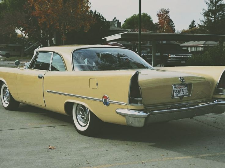

Another faux pas I remember albeit minor, is the shape of the trailing edge of the fins. On the 1:1, the top of the tailfins over the tailights should have a bent over kink on them, where as on the kit the fins are almost straight from a side profile.
No biggie as it's not that noticeable (except to us "Obsessive" types
) and shouldn't be hard at all to fix.
